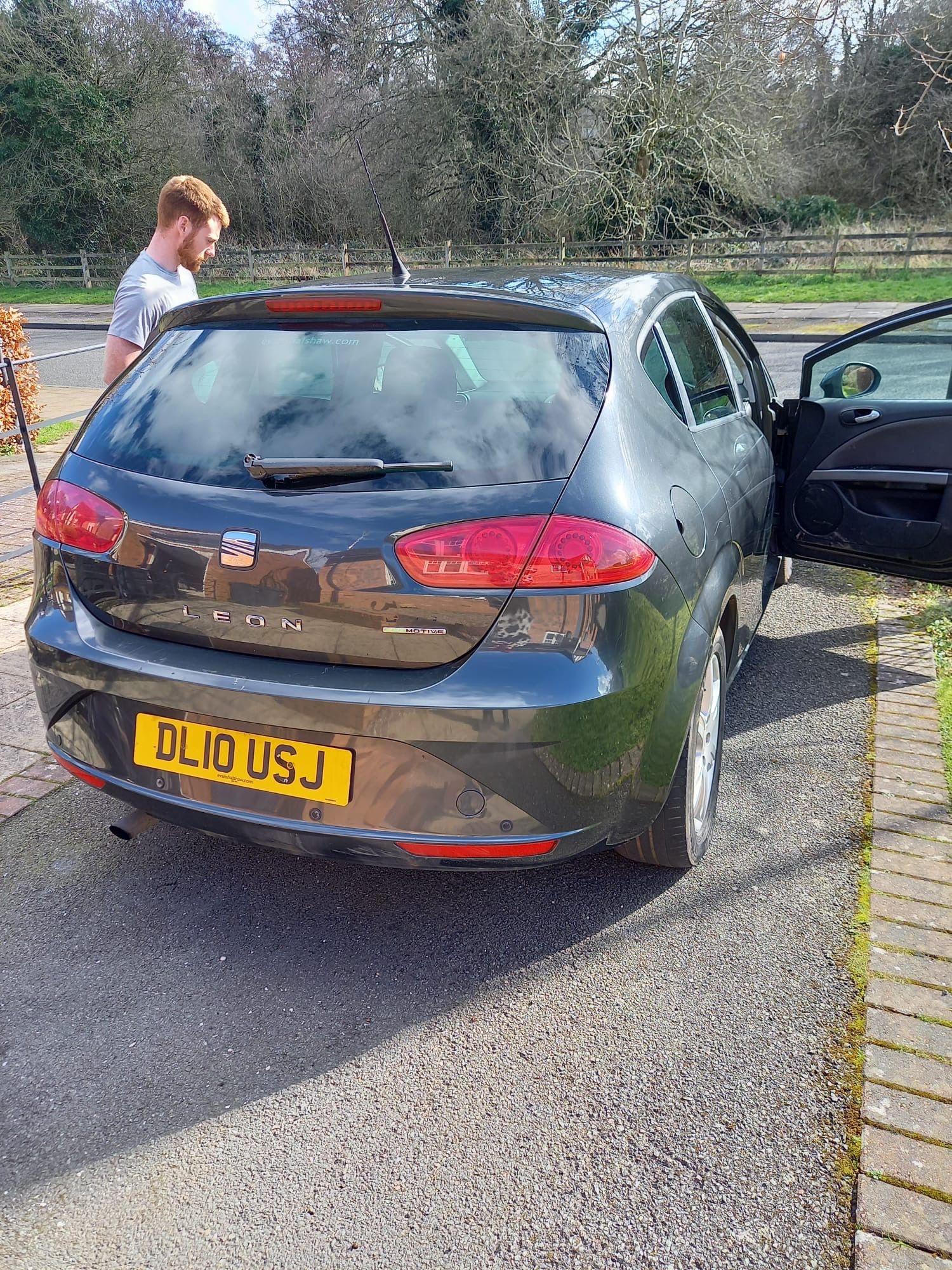

If you don't get a warning light about a parking assist system failure on the instrument cluster, it's probably an aftermarket kit and the problem can't be diagnosed with a diagnostics device you may have. Wiring, control unit, speaker/buzzer and sensors need to be checked.
