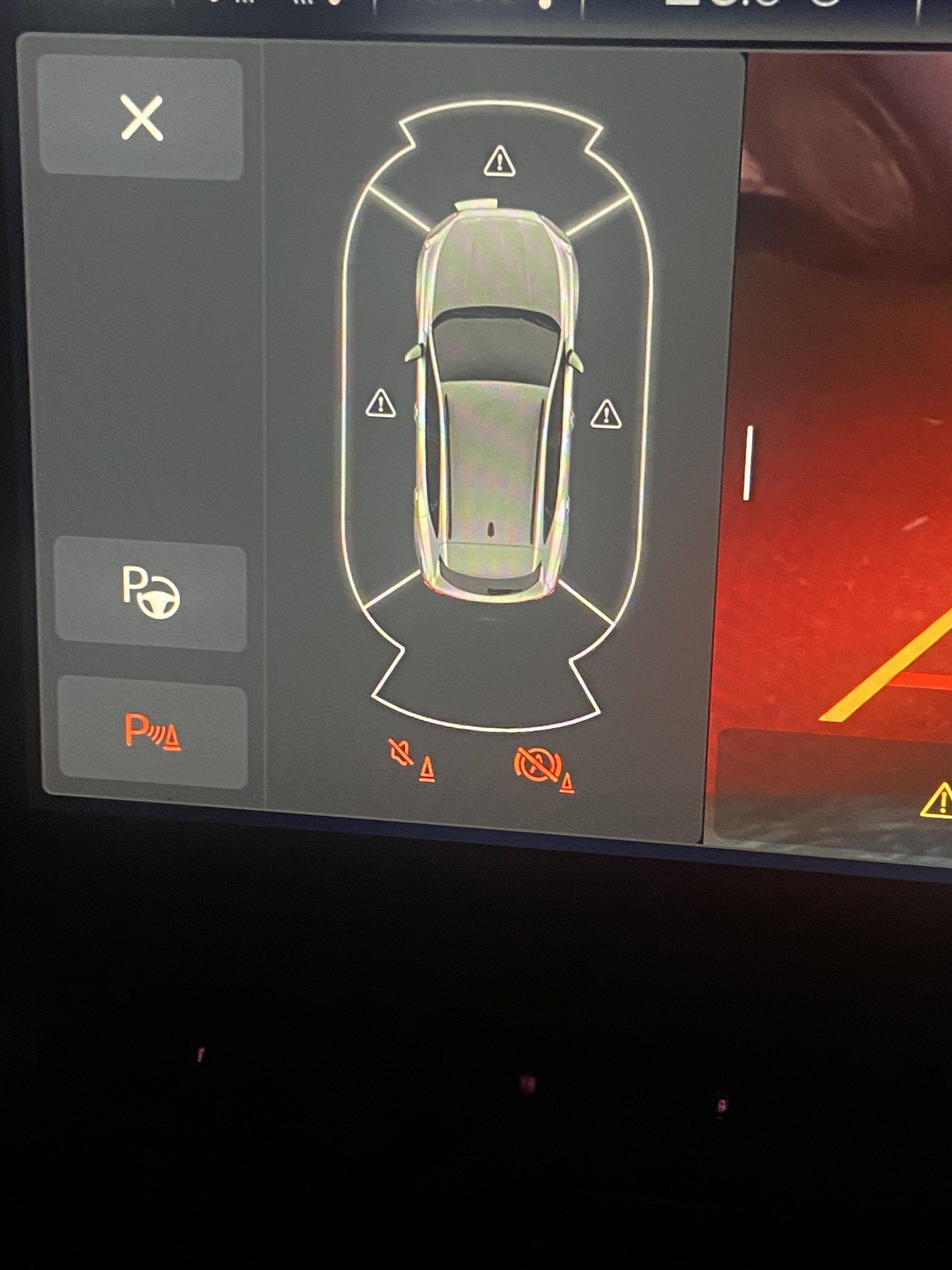

What does the PDC display on the MIB screen show when you select reverse?

Not sure if it’s suggesting the back now, or does the small white indicator on the front left of the diagram suggest that sensor?

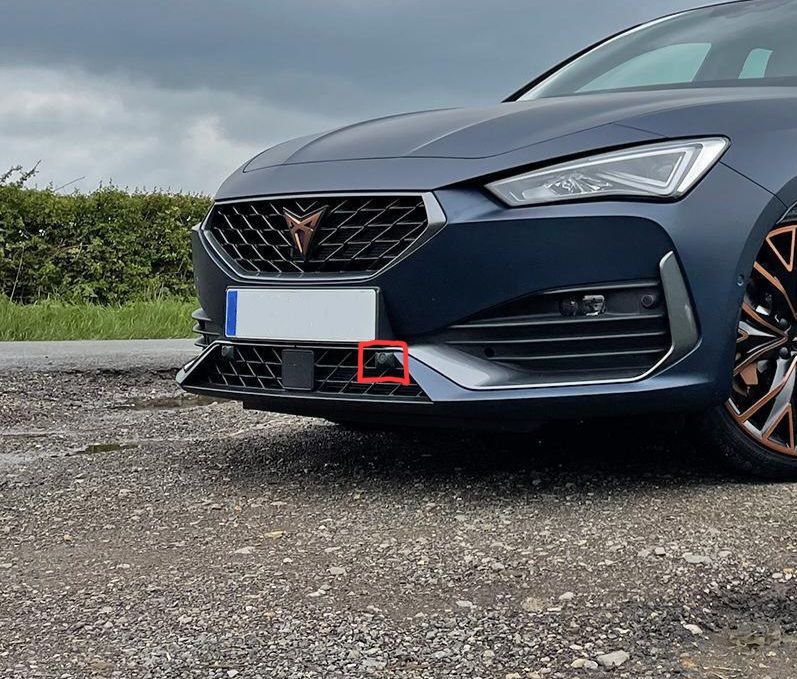

That sensor is damaged, it's black and shouldn't need painting.
N/S/F centre.
Easy to swap without bumper removal.

The rear sensors are operating correctly, the problem is with the front
Ahh ok, that would make sense tbh as we were driving into heavy rain/sleet so they’d be taking the brunt of the bad weather (motorway driving as well) pretty sure it’ll be water ingress that’s likely done the damage
N/S/F centre.

Have a look in the daylight and you'll usually see some clear damage on them.
