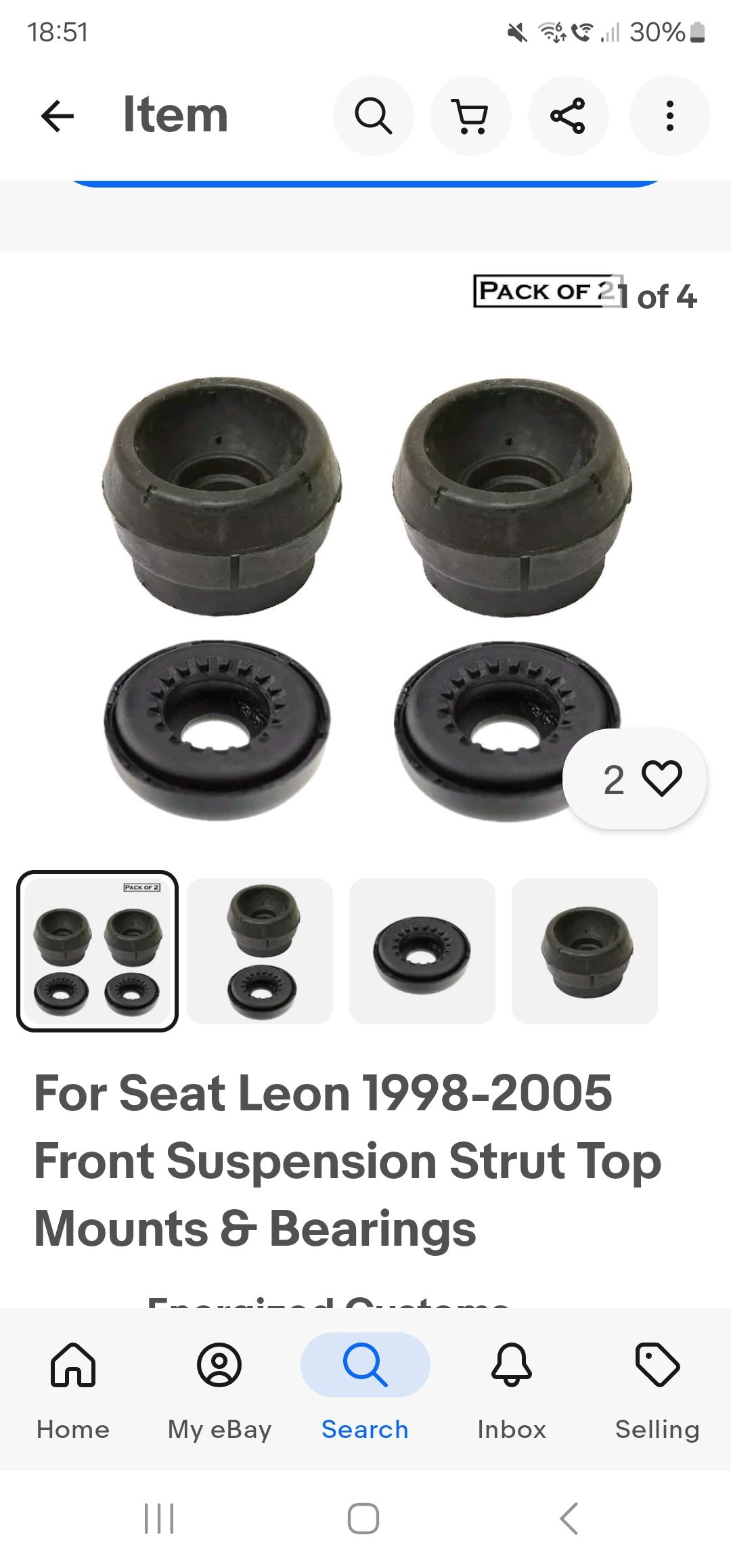

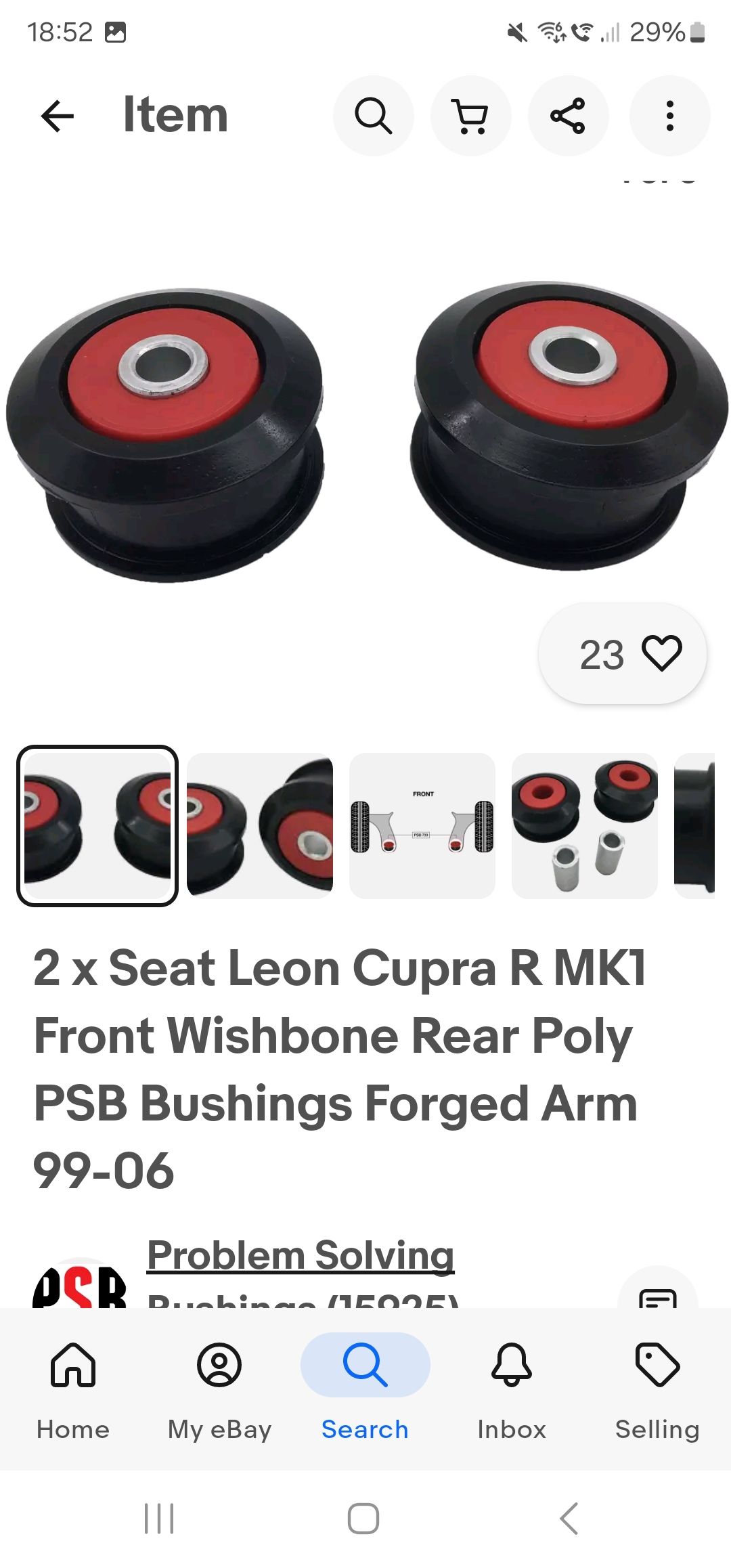

Nice one. Never really heard of fk. So you got them from damian? How much should I expect to pay for a whole set? Thanks very much for the help. At the moment I have an ina timing belt kit and gates. The difference is about £45 on eBay, I’ll be getting either from parts in motion when I do so. Is there anything else recommended to change while doing so with the timing belt? Also, when I got the tie rods done, i was advised to eventually do bushings etc. I found this kit, would it be fine? https://www.ebay.co.uk/itm/18458394...2XVnQv_R2q&var=&widget_ver=artemis&media=COPY if not any other recommendations? Also with the suspension what other items would I need to get to do as well as the shocks and springs?

Hi well fk automotive as they go by are lower value offering from kw suspension which are very good, ive had no issue with my set up made a difference never going to get perfect. I replaced all the suspension mounts with original rubber mounts as aftermarket 1s can lower car by 10mm which on these cars can be difference getting over a bump lol.
I upgraded all my wish bones to psb bushes great value and come with lifetime warranty on them. Depending on suspension you choose you may need shorter or adjustable droplinks( again damein will advise on this with what you want to achieve)

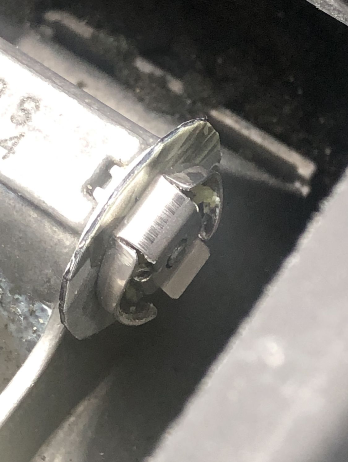

One more question- I’m replacing the gear shift knob and I wanted to ask if something like wd40 white lithium grease spray would be fine to use on the gear linkage. (I want it to feel a bit more smoother(?) on the gear changes.) if not do you have any other recommendations?
Check the condition of the bushes on the end of the gearshift cables at the gearbox end.
They can be perished as they're only soft rubber.
A linkage reset can also work wonders.

I found this tightened things up. Cut out a horseshoe shape out of a credit card and wedge it behind this clip to the right of the gearstick.
And yes, you can use white lithium grease on the mechanism under the bonnet.
