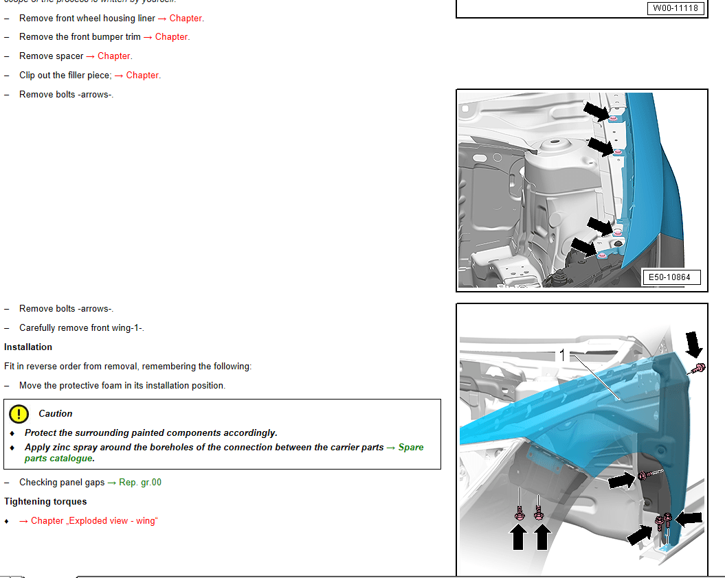

Hi - does anyone have step by step instructions on how to remove and replace front wing on a 2013 Leon? Looked through the workshop manual downloads links on here but couldn't find this. Many thanks
thanks Craig - I did find them, and downloaded from Erwin. Just think this is pretty scant and always good to hear from people who might have done this to find out if they have had any issues etc. However I'm sure I'll work it out!
