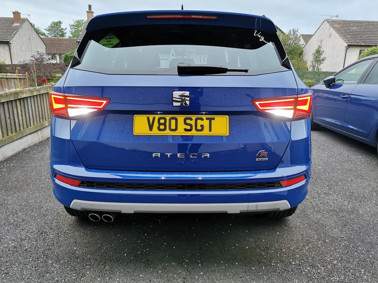

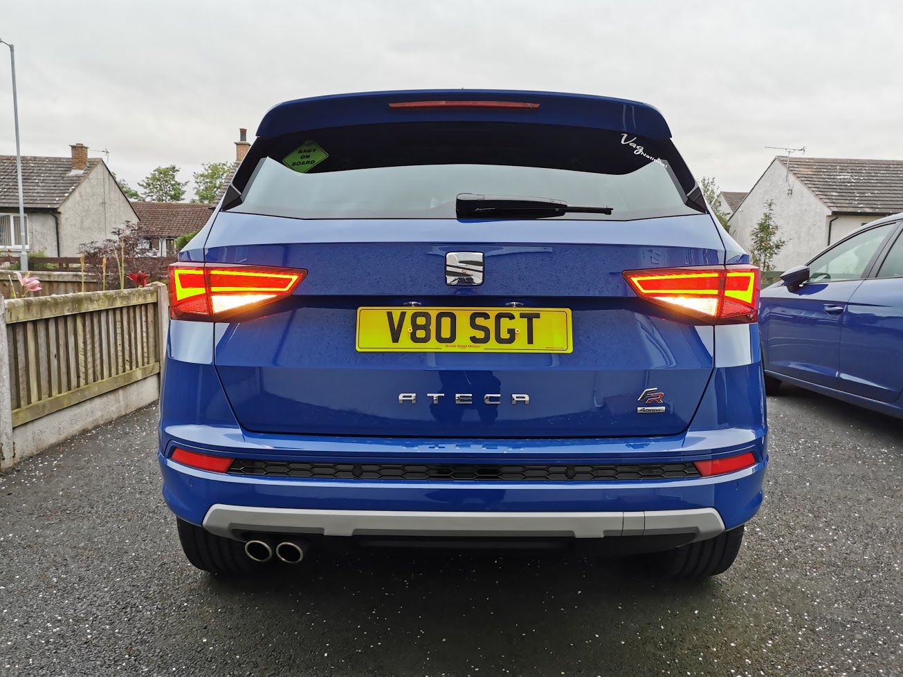

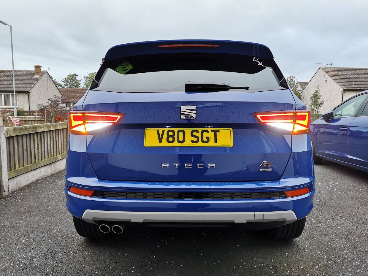

OK, had the bulbs over a week and just got them fitted. They're very bright and some of the LED's shine straight out so could improve vision. The problem I find sometimes with LEDs in general is that they;re bright to look at but the actual output is poop. LED street lamps is a fine example.
Anyway.. Pictures! this is before. I tried to get a photo that captured a true representation of what i could see.
Then After... Bulbs went in pretty easy and there are no warning lights on the dash so all good!
And with the LED indicator lights too.
