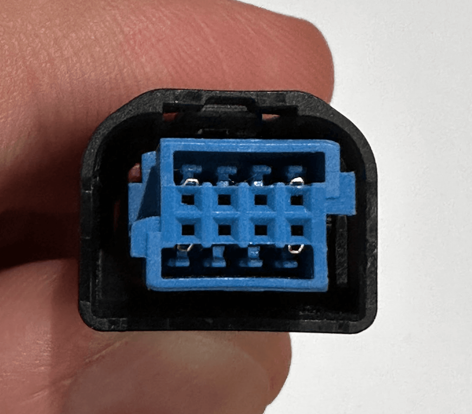

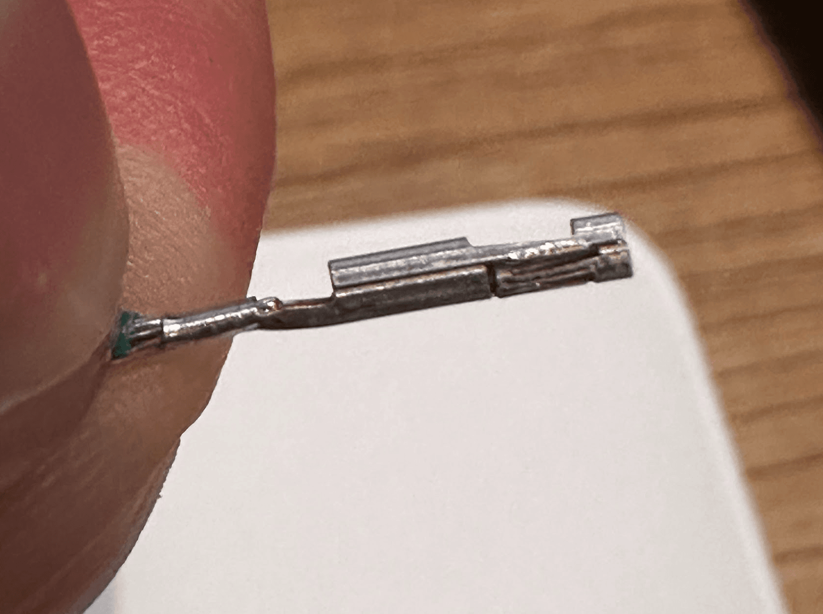

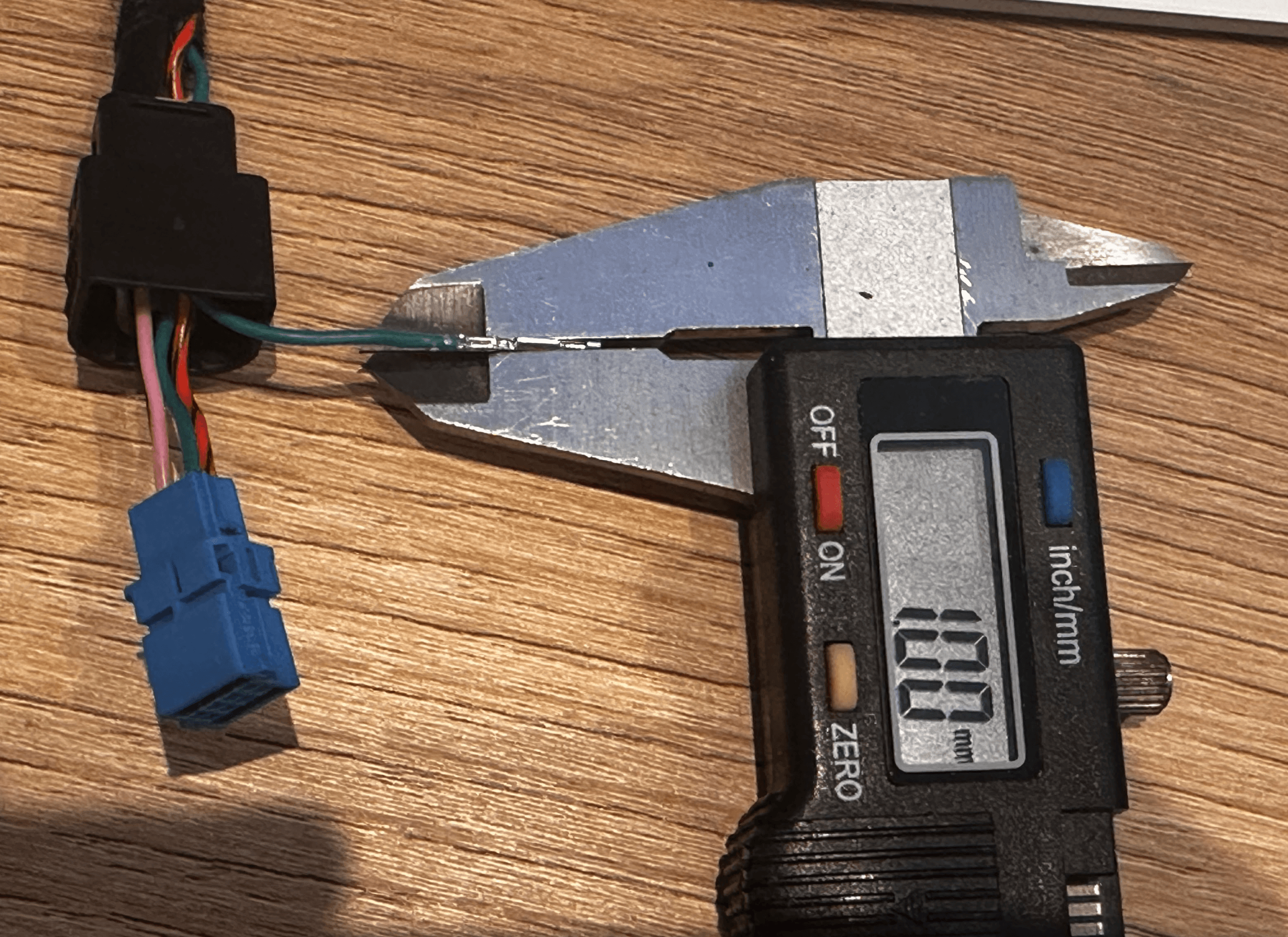

Speaking about the connectors. I found some listing of commonly used connectors already but I still didn't find part number of the one used in the 5WA973708 connectors (Used in for the reverse camera). Im attaching some picture how it does look.
Any idea where I can get them?

It looks like MQS or MCON connector (depending on which side there is that "lip" on the top)

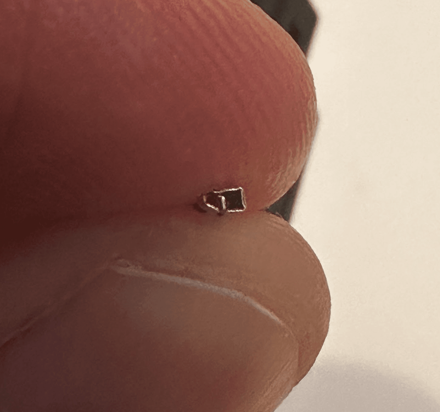

I think that those are different one. Its like half of those connectors (Width of that pin is 1 mm... Where MQS/MCON has 2mm). And it does not have a "lip on the side" but kind of "bridge" from side to side on the upper side of the pin hole. Here is a picture where it is more obvious..

It's nanoMQS. The crimping tool is expensive, I believe we paid around £1100 for ours a couple of years ago. There may be third party tools now but at the time the only option was from TE themselves
That's the one we use
Is it so different to use the original crimping tool in comparison with some 3rd party tools? Is it worth the costs?
You may be lucky with a generic open barrel crimp tool, or it may just crush the crimp and cut the wire. I use Molex connectors in my job and we have 4 different Molex crimp tools: but it is essential for us to be sure that each crimp is perfect.

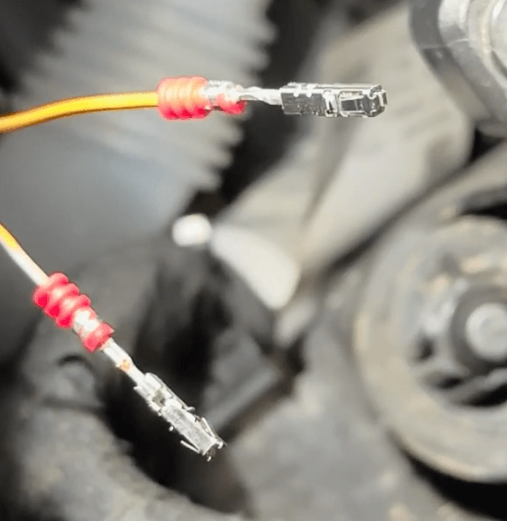

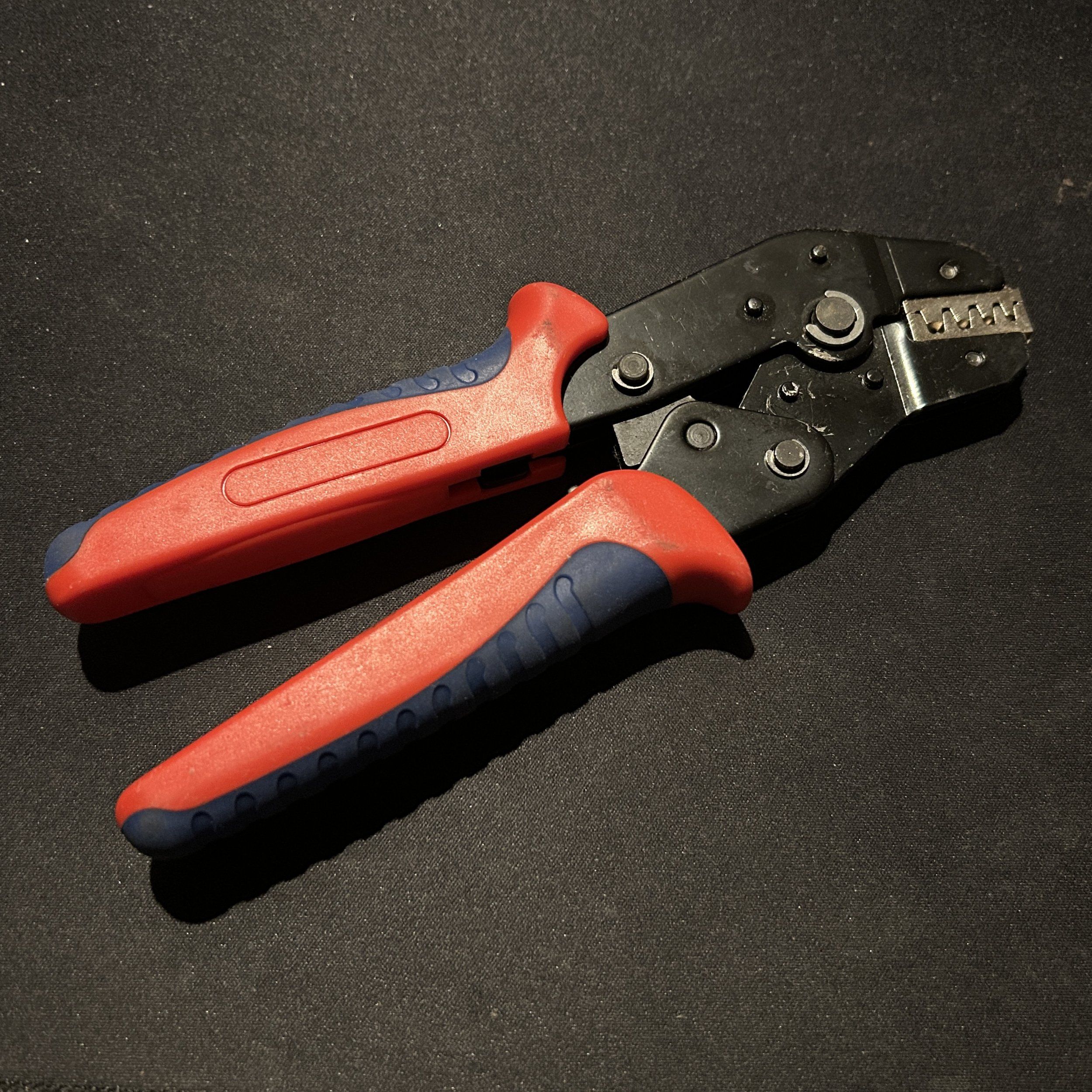

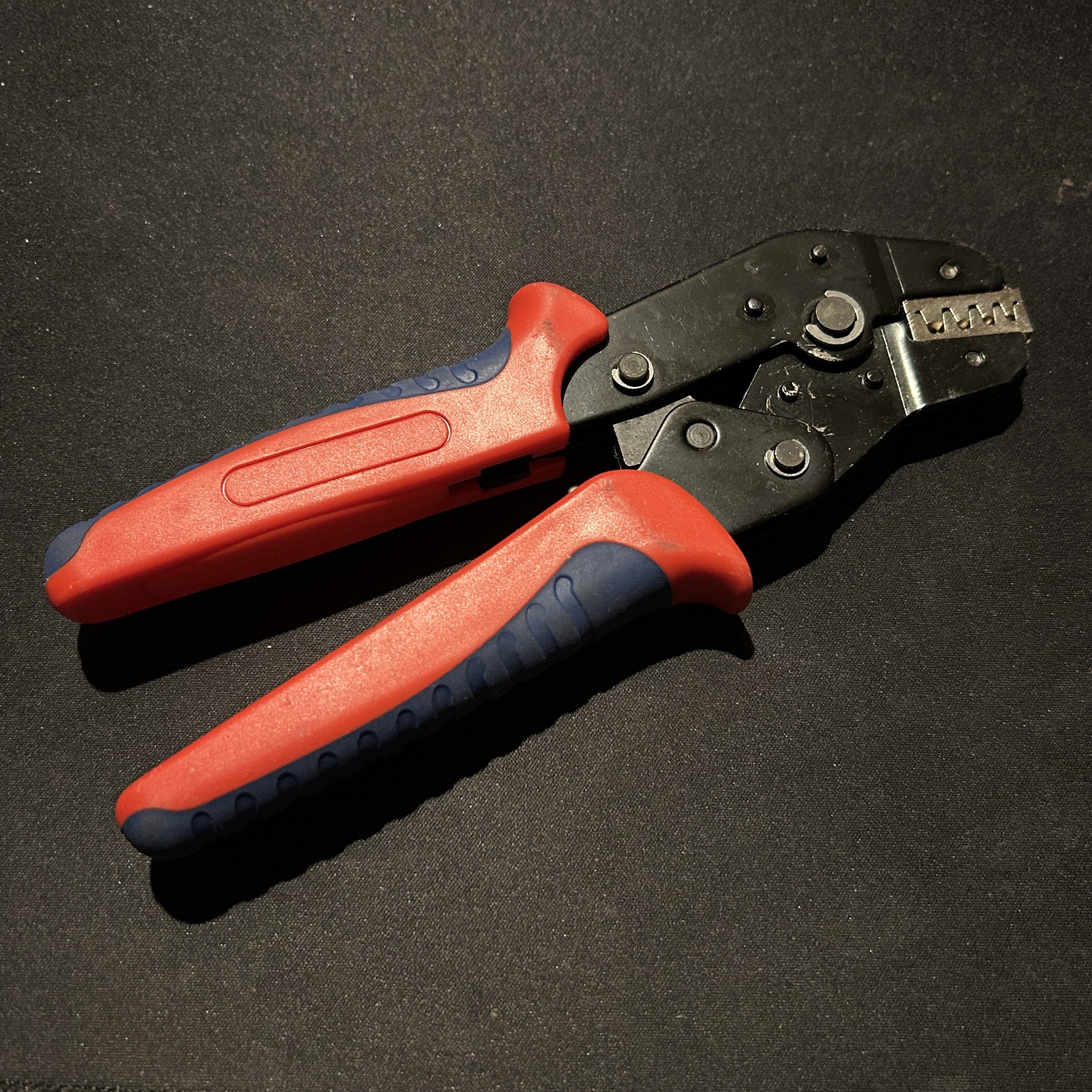

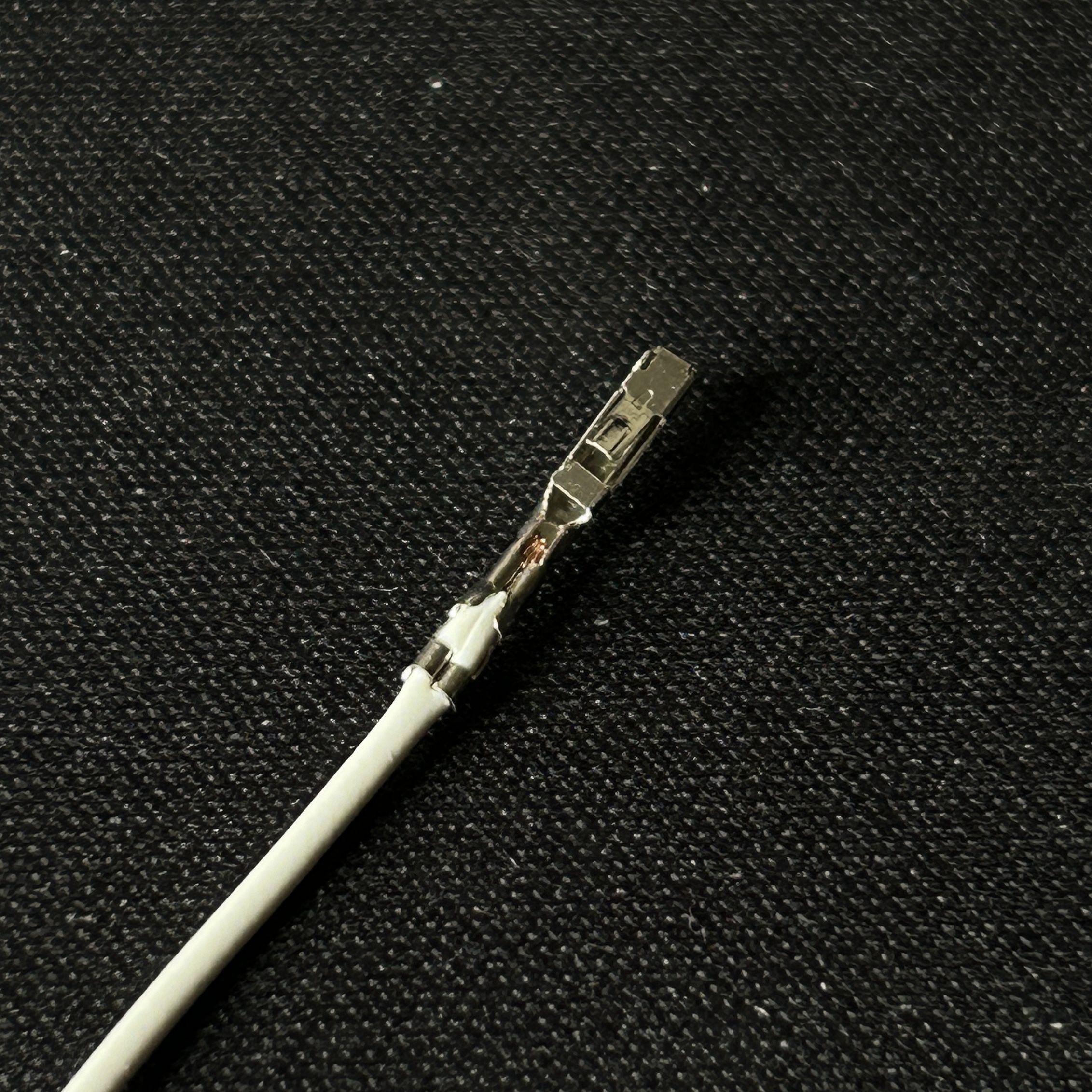

Almost year ago I have bought some cheap crimp tool from AliExpress (https://aliexpress.com/item/32859813451.html, model SN-48BSR) and I am really happy. For my "non-professional" (aka personal) usage it is far more better than pliers or any other tool. Here are image of that device and how crimped wire looks (don't judge me for the poor quality :ROFLMAO:)

Absolutely nothing wrong with using a generic crimp tool. If it gives good results there's no reason to spend 500 Euros when you only need to spend 20. And it will almost certainly give a better result than using pliers!

Looks.great for MQS, I don't think you'd get away with it for NanoMQS though

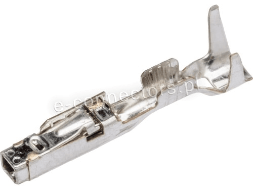

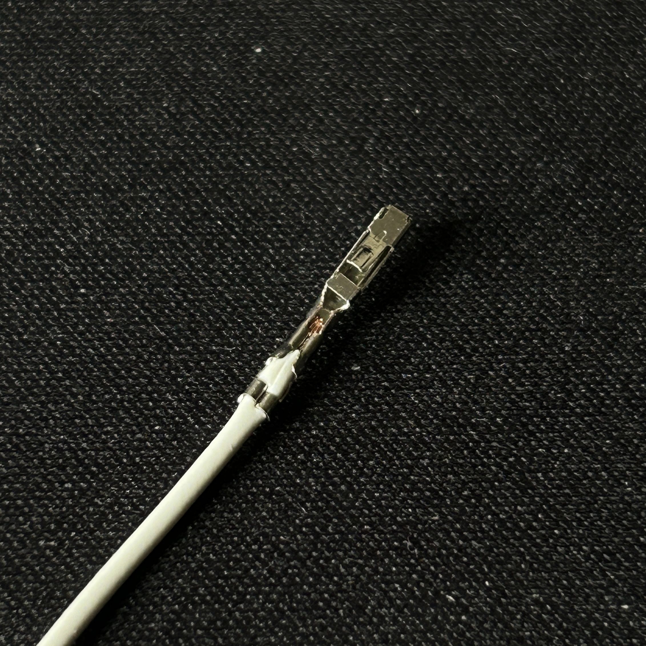

Does anyone of you guys know what is the part number of the terminal from the picture? It is supposed to be terminal for the connector 4K8973708. The dimension are: length 20mm, width 2,7mm, height 2,3mm.
