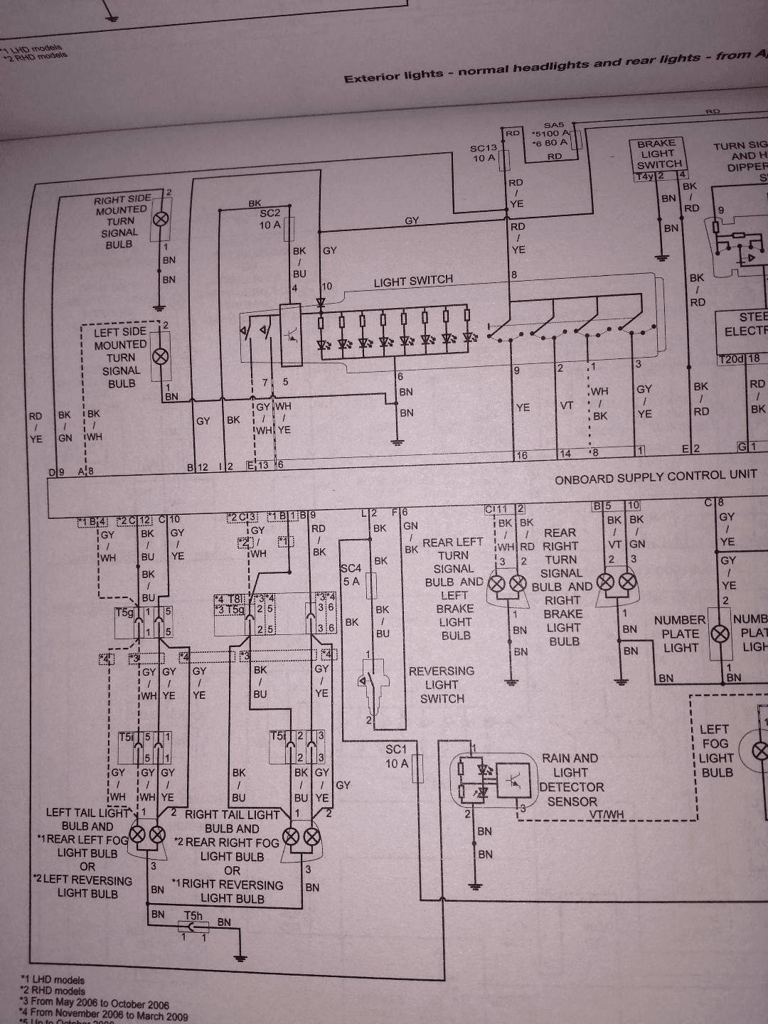

I'm now looking for what feeds the signal/relays and I'm led to believe a unit called J519, I've read a Valeo report relating to the mk2 Leon..
https://www.techtips.ie/Valeo/seat-...t-functioning-due-to-control-unit-failure.pdf
I've been searching for a wiring schematic for the J519 but have struggled so far. to give me an idea of what colour wire to look for ideally to remove the connector and check it's getting the signal from the gearbox switch, and that it isn't a wiring fault in the engine bay.
Any help or pointers would be great, I've read that you can use VCDS to turn the rear lights on which I will try when I finish nights
Cheers
