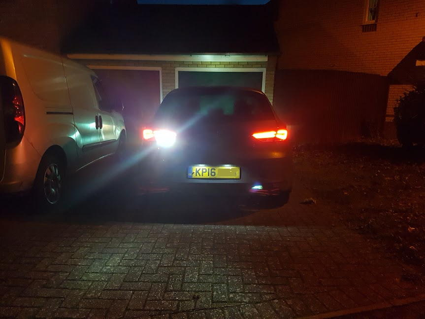

Hi, I know I have seen a thread on this before, but can someone point me in the direction of improving my rear reverse light as the standard one is crap, and barely lights the back up!! I need to see where i'm reversing. Also, can you direct me on how to change it please. A link to an ebay or amazon shop would be great. Thanks a lot guys.
The car is a mk3 2015 Leon FR 150
I bought this
How much brighter is it? Looks good. No welding and ten seconds to instal...
If you pull the lights out at the right angle they come out ok. If you don't, you might break them.
It is brighter, I couldn't say how many nits exactly...but I can see a bit more when I'm reversing anyway!
My left hand light came out easy because whoever has had it out before has somehow snapped the metal screws so half are stuck in the body...thanks previous owner!

Thanks for all replies. Wow Steve, that looks super bright!! Steve, is there any chance of a "how to guide" ? Is it tricky to DIY?
In principle it's an easy swap over, but you have to be careful as the bulb holder cluster doesn't come out easy and feels a bit fragile to me. You've got to make sure you release the two clips and pull the cluster out evenly. If you pull one side more than the other, it will get stuck. When putting the cluster back in, there's two spigots/pins that you need to line up, and again push in evenly.
