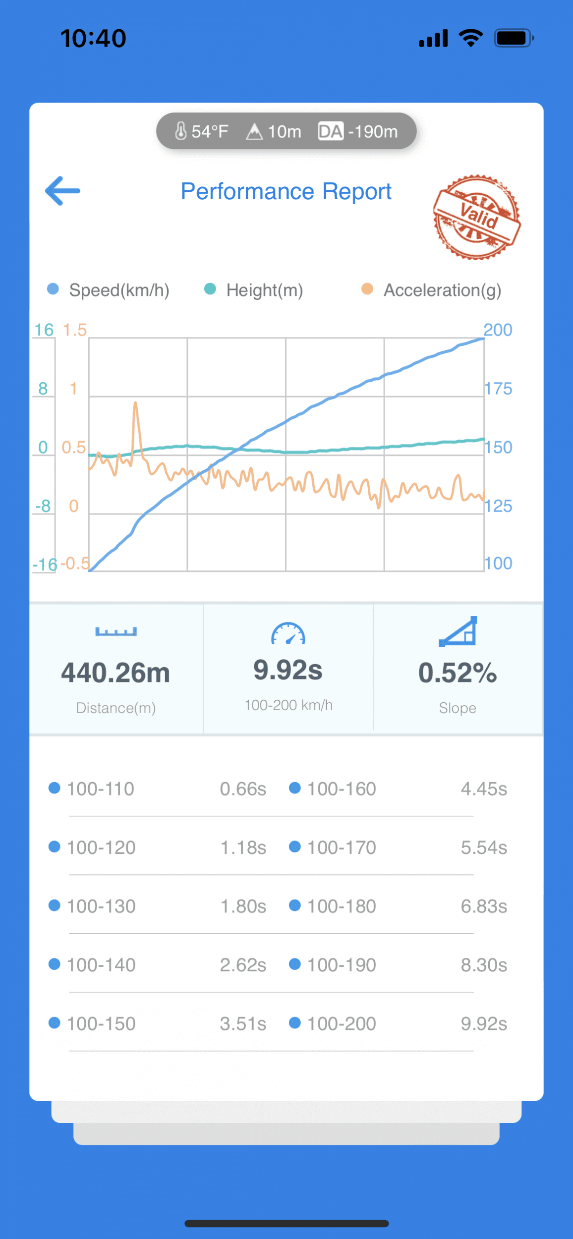

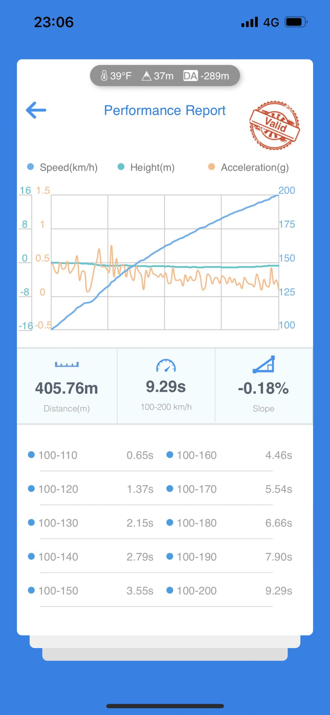

The attached are 100-200 runs when the car was completely stock and had 97ron fuel and stage 1 with the revo carbon services air intake on 99 Ron. I haven’t managed to get up the airfield in the dry with stage 2 on yet but I’ll put that 100-200 time up when I do. I have the FWD 290 Lux so I do have the 0-60 times but to be honest there’s a couple of tens between the two as it really struggled to put the power down, (when I had stage 1 there were no other handling upgrades like suspension or tyres).I’m yet to properly push the car since being stage 2 and probably won’t get it on track till early next year. But from my first 100 miles with it, you certinaly notice the extra mid range torque. As expected if you just try and mash your foot to the floor in first or second don’t expect much forward momentum to occur ?. Strange as it sounds it’s actually nicer to drive normally than stage 1, the TCU software makes the gear changes smoother and faster even in everyday commuting. I had the APR TCU software on my R ST and that felt like it was banging it into gear every time in comparison. Once I’ve had the dyno done and got some dragy times in I’ll put a proper stage 2 review up, but so far very happy with it. And a noticeable difference over stage 1, espically with the smooth TCU software

So this was on a very cold wet greasey runway with the car spinning in third, I would guess it’s got at least another 0.5-0.75 better time in it when there’s actually some traction but if you look at all the 120-200 times that’s probably a better comparison as it had pretty much stopped spinning by 120.
Again when it’s dry and not raining I’ll get a fair test done. should hopefully be going on the dyno on Wednesday ??

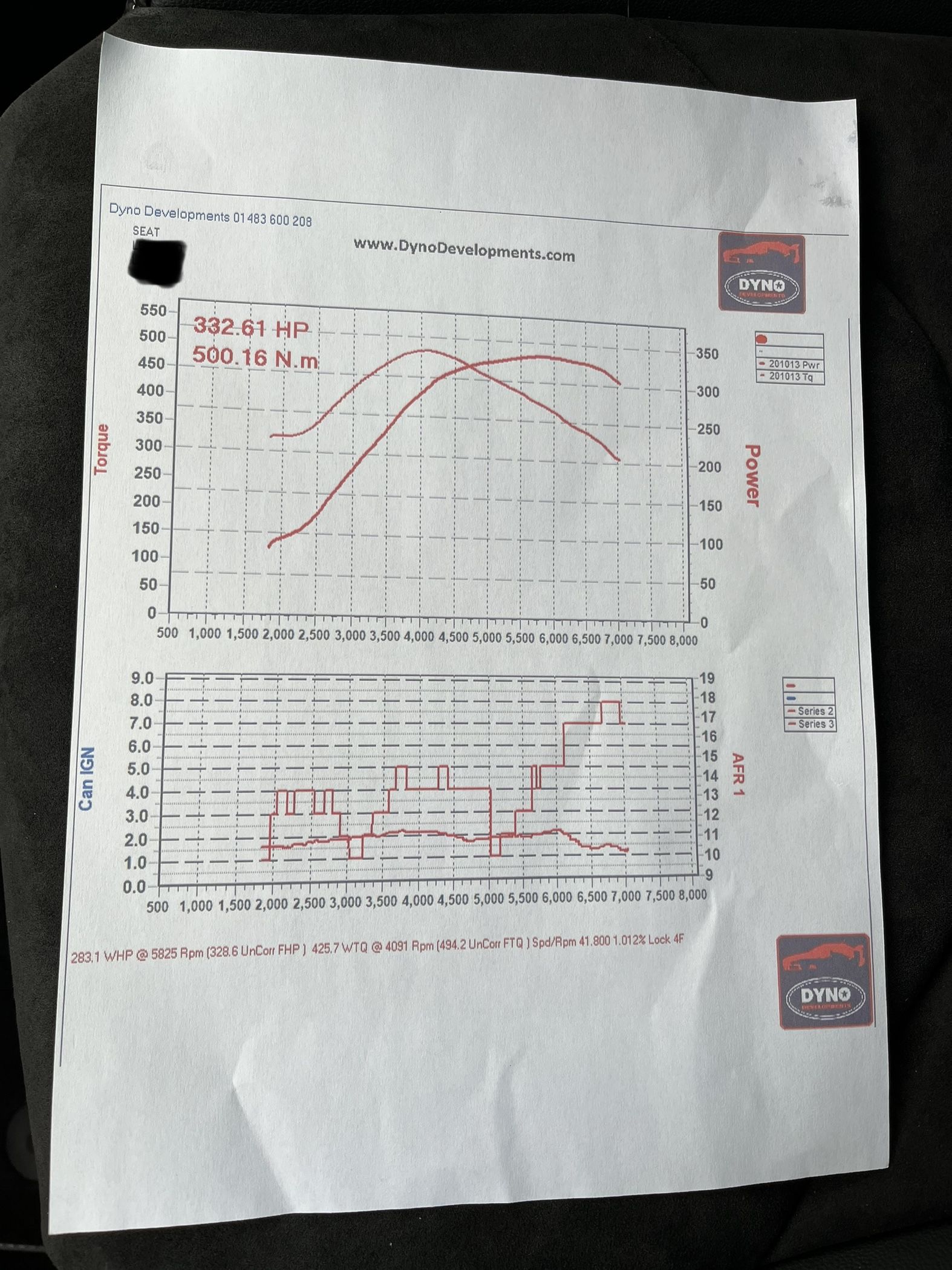

Had the car dynoed today, to say I’m a little disappointed is an understatement. And from the looks of it, pulling timing all over the place.
The car has only even been run on 99 Ron since mapped, nothing wrong with the car, no error messages ect. The dyno cell wasn’t hot and they tried different tensions on the straps to see if it made a difference, it didn’t. It was dynoed at dyno developments, they make dynos there.
The bloke was very helpful and tried several runs for about an hour to get a better result but that was the best of the day.
The place I got all the work done have been very helpful but REVO want to do some tests. I know dyno results aren’t everything and can vary massively but being 40-70bhp down over quoted is a bit low for me, espically as it’s lower than what they quote for the bottom end of stage 1!.
the car does fell quicker to drive than stage 1 but the torque is around the 500nm so it could just be that?

Hmmm very strange results this.
Hope you can get this sorted out at Revo HQ.
500nm Is the stage 1 cap isn’t it ?

I hope so too, and yeh it is. I had the REVO TSU tune too ?‍♂️. I mean it doesn’t feel slow and it is quicker in the limited tests I’ve been able to do. Hopefully I’ll have an update by the end of the week
I’m sure someone on here had a similar issue after either a Revo or Racingline remap in their Cupra, not dynoing properly or giving the expected figures (on a dyno day)
They took the car to HQ of the tuners and they sorted it right out.
It was something to do with the the ECU being a slightly different revision of I recall.

Well I’ve just been advised that the data logging was fine and to try two other dynos? And compare the three? Obviously at my expense. In fairness to the garage that fitted it all there’s not much they can do but going to call REVO direct again tomorrow. And see what they say
Bit of a fob off by revo in my opinion. They can see the figure for horsepower is way down. But in their defence, if you had base run for stock and stage 1 you could eliminate it being a hardware fault then it must be software related.
There’s only the intercooler and pipes that have been added since stage 1, it wasn’t over heating and no error messages and no issues when driving.
I mean it does feel quicker and certainly you can feel a lot more mid range torque and the gearbox software is much better, it just doesn’t have as much BHP or torque as they say it should do. The car at stage 1 was doing sub 10 seconds on the 100-200 on a dry day with good track surface which for a GPF car is ok so I don’t think it’s because I’ve got a weak engine or anything.

So slight update, been on two other dynos now and results are a bit better. Second dyno (2 wheel dyno) 330bhp peak but 570nm, and third dyno also 2 wheel dyno 342bhp with 568nm.
I’ve been up the runway a few times in the dry and best I can manage 100-200 in is 9.29, still with a tiny bit of wheel spin in third but I honestly don’t think it would make under 9 seconds even in ideal conditions. Car is on the 99ron file and only ever has esso 99+ in it or vpower. it’s lowered by 20mm with revo wheels and PS4s all round.
REVO have data logged the car and are happy with the data, just been told all dynos are different and numbers arnt everything.
Real world driving it’s within the times of what it should be 100-200 ect.
