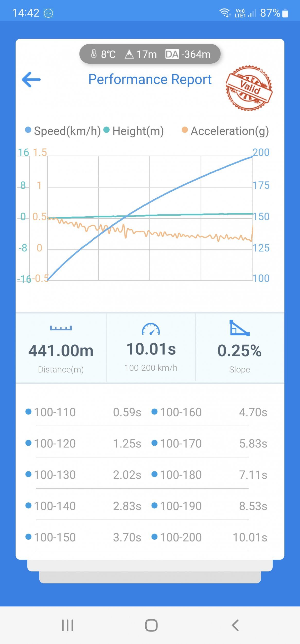

I had the 290 GPF model and had the revo GPF stage 2 (again not old fashioned stage 2) but still required the intercooler upgrade the throttle and charge pipes arnt required but recommended. The quicket that car would do a 100-200 was 9.2 even with a full tank and two passangers was 9.6. Although that was on the 99 Ron file. If you’ve got the 95 or 97 Ron file it makes quite a big difference.
I got the 97ron file (which here in Greece is called 100ron as we got 95, 98 and 100ron fuel). I can definitely see the car doing high 9s with no or negative but still valid slope but 9.2" is way less. Did you also have a tcu tune? I'm stock tcu and the car really needs a box tune but my sw is still unavailable at Revo. I also got a set of Do88 pipes for the stock cooler as I feel the standard rubber pipes expand on high boost and create lag (but that might be just me).

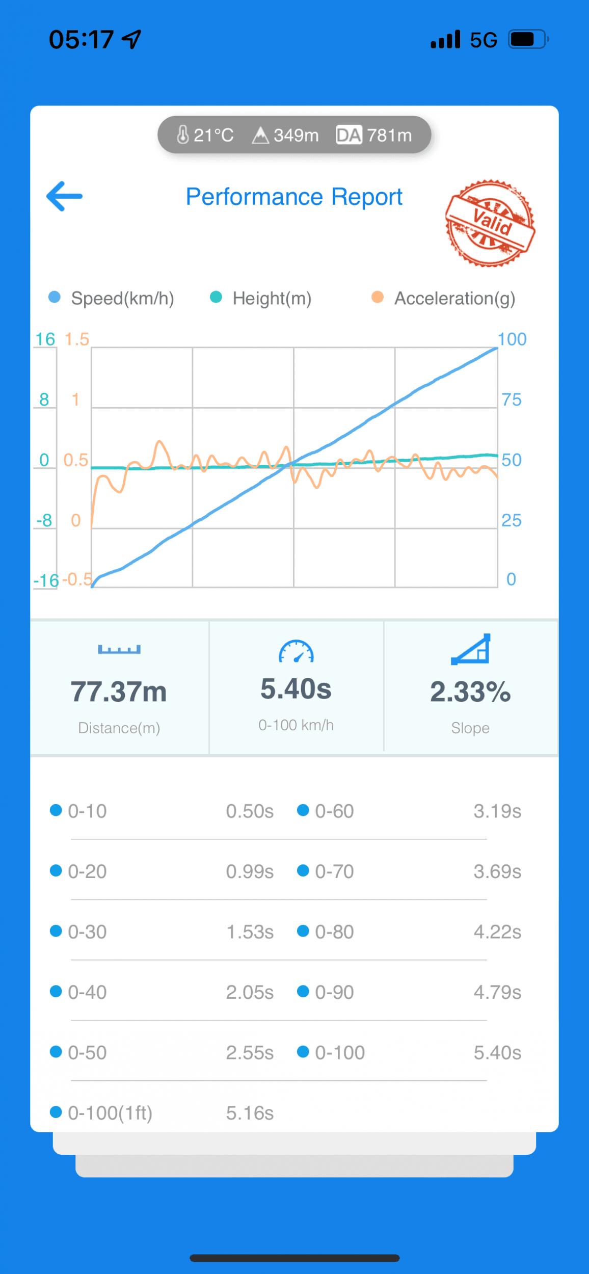

Did a few runs and tried launch control last weekend. Had a passenger, full tank, it was a very humid night and the road was semi wet.
I don't think it's that bad considering the weather (I do have semislicks though), I really like the 0-100(1ft) time. I think with better weather a straight 5 without passengers is doable? :unsure:

I doubt the passenger will make any difference to a 0-60 on a fwd car, if anything it may help having more weight in the front axle.
Decent time for the wet though !!

Yh that time is decent for wet.
