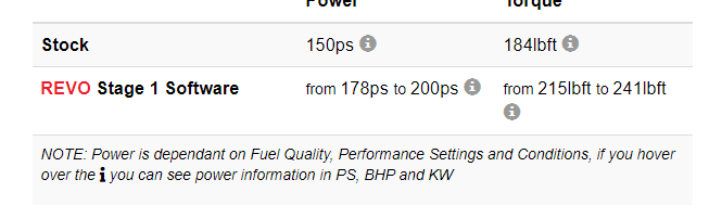

Hi guys,
I'm getting a stage 1 Revo remap over the next couple of weeks, but have a couple of questions first.
From my understanding, the one for my car (1.4 150bhp) it's the "standard + 3 tuning settings".
  • Setting #1 on your SPS sets your vehicle to stock
  • Setting #2 on your SPS sets your vehicle to Revo Performance mode A (Tuned for lower octane pump fuel/poor operating conditions e.g:95ron)
  • Setting #3 on your SPS sets your vehicle to Revo Performance mode B (Tuned for high octane pump fuel/good operating conditions e.g:98ron)
  • Setting #4 on your SPS sets your vehicle to Revo Performance mode C (Tuned for high octane fuel/ideal operating conditions e.g:100ron)
In reality I only fill my car up with normal petrol (not the ultimate stuff), so I'm very unlikely to have it on anything other than "Setting #2" (178bhp).
Q1 - Is it worthwhile paying the £400 + VAT when it's only going to be on 1 setting for life?
Q2 - If I put it on "Setting #3" whilst only using the normal fuel (e.g. I want to show off, go for a blat down a nice A road, etc), what is likely to happen?
