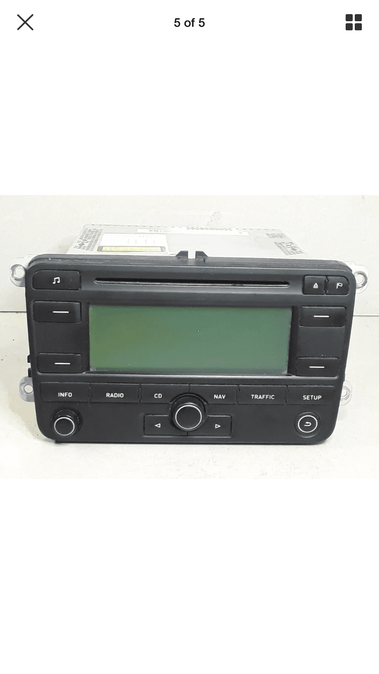

Do you have the English DVD for it? From reading around, some posts are saying factory reset the unit and put in the English DVD, and it should reset the language. Failing that, other posts are mentioning using VAGCOM to change settings which is a bit beyond me.
Good luck, you'd have hoped it would have been easier to find out how to change the language. It will only accept an original TravelPilot CD apparently too.
