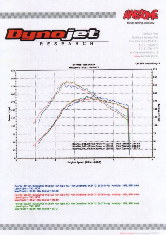

had my car on the rollers at awesome gti
quite happy with mine
i got on mine max power =193.45 max torque = 240.59
