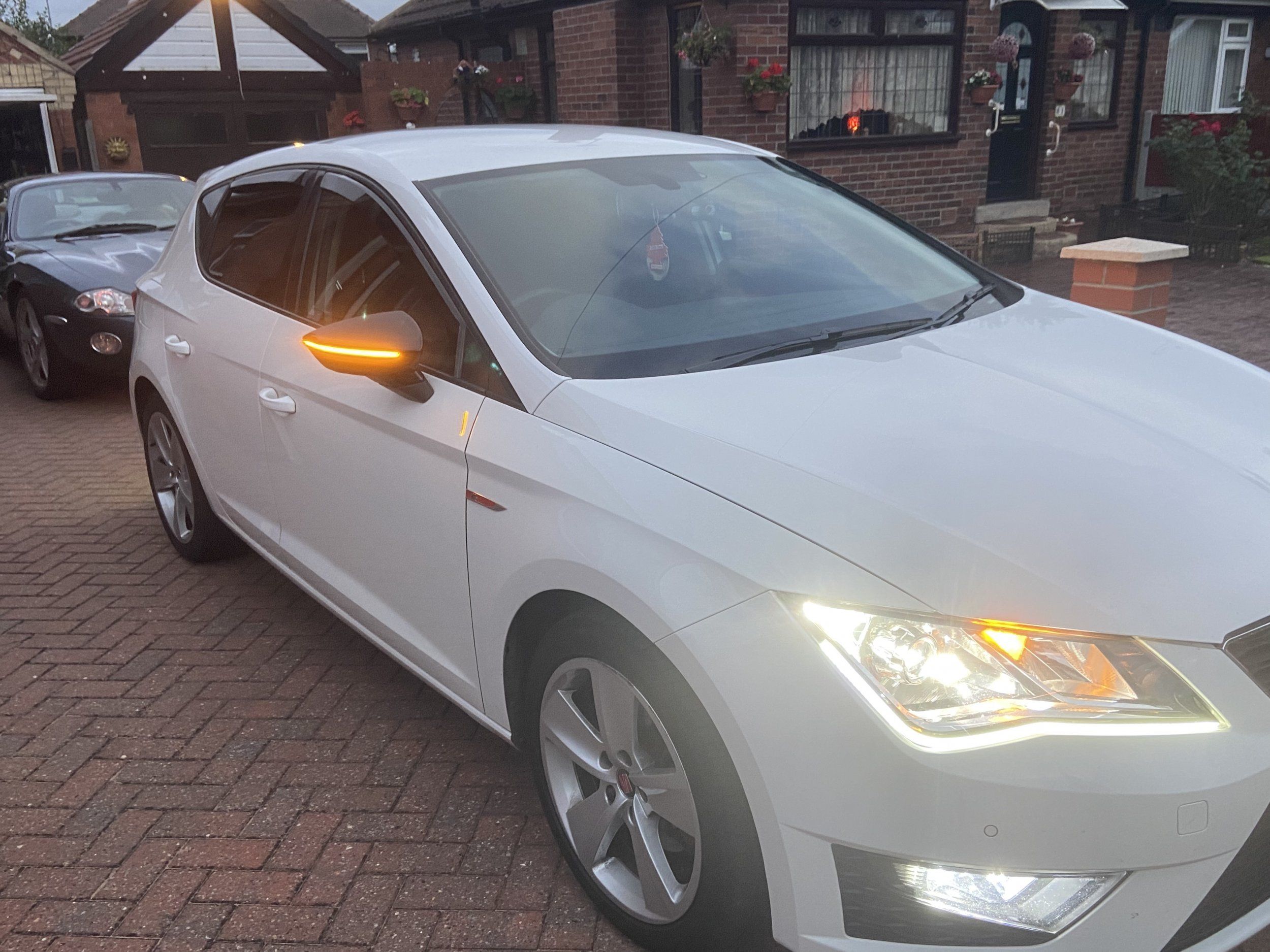

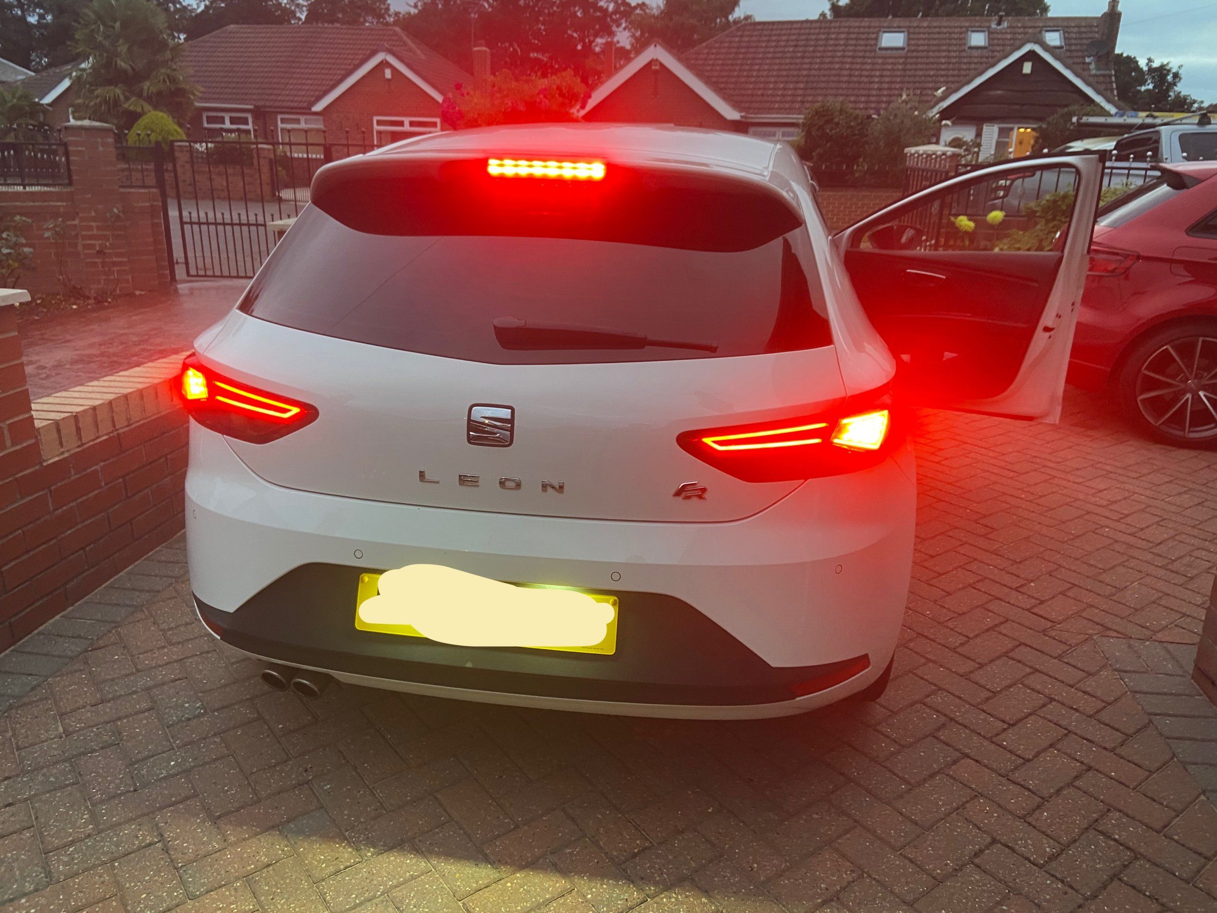

Hi guys,
I’m new here and I’ve tried to find some information on it but sadly I have had no luck…
Sorry it’s a long post ?
I have a Seat Leon 2014 Mk3 2.0 TDI FR (pre facelift) none tech pack.
Im wanting to install a roof mounted aerial for my dab radio as I have had the head unit changed to the factory fit mib 2 unit. I had the basic pack as I was more bothered about the car rather than the extra fancy bits haha.
Everything is working perfectly apart from my crappy stick on dab window mount….. I have even tried a better one and still have a lot of drop outs. I understand that on the actual tech pack models the dab aerial is integrated into the rear window hence the reason for wanting to roof mount.
Im confident of installing the aerial as it is a straight plug and play into the unit. I know I’m having to drill into the roof etc. I’m just wanting to get the roof liner down safely and I can’t find any information for the mk3…
I get the process of taking the A B & C pillars off and I have done and put them back on no problem. I just can’t get the passenger roof handles out and I just want to make sure I take the liner down safely without creasing it ?
I have been quoted over £300 just for an aerial upgrade so you can see why I don’t want to do that when I can do it myself at my own pace haha :)
Any help would be great! Thank you!

I also notice that you have a dash cam - if hardwired, did you use the ferrite core to reduce interference with your current DAB set-up?

Why can't you just use the rear window heater with a suitable VW Group aerial amplifier for DAB, and a Fakr lead fed down the car along with the other leads down one side?

If your Leon definitely does not have the ability to use the rear window heater as an aerial from factory, ie if you can't find and unused potential aerial leads fixed to the rear window, then maybe search for an aftermarket aerial set up that can be used with the rear window heater, that must be easier than removing/refitting the head lining and drilling a hole in the roof.
Dab isn’t too bad in my area, I have tried different aerial setups with the dash cam removed and it doesn’t make a difference :(
I have tried other cars with the factory fitted dab roof mount and that has no problem at all just my stick on dab aerial that is the problem.
Halfords hard wired it for me when I first got the car so I don’t know if they used the ferret core. But by plugging the camera in or taking it out didn’t make a difference in terms of interference…
But as mine doesn’t have any way of using the original aerial I’m having to resort to stick on mounts or drilling and fixing a proper aerial to the roof haha. The only other way is the replace the entire rear windscreen with the elements in and then feed the wire to the unit as it’s a separate antenna :/ which is why I am having to do it this way haha

Unfortunately no mine was the basic package that didn’t have dab or led headlights or anything like that. I have tried looking around for different ways of improving my dab reception and trying to use the original aerial wasn’t possible. even trying to use the heater element wouldn’t work because there isn’t a lead or anything for it to use off. Other than changing the entire rear window and then finally feeding down the wire to the head unit.
