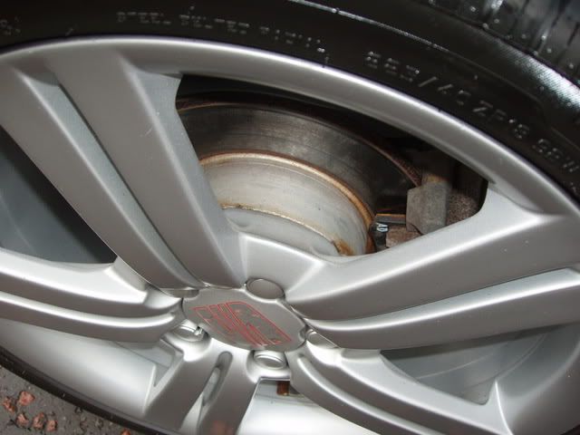

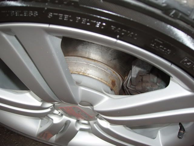

Anyone else experienced something similar? how did you go about solving the problem?
sand it down then paint with black one coat rust hammerite paint, job done
Have a look round any car park and you will see MUCH more expensive and newer cars with the same problem, now the sun is out its a sunday afternoon job to paint them.... you probably wont even have to take the wheels off with the standard 18" alloys as there is a fair amount of room to get a small wire brush and paint brush in...

I bought some "Very High Temperature" paint from HalFRAUDS.
Remove all discs, a good rub down, used a dremel for the tricky bits, a quick paint up and all lookin' lovely..
My suggestion is do it yourself, if you ask a dealer to do it they may only do a quickie job where as you'll take your time if it's your pride and joy.
It's the disc flanges that aren't coated, some manufacturers do some don't, it's not a fault, just a cost cutting exercise.
Some here have managed to get dealers to fix under warranty, I reckon it's not worth gettin out of your pram over it as it certainly isn't a fault.
Another quick tip, when you replace the wheels, smear a dollop of copper grease onto the face of the hub, this will limit the corrosion being caused by the two metals reacting & it will ensure your wheels come off easy at the next service:funk:
