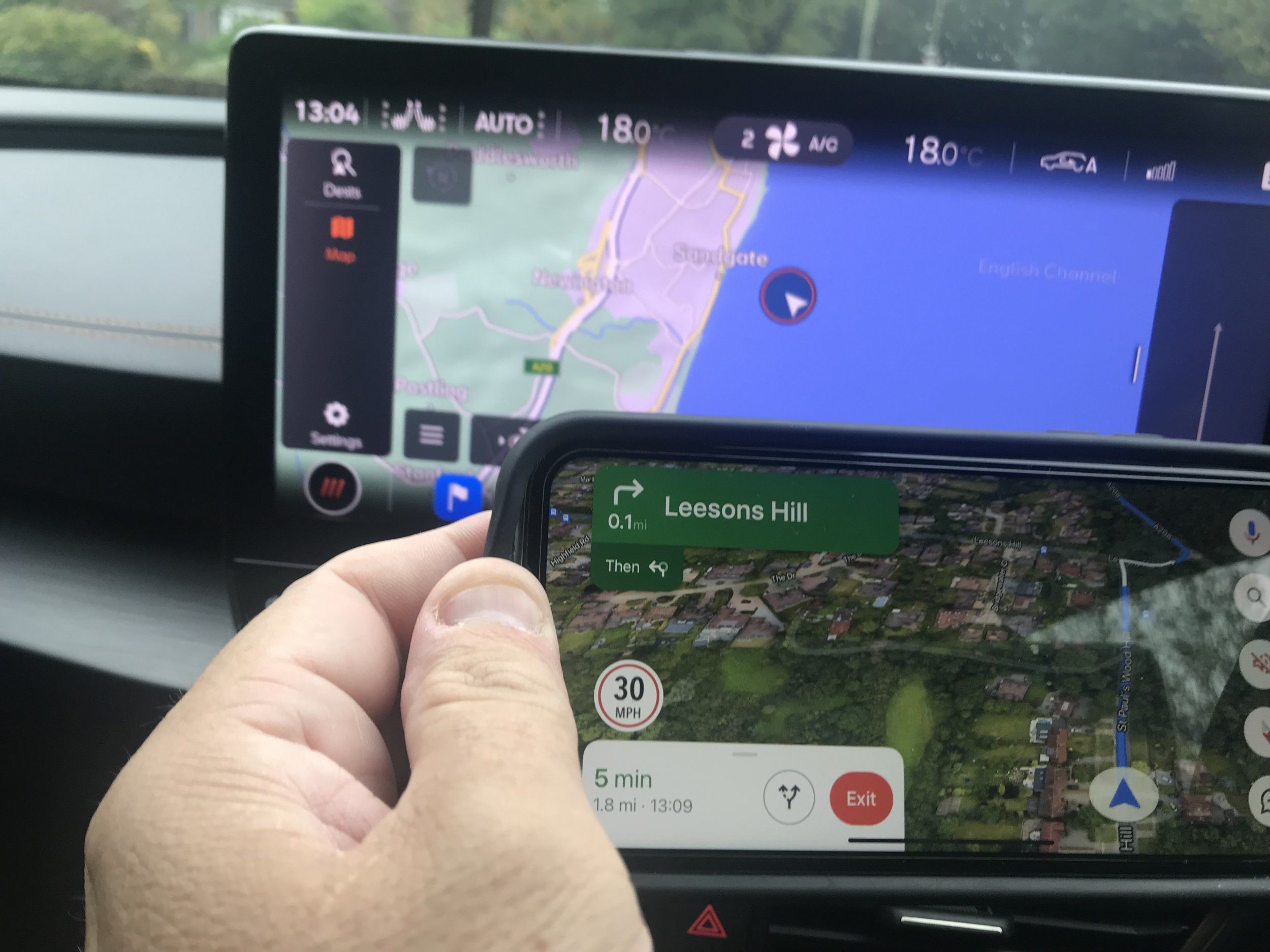

picture for a laugh showing the contrast
In the photo you show the cars built in nav, not CarPlay?
Yes so I can demonstrate how massively wrong it is compared to google maps on my phones GPS
when the carplay connects it overrides the phones Gps and moves my position on google maps to match where the car thinks it is

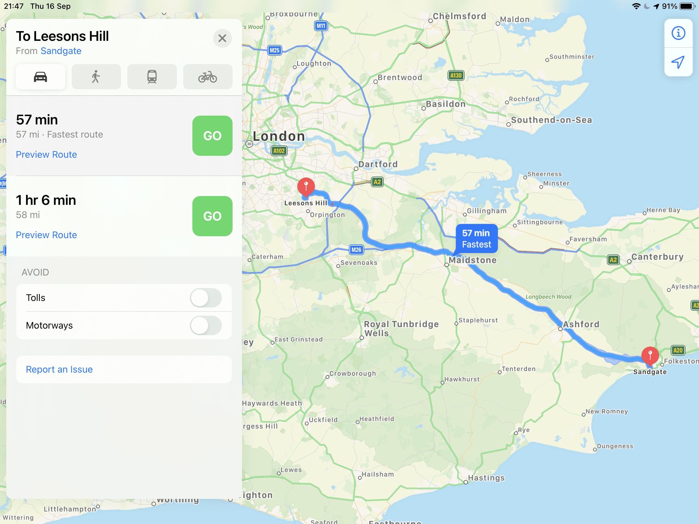

here’s a picture of the 2x locations I managed to be in at the same time and the distance between them
as soon as I allow CarPlay to connect google maps relocates to the position in the English Channel
