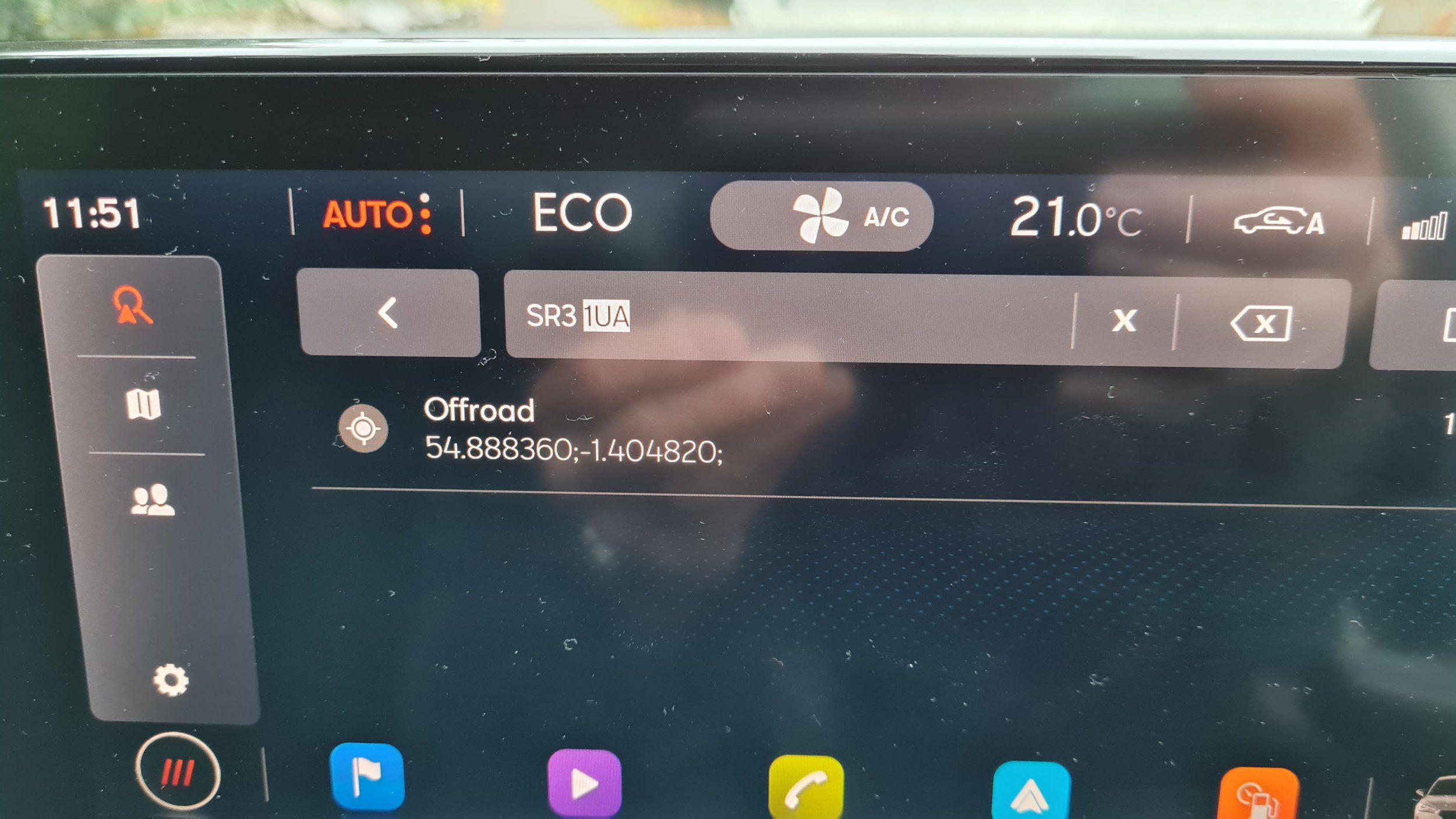

I've just tried the postcode search. It resolves to, for example the correct area of Worcester if I type in "WR4 0", but falls back to an Offroad grid ref if I go further - it is accurate on the map, but not a street address.

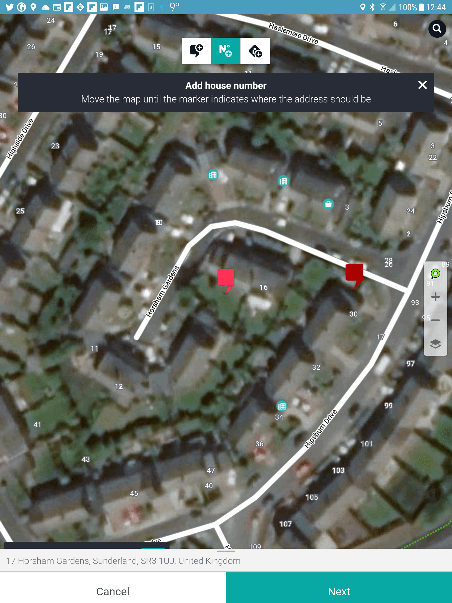

You can sign up to Here Map Creator and allocate missing ones you find. The local authority planning maps you find online contain sufficient street numbers plus the postcode directory online to provide hours of crowd sourcing fun. Eventually those edits should appear on the car's system.

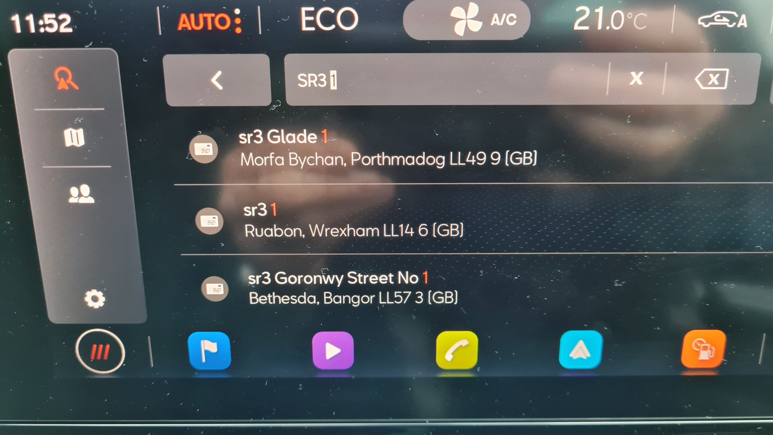

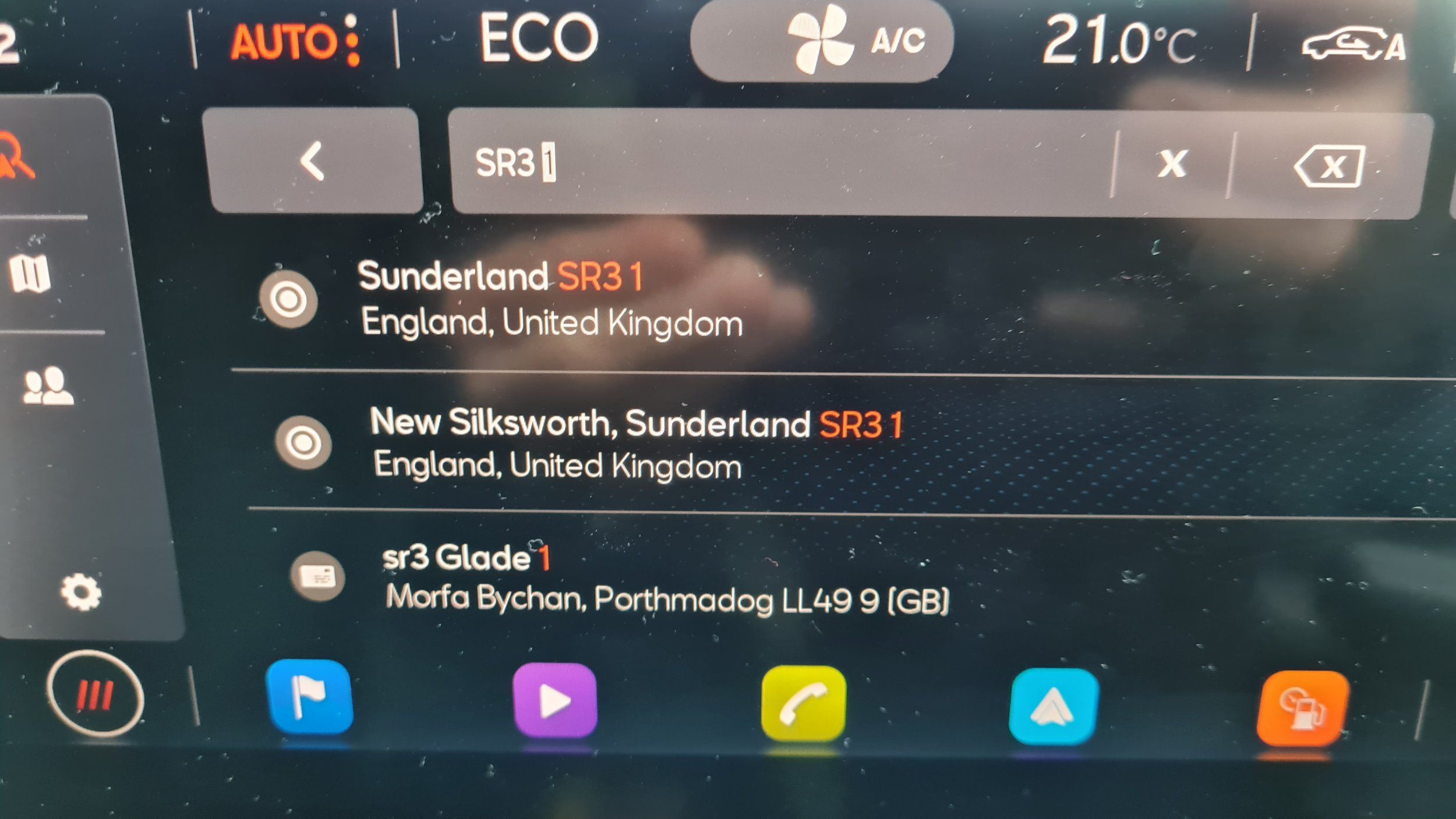

Yeah, I understand about the full postcodes - I have tried a selection, some new ones and some that have been in existance for at least 50 years - and ones that worked ok on my previous Ateca (2019). On this one, the search whirly starts as soon as you begin typing, and produces maybe three or four grid refs for some complete postcodes - as above they are correct if you then look at the map, but only because I know they are. If I was searching for say, a business address that was unfamiliar then a grid ref doesn't help if I have several to choose from.

Some screen shots below as a result of searching for a well established postcode SR3 1UA :

That one has been house numbered so you would get it the more accurate way of just typing the address in without postcode ?.

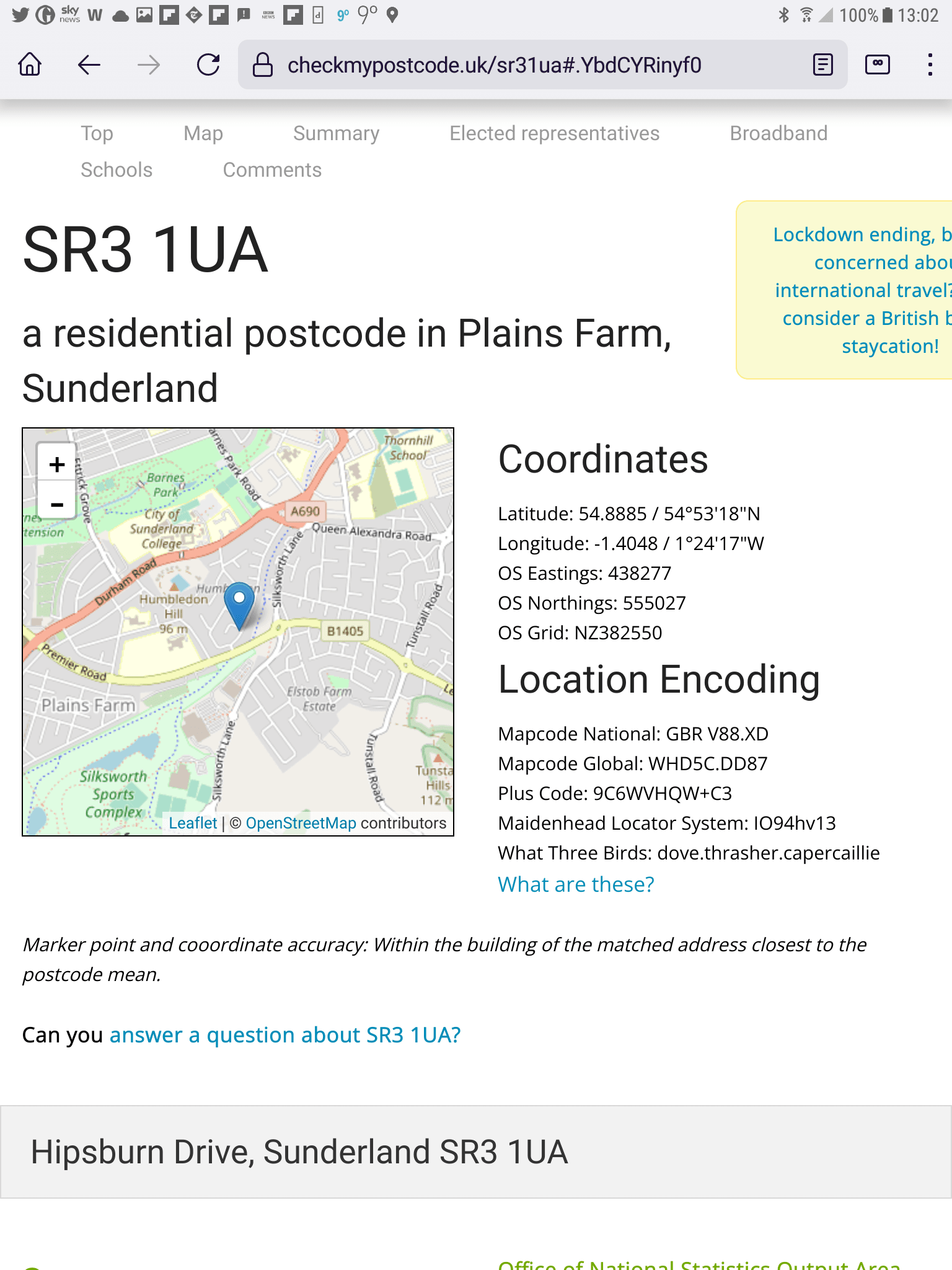

Wear my GIS QA hat if we take your postcode and look it up on the system that contains the postcode centroids as published:
The returned coordinates tally with what you have more or less:
Latitude: 54.8885 / 54°53'18"N
Longitude: -1.4048 / 1°24'17"W
OS Eastings: 438277
OS Northings: 555027
OS Grid: NZ382550
So I'd say if that's coming out like that rather than a road the developers still haven't processed all of the postcodes into grid points on a road, still using the centroid on that. Comes of using programmers rather than GIS experts or GIS expert that no nothing or navigation... or both. Probably some rounding going on in what they are doing so it either missed being matched to the road when they were preparing the files.
They shouldn't be using centroids to postcodes or part postcodes not for navigation purposes. The centroids are used for market research purposes as building blocks to map data held against postcodes against other sets, Census Eds, market research area classification etc... not navigation. They got hold of the wrong file during develop. This was fixed but apparently not totally.
Moral on that is just type the address in :). Should work in this instance.
