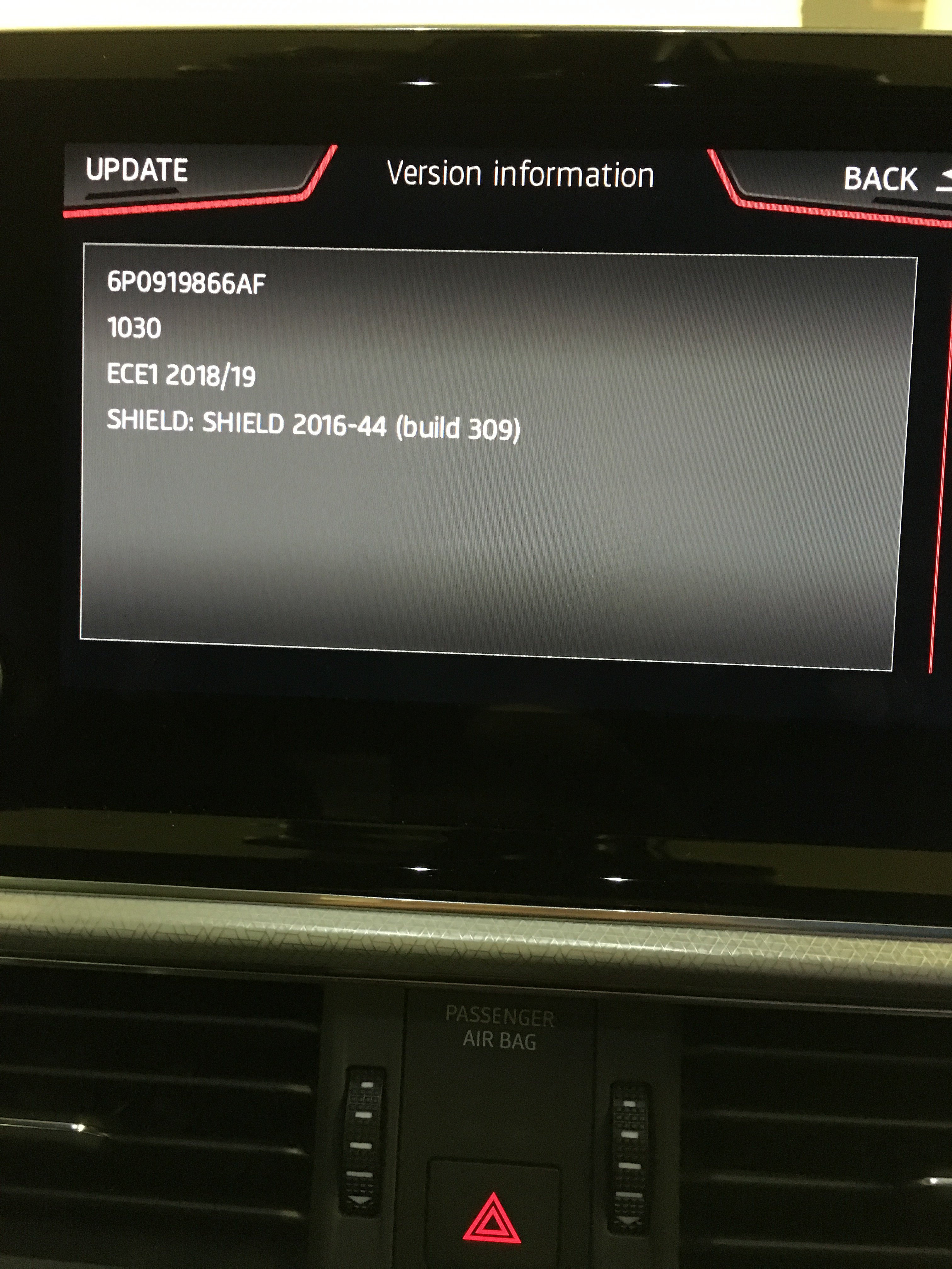

You do the menu:
Press the “NAV” Button.
Confirm the “Setup” > “Version information” selection on the display.
I bet yours is 1115 or 1030. Tends to be whatever card they have to hand to put in it at delivery.

Yes it’s 1030. Gonna try update it now and see how it goes and then update later again when the new one comes

I've got this in the current dbinfo.txt...do I need to edit anything?
ApplicationSoftwareVersionNumber="1030"
PartNumber2="5NA919866"
PartNumber3="5L0051236AH"
PartNumber4="6P0919866AF"
PartNumber5="7CE919866M"
SystemName="ECE1 2018/19"
Also do you reformat the SD card or just delete the folder and copy the new one?

this bit: SystemName="ECE1 2018/19" ?
Yes the 1115 one will say it's 2019/20 which breaks their naming convention, it should have said 2019. It's always the year code ahead in the November release. Whilst the June release is current year / next year. So they messed up the convention. The high is right. This means whatever they release in the summer they have to dig themselves out of a filenaming error.
