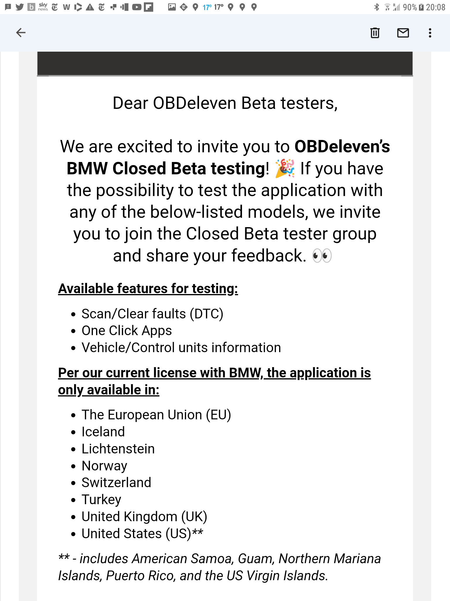

Yeah. I was pointing out that Obdeleven will be doing BMW soon sk if yoh bought a NextGen one you might have a use for it. Got this email. They are looking for testers with BMWs.
