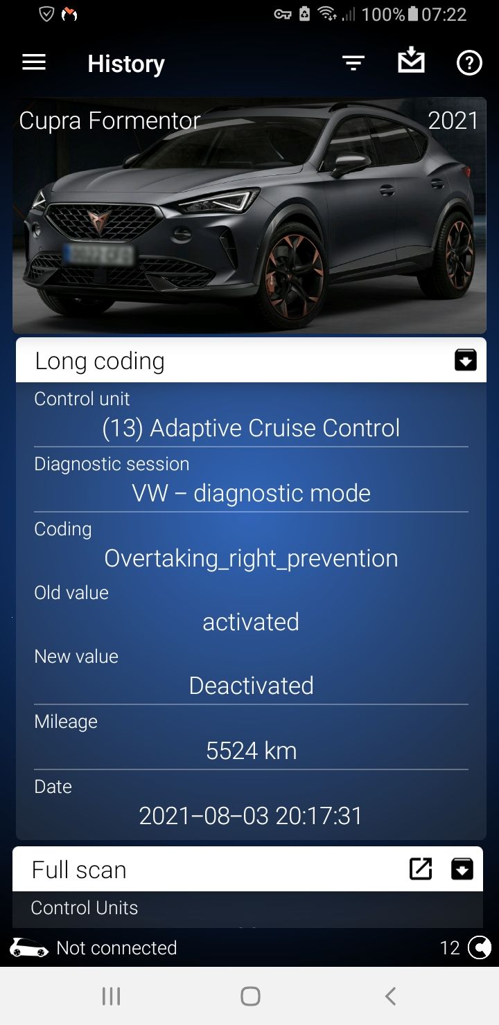

1/ Deactivate overtaking right prevention - Thanks to zelue1995
- Select Control Unit 13
- Select Long Coding (0)
- Select overtaking_right_prevention
- Change from activated to Deactivated
That worked and I don't see cars on the left or right and Formentor doesn't slow down any more. That made huge differece.

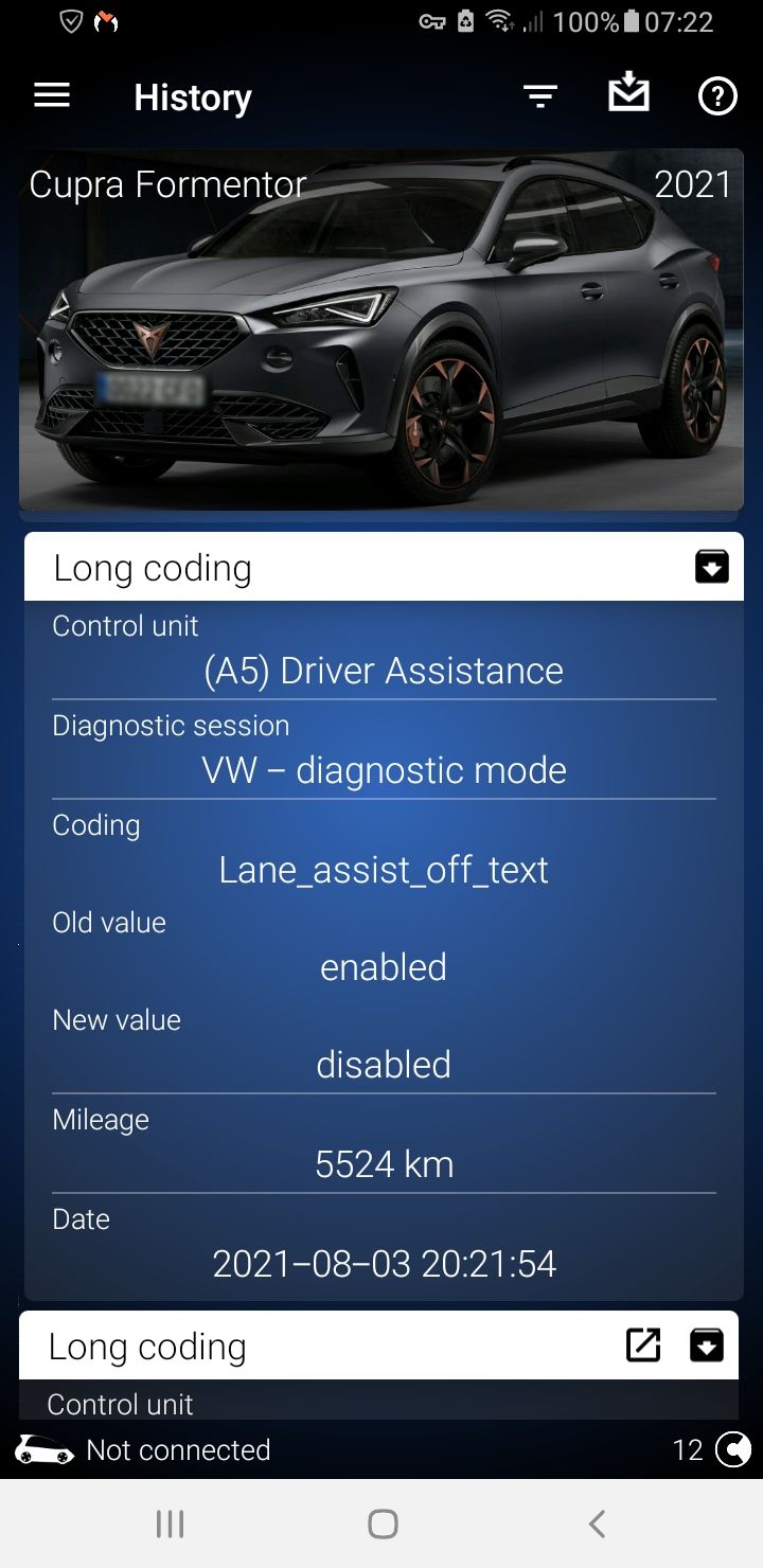

3/ Lane Assist Warnings: thanks to tommy95
- Select Module A5 (Driver Assistance)
- Select Lane Assist Off Text
- Change to Set To Disabled
That worked, I think it also disabled other warning icons on my dash, because I don't have christmas tree any more, when I disable other systems. Or maybe something else disabled warning icons, not sure.

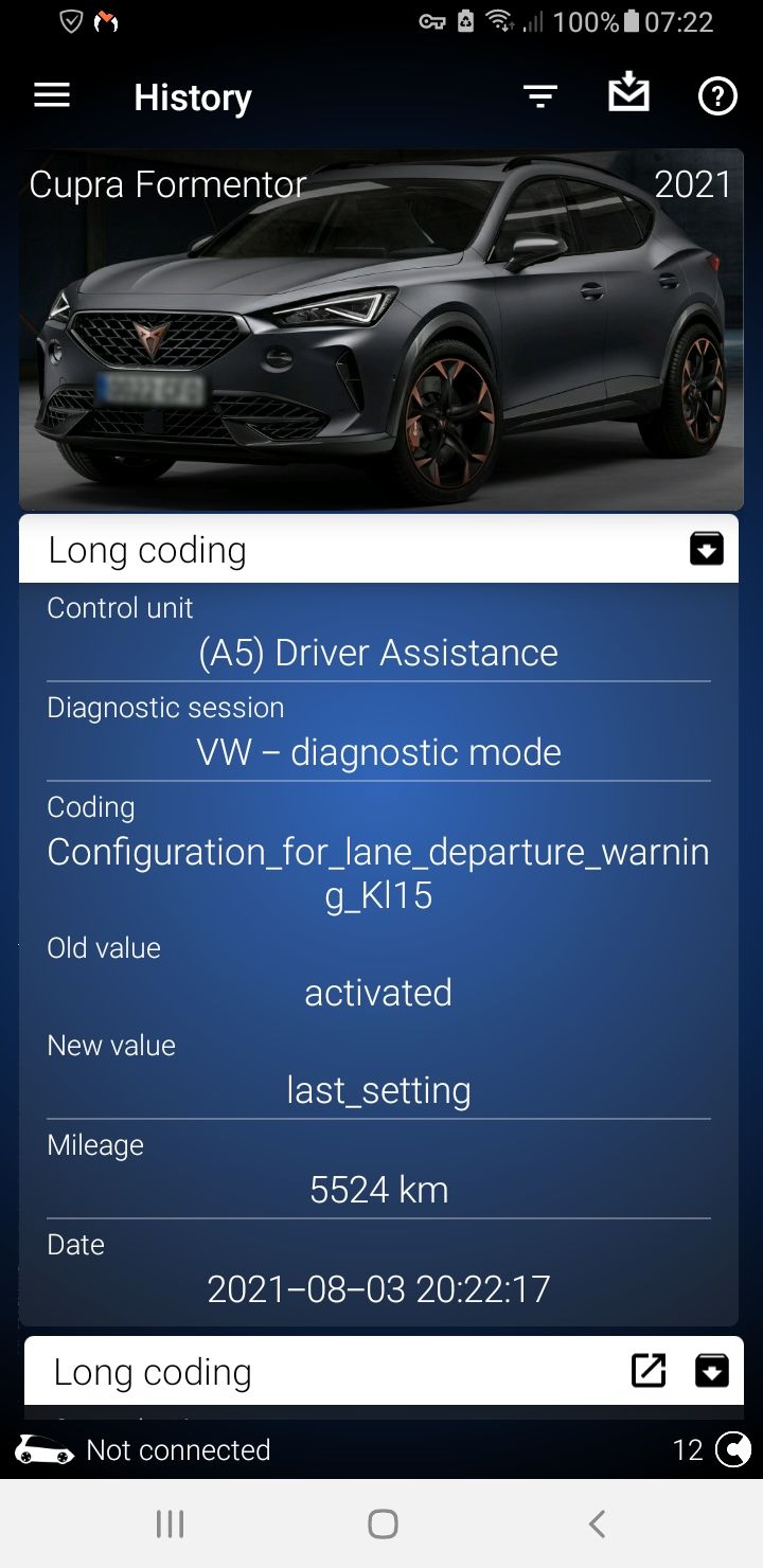

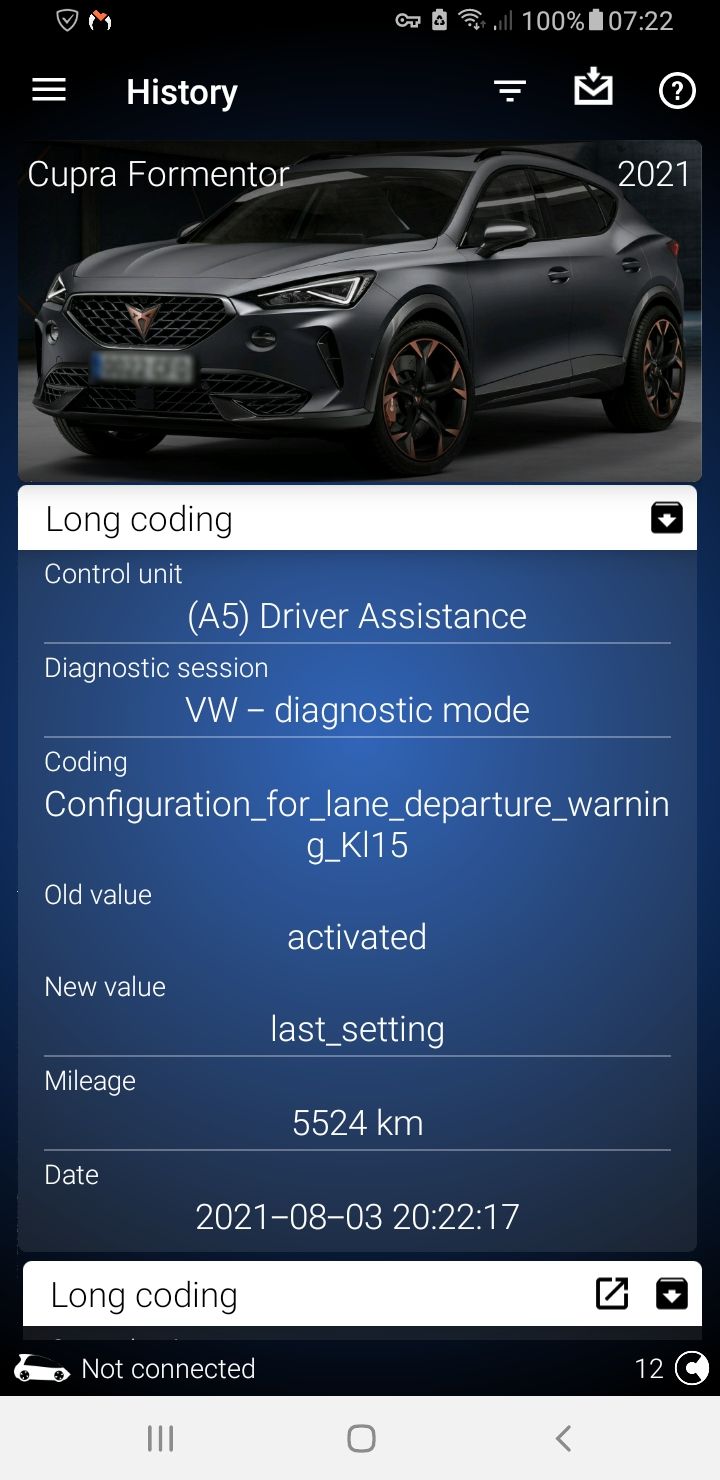

4/ Lane Assist Settings: thanks to tommy95
- Select Module A5 (Driver Assistance) ->
- Select Long Coding ->
- Select Configuration For Lane Departure Warning K15 ->
- Set To Last Setting
That worked. My lane assist was of next time when I switch on the car, even though I didn't switch it off last time.

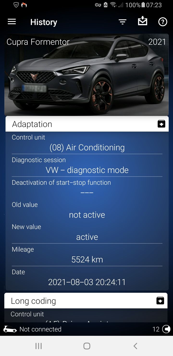

5/ Deactivate Stop Start
Disabling Stop Start thanks to Phipilipipp on the seat-leon.de forum
I have seen that some users have problems with this coding on MK3 but It has been confirmed that it works fine on MK4.
- Select Control Unit 08 (Air Conditioning)
- Select Adaptation
- Select Deactivation of Start Stop Function
Value change was accepted, but start/stop came back on next restart. So doesn't work.

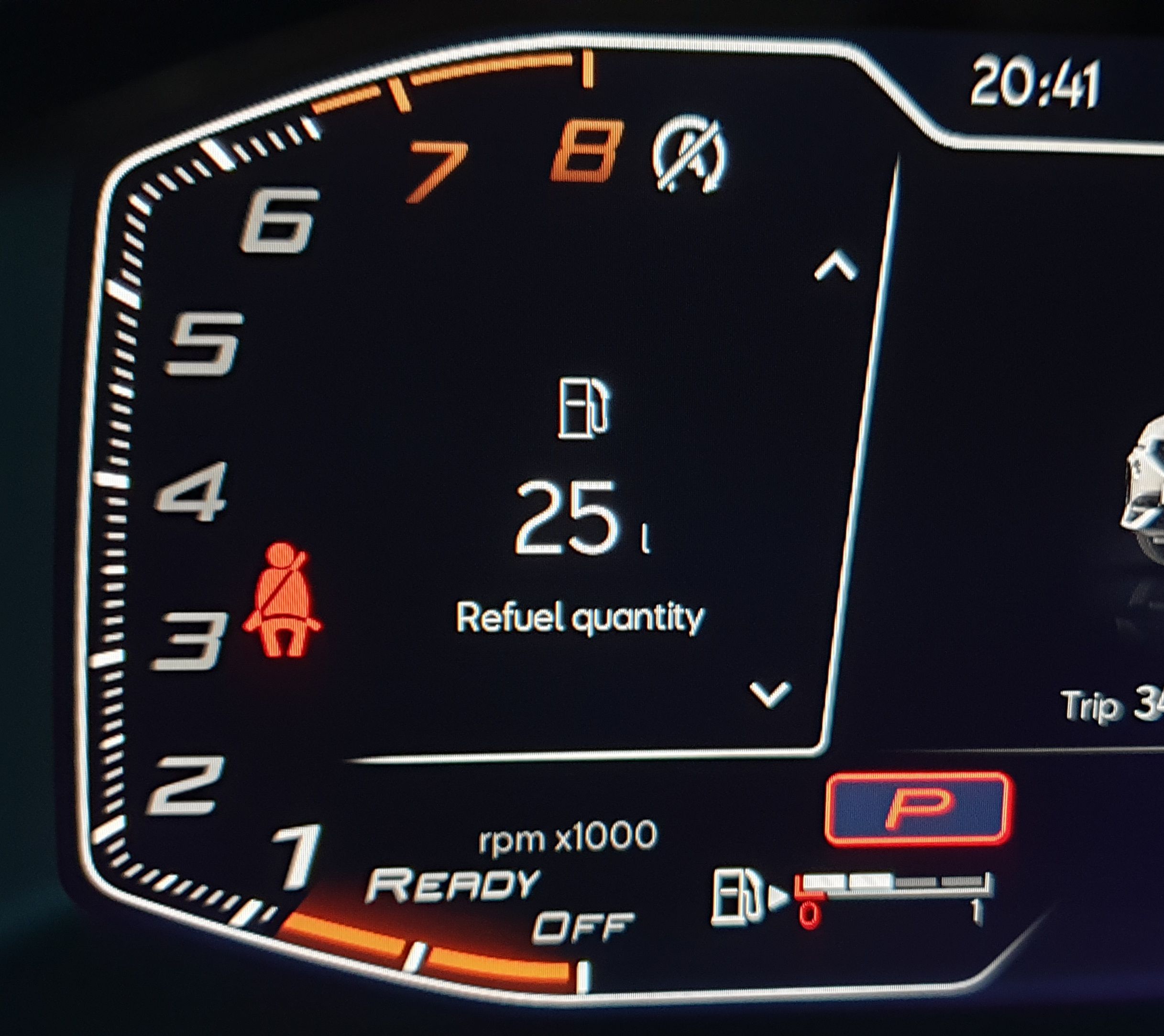

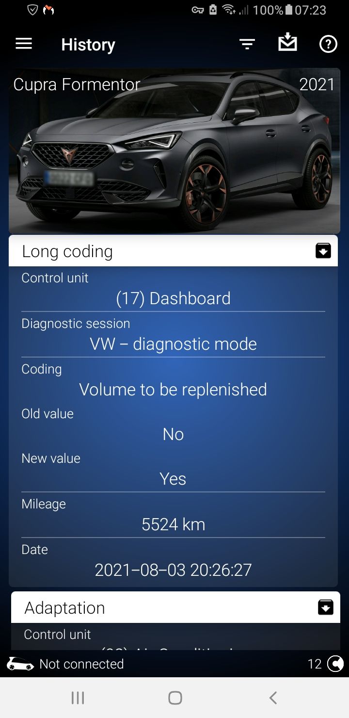

4/ Remaining Fuel Quantity thanks to massimo23
1 - Select Control Unit 17 - Instrument panel (Dashboard)
2 - Select Long Coding
3 - Adjust Volume to be replenished: Set to Yes if you want to see it. If you have it and don't want it then change to No
That worked and now I can see in left scrolling panel how many l to refuel, quite like it.

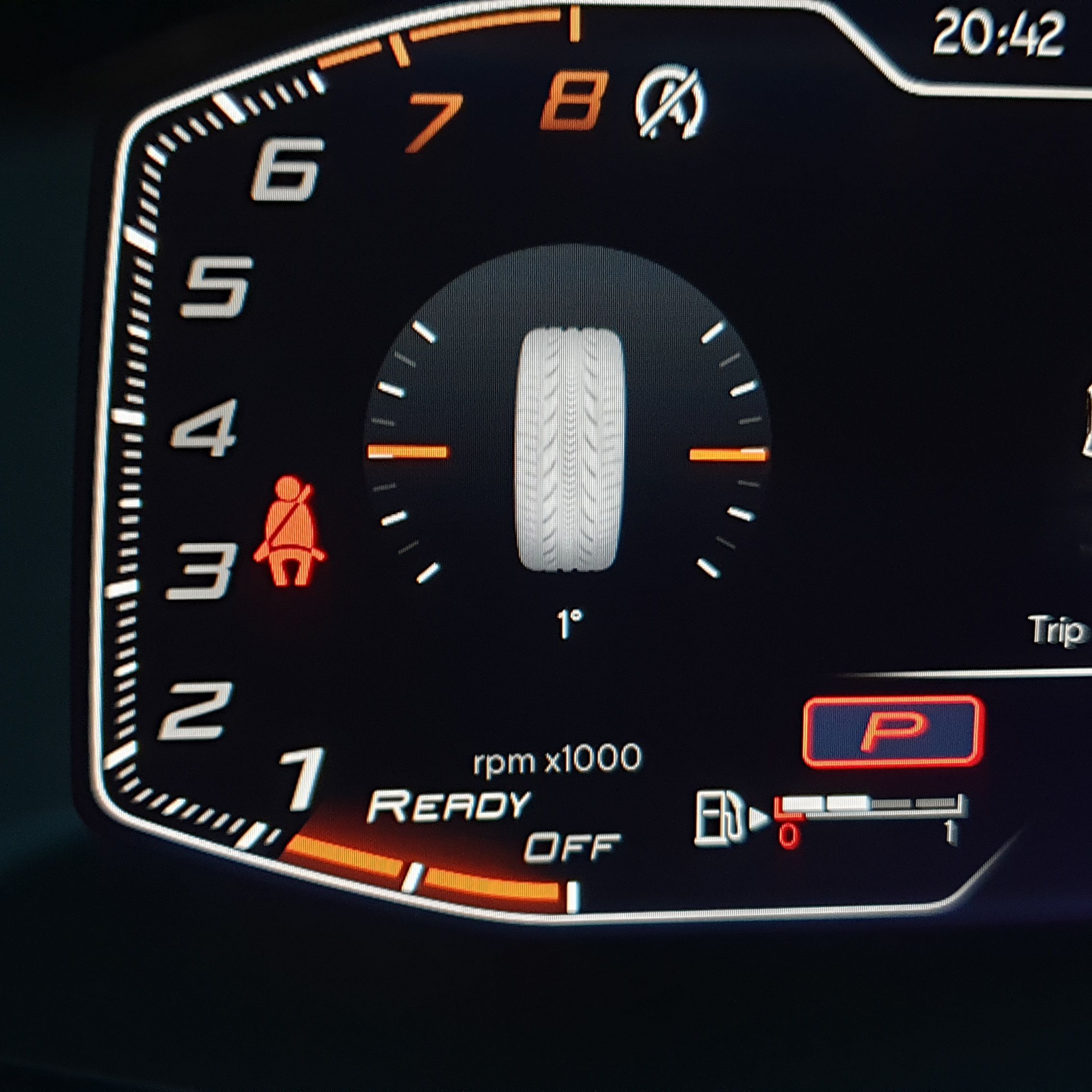

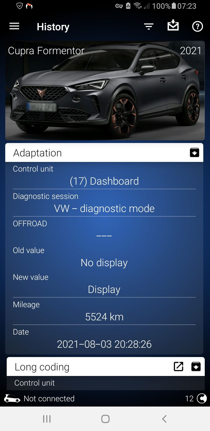

Offroad View in the Dashboard: thanks to massimo23
this is from golf8 so may be different setup on Leon
In 17-Dashboard
go to Adaptions.
Set Offroad to Display
Go to View Activation
Change the setting in View_10 to active.
You should see the following in the View cards.
That works, but view is different in Formentor. Not sure if it's going to be useful for anything.
