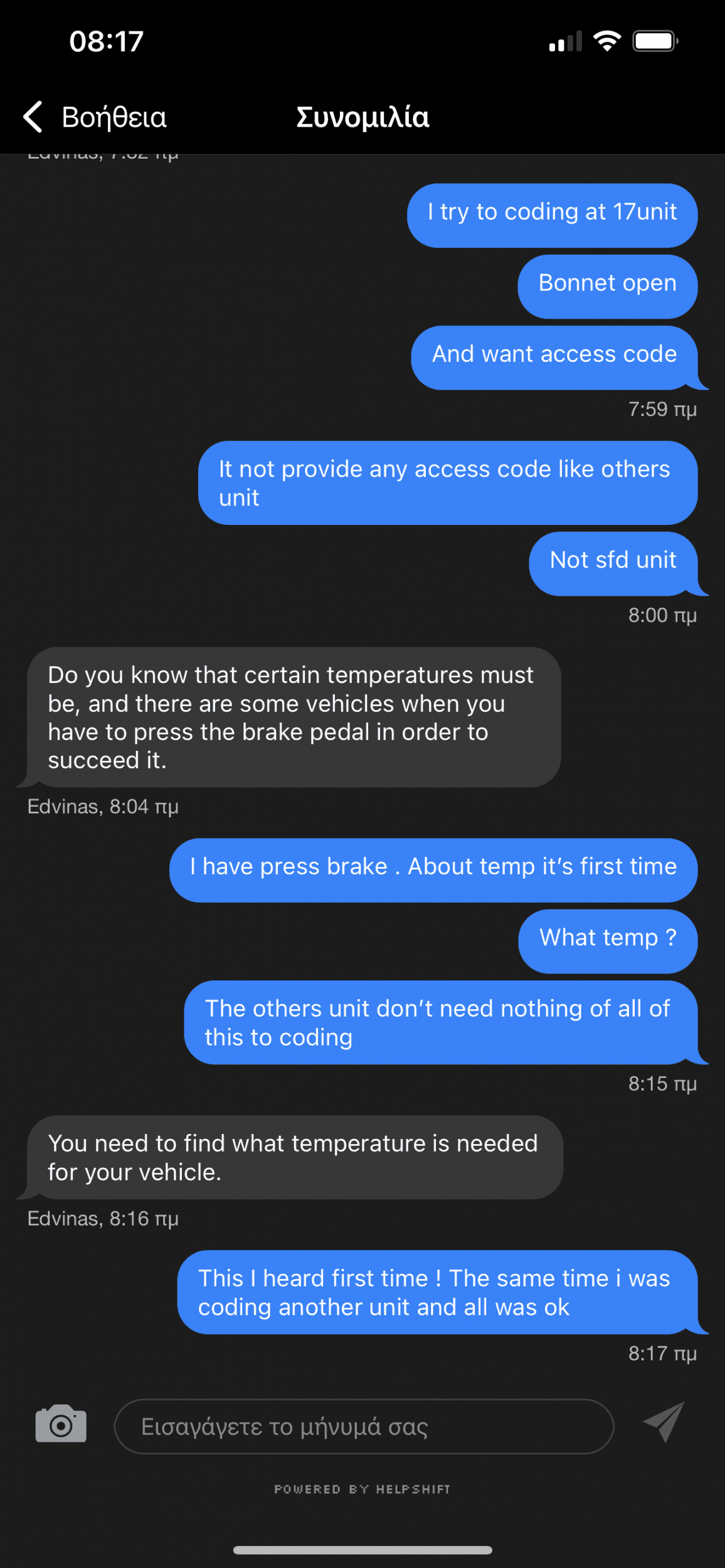

I went through a list of modifications listed on OBD Eleven forum for Leon MK4 and did some changes to my car. Below what worked and what didn't work.
1/ Deactivate overtaking right prevention - Thanks to zelue1995
- Select Control Unit 13
- Select Long Coding (0)
- Select overtaking_right_prevention
- Change from activated to Deactivated
That worked and I don't see cars on the left or right and Formentor doesn't slow down any more. That made huge differece.

5/ Deactivate Stop Start
Disabling Stop Start thanks to Phipilipipp on the seat-leon.de forum
I have seen that some users have problems with this coding on MK3 but It has been confirmed that it works fine on MK4.
- Select Control Unit 08 (Air Conditioning)
- Select Adaptation
- Select Deactivation of Start Stop Function
Value change was accepted, but start/stop came back on next restart. So doesn't work.

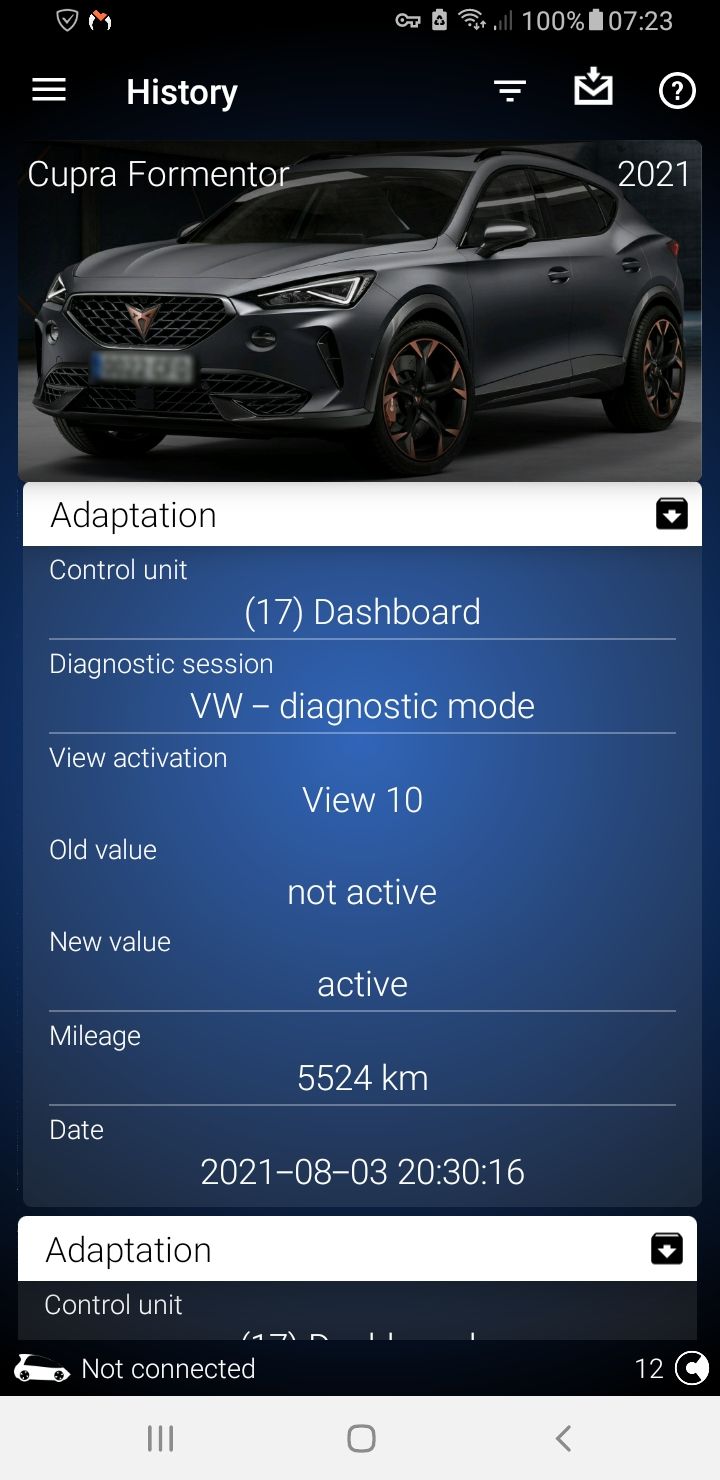

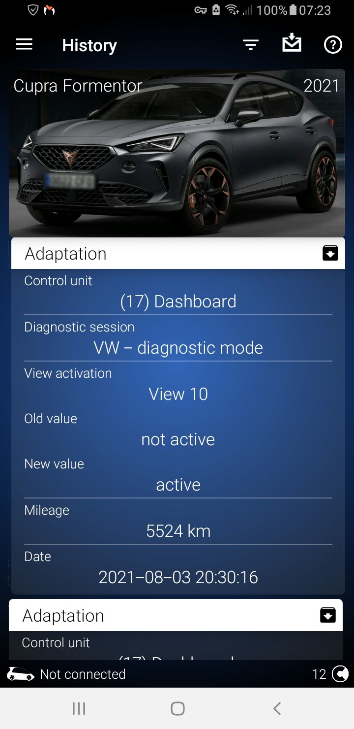

Offroad View in the Dashboard: thanks to massimo23
this is from golf8 so may be different setup on Leon
In 17-Dashboard
go to Adaptions.
Set Offroad to Display
Go to View Activation
Change the setting in View_10 to active.
You should see the following in the View cards.
That works, but view is different in Formentor. Not sure if it's going to be useful for anything.
