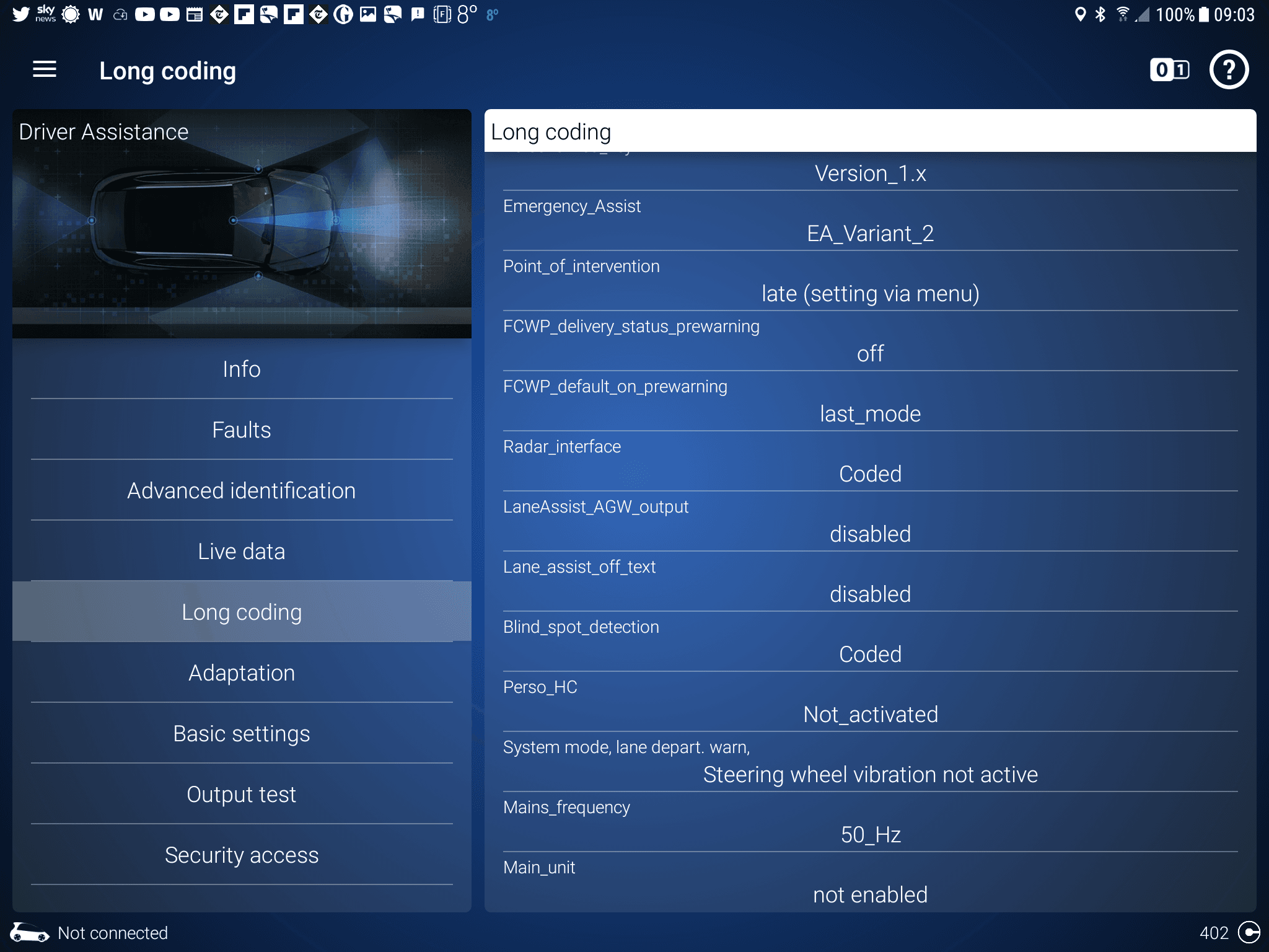

Hi Everyone,
I have been having a play with OBDeleven with my car (FR First Edition) and have managed to code some things and thought Id share what I have found and create a thread where people can share there findings for us all.
I have managed to code:
Cupra Display
Lane Assist Point Of Intervention (Have yet to test, but should keep the car more central rather then let it almost drift out of lane before kicking in)
Lane Assist Set To Last Setting
Lane Assist Warnings Turned Off
I know a lot of people find lane assist is already to sensitive (its already set to lowest from factory), so I might have found a solution to this too. So you can turn it off and it will remember this setting each time the car is turned on etc, so now you can make it sensitive for the motorway and only turn it on when you want it.
Cupra Display:
Module 17 (Dashboard) -> Long Coding -> View Activation -> Set All 16 Views to active -> Write To Car
Lane Assist Point Of Intervention:
Module A5 (Driver Assistance) -> Long Coding -> Point Of Intervention -> Set To Early -> Write To Car
Lane Assist Warnings:
Module A5 (Driver Assistance) -> Long Coding -> Lane Assist Off Text -> Set To Disabled -> Write To Car
Lane Assist Settings:
Module A5 (Driver Assistance) -> Long Coding -> Configuration For Lane Departure Warning K15 -> Set To Last Setting -> Write To Car
Let me know what you guys find :D

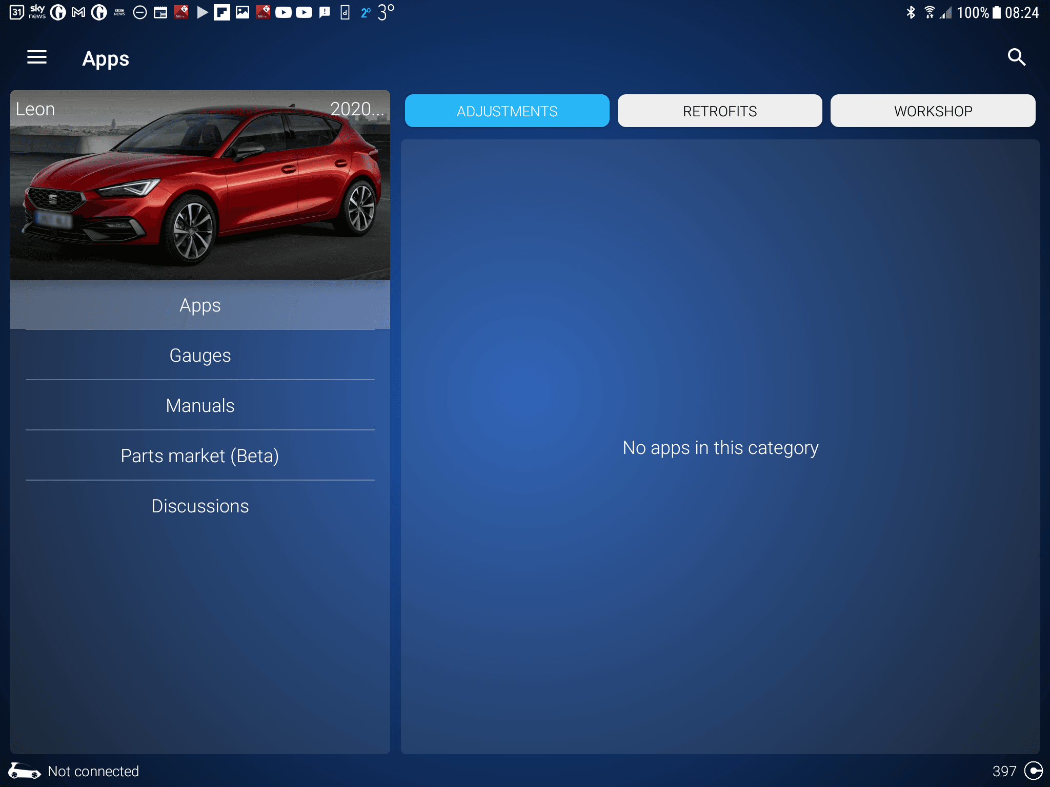

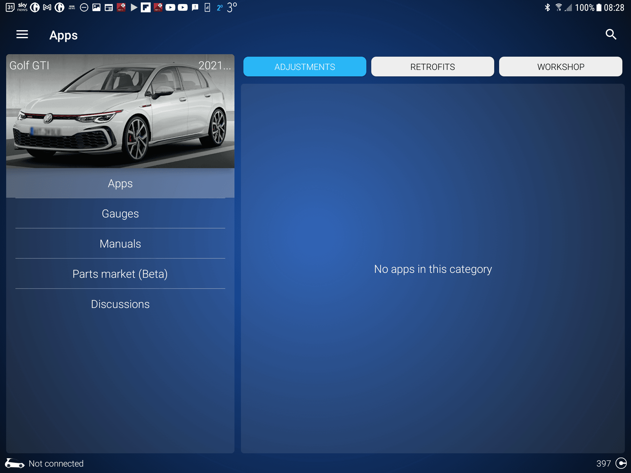

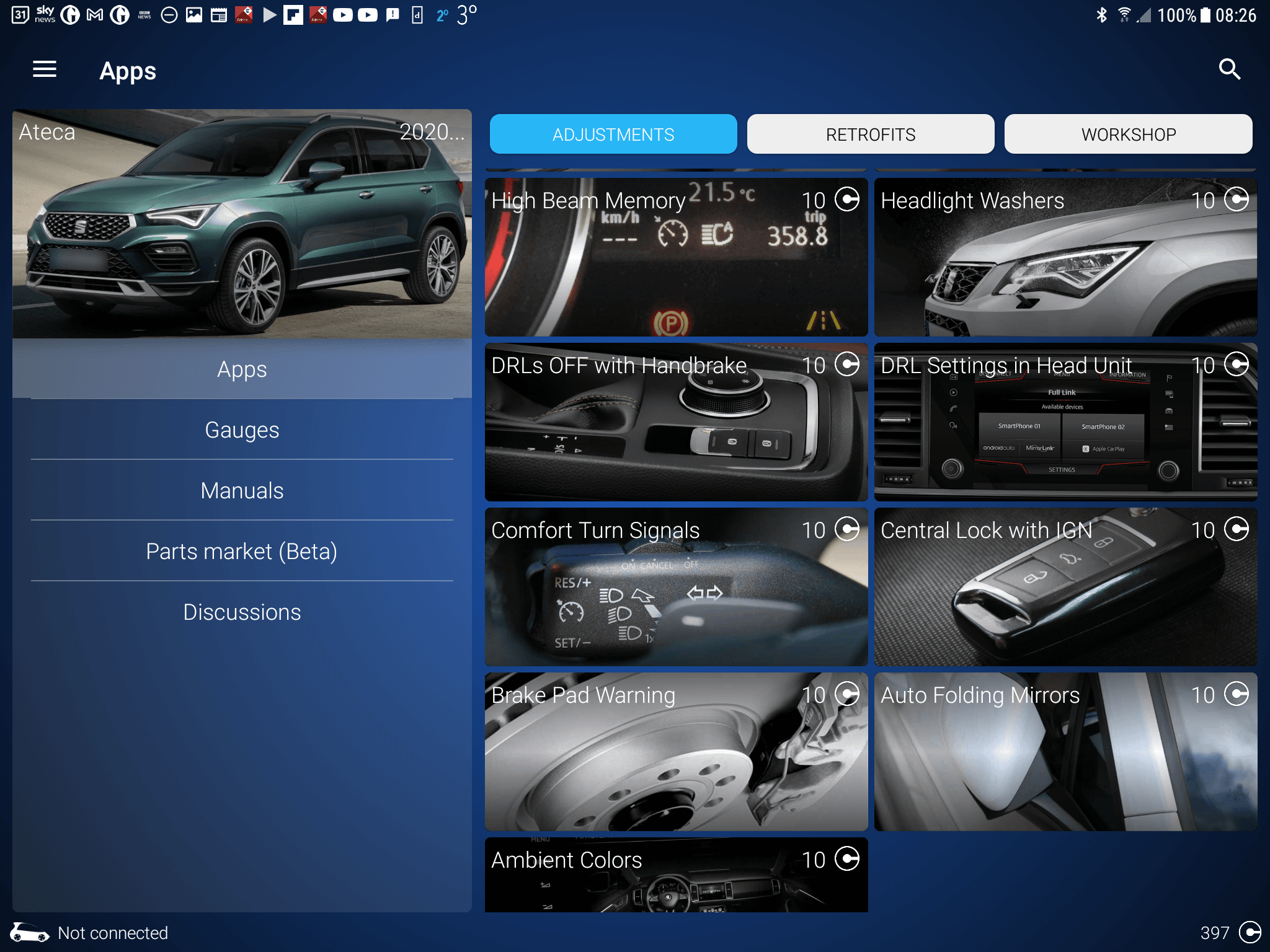

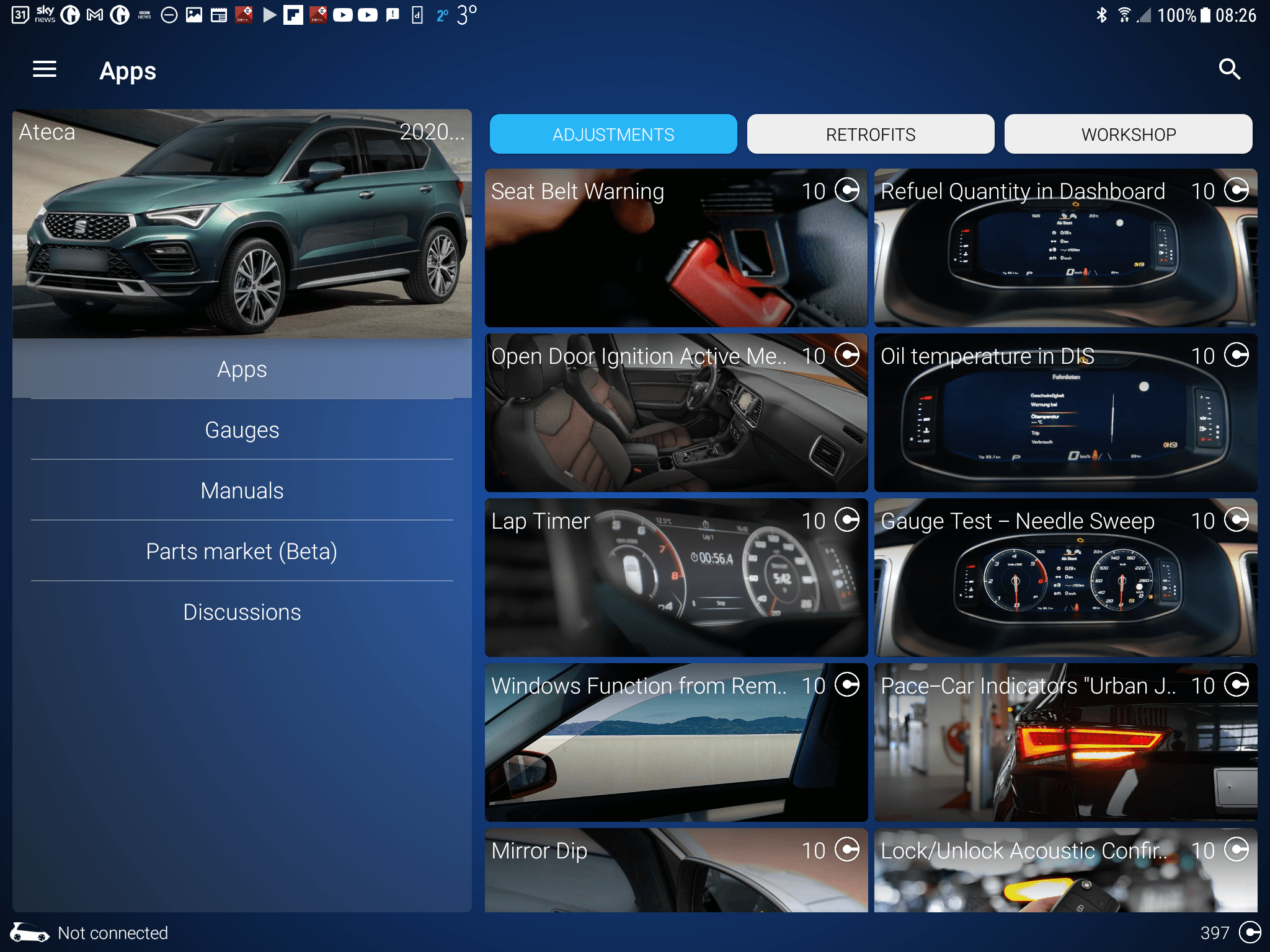

I applied the scientific method yesterday and checked to see what apps they supported on the Leon 4 at the minute, nill. Thought it would be interesting to see which app based mods had excluded so they would have been round the control units which are currently protected by SFD. Think they haven't currently provided any apps so any activity has to be done using the programming / coding method, not the lazy app approach for novices ;).
I also checked the Ateca 2020, they have quite a few showing. Here you could cross check the published coding for those, whether they go into the unsupported control units and whether those elements of the control unit are in the Leon 4. You might find some mods in their that you can do with the Leon 4. Slides 2 and 3.
There is nothing shown against the Golf 8 yet.

Point you to this thread if you want to turn lane assist being permanently on to off at each start up or vice versa:
See @t_v post on the thread. Reckon it would work on a Leon 4. It's a parameter on Lane Assist control module that was knocking about historically which VAG has now used even prior to the lock down of VCDS (SFD) on the Tarraco but appears to be one of the control units not locked down if you you follow my posts after. Worth a try on a Leon 4. We say appears not locked now, could be, worth a try.
The Peta2020 post in those links
All of you probably know that all the Scalas and Kamiqs are equipped with Lane assist systems (even the entry level ones). Although this system is usually very helpful, it is a bit annoying that once it is turned off in maxidot menu - assistance systems, it turns back on upon cycling a key.
However this is the coding that prevents this from happening:
-> Control Unit A5 - Driver Assistance
-> select Long coding
-> change setting Perso_HC from Activated to Last_setting
-> press the magical green button to save the changes
tip: in case you get the error when saving -> (31) function not available, change the mode to vw - diagnostic mode, and try again (even if you are already using this mode, just reselect it again)
Once activated, the car will remember the last state of Lane assist (on or off) upon cycling the key.
