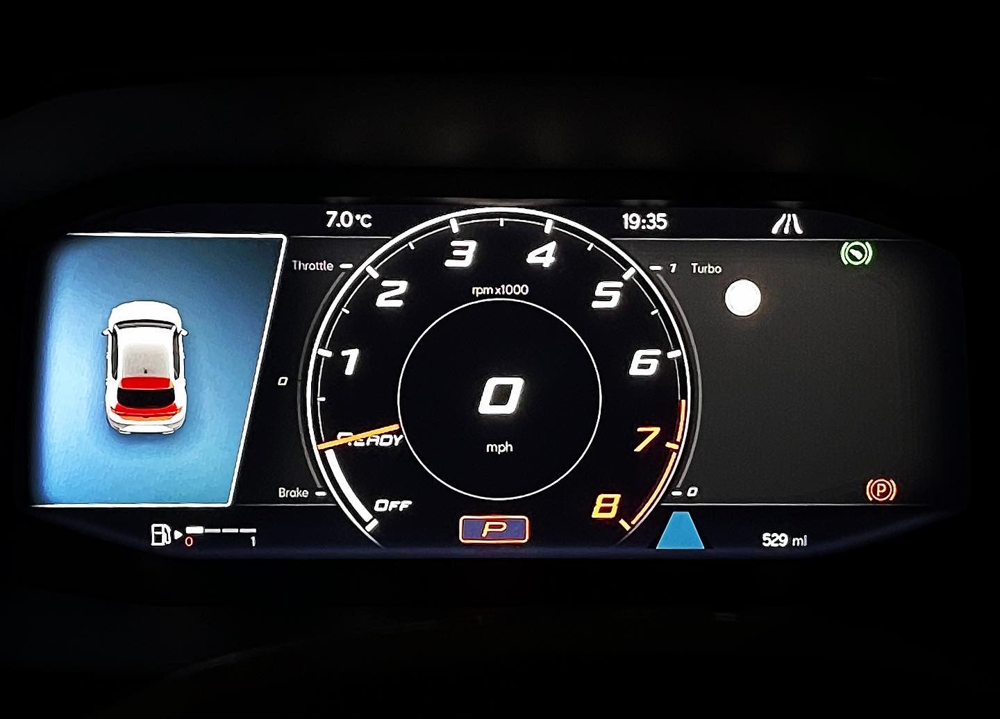

I have been having a play with OBDeleven with my car (FR First Edition) and have managed to code some things and thought Id share what I have found and create a thread where people can share there findings for us all.
I have managed to code:
Cupra Display
Lane Assist Point Of Intervention (Have yet to test, but should keep the car more central rather then let it almost drift out of lane before kicking in)
Lane Assist Set To Last Setting
Lane Assist Warnings Turned Off
I know a lot of people find lane assist is already to sensitive (its already set to lowest from factory), so I might have found a solution to this too. So you can turn it off and it will remember this setting each time the car is turned on etc, so now you can make it sensitive for the motorway and only turn it on when you want it.
Cupra Display:
Module 17 (Dashboard) -> Long Coding -> View Activation -> Set All 16 Views to active -> Write To Car
Lane Assist Point Of Intervention:
Module A5 (Driver Assistance) -> Long Coding -> Point Of Intervention -> Set To Early -> Write To Car
Lane Assist Warnings:
Module A5 (Driver Assistance) -> Long Coding -> Lane Assist Off Text -> Set To Disabled -> Write To Car
Lane Assist Settings:
Module A5 (Driver Assistance) -> Long Coding -> Configuration For Lane Departure Warning K15 -> Set To Last Setting -> Write To Car

Tomy i cannot find the View Activation sub menu in Long Coding , any ideas ?

Did you do the long press on the button down the bottom and it says "adaption accepted" or words to that effect supplying the 5 digit security code ?. If it gives an error then that adaption hasn't been accepted. The history log should also show the adaption going thru.

Yes I saw that the adaptation had been accepted, I have found the changes in the history also. I saw the changes that can be done in the obdeleven forum , a guy replied to me that I have to press the view button in order to change the view bit I couldn’t find this option. I I’ll try later again and I’ll keep you posted
Reactions: Tell
So I finally made it , I was Long pressing the view button not the ok button dah

View button on the car ?. Also was that a bonnet up mod. I think they all are with SFD now.
You have to press the ok button next to the view button on the steering wheel.
I am not sure if it is a bonnet up mod as i first did it with the bonnet up , then i closed it , reverted and did it again as i couldn't see the changes.
