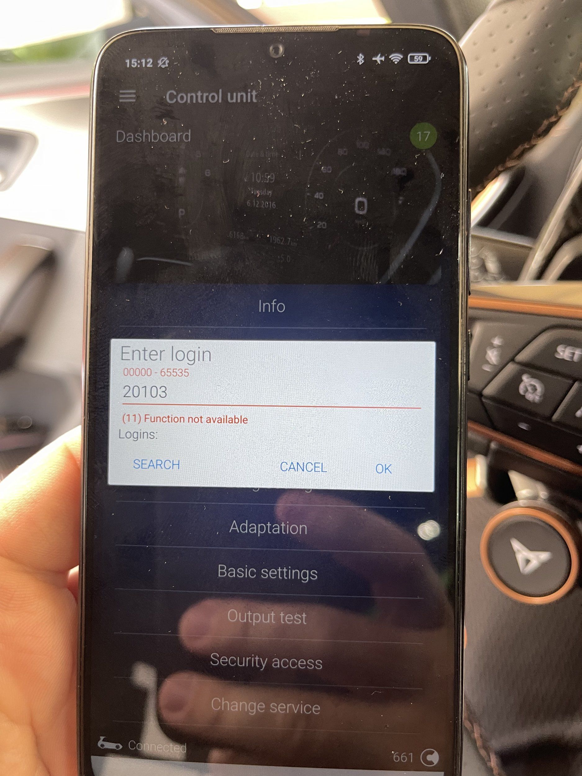

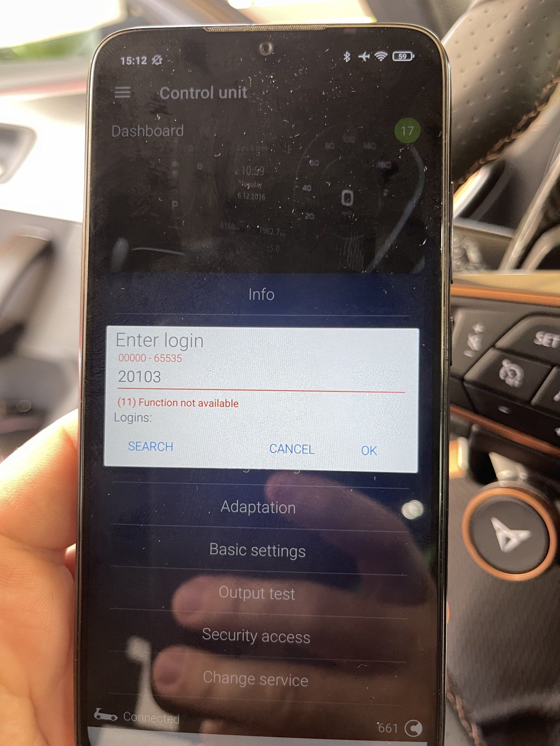

I try to make some codings . I work years with obd eleven . The program shows the default code but at formentor doesn’t. I try the 20103 but nop!!
Bonnet up during save.

Thanks for help ! The bonnet is up ! I have make few coding in others units . The 17 I think is closed . My car is June production and maybe it’s locked sfd

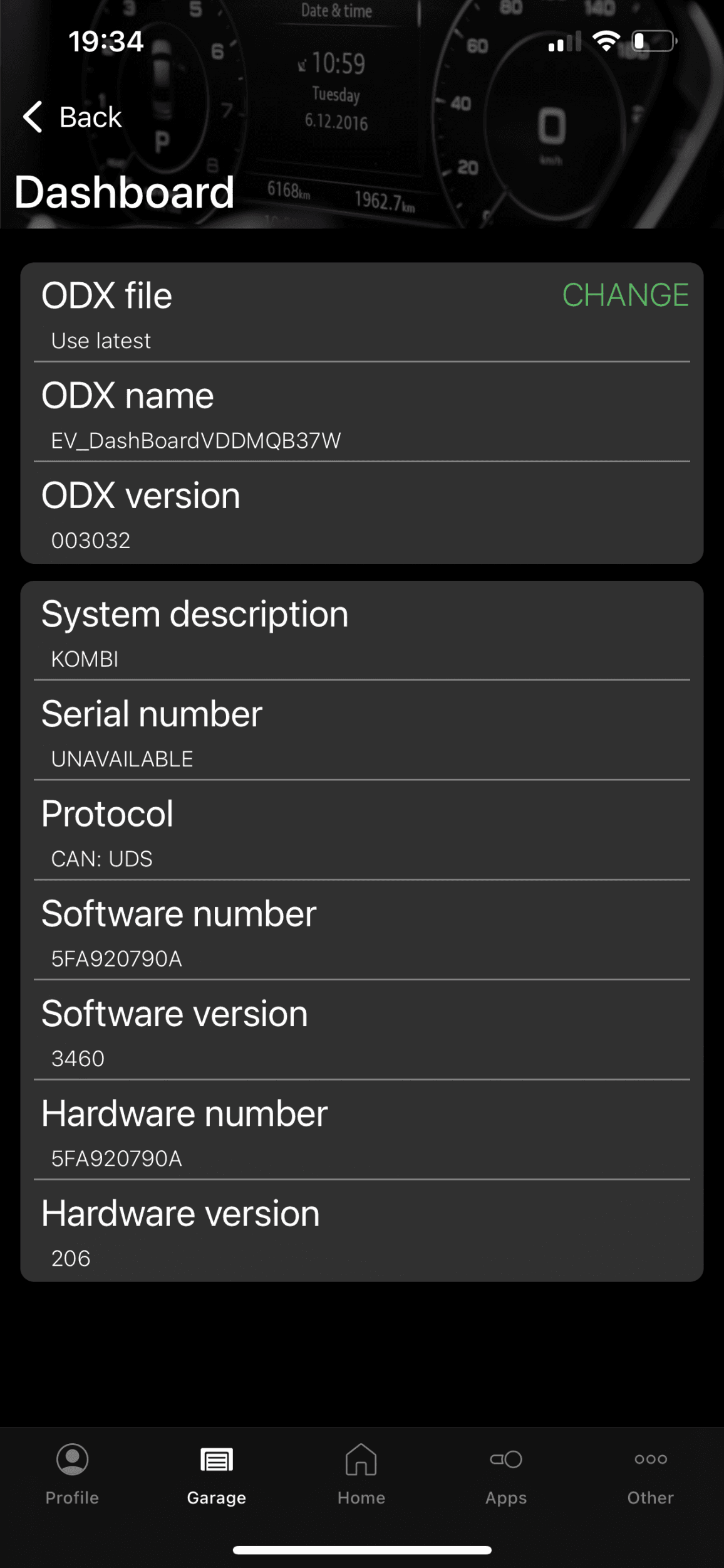

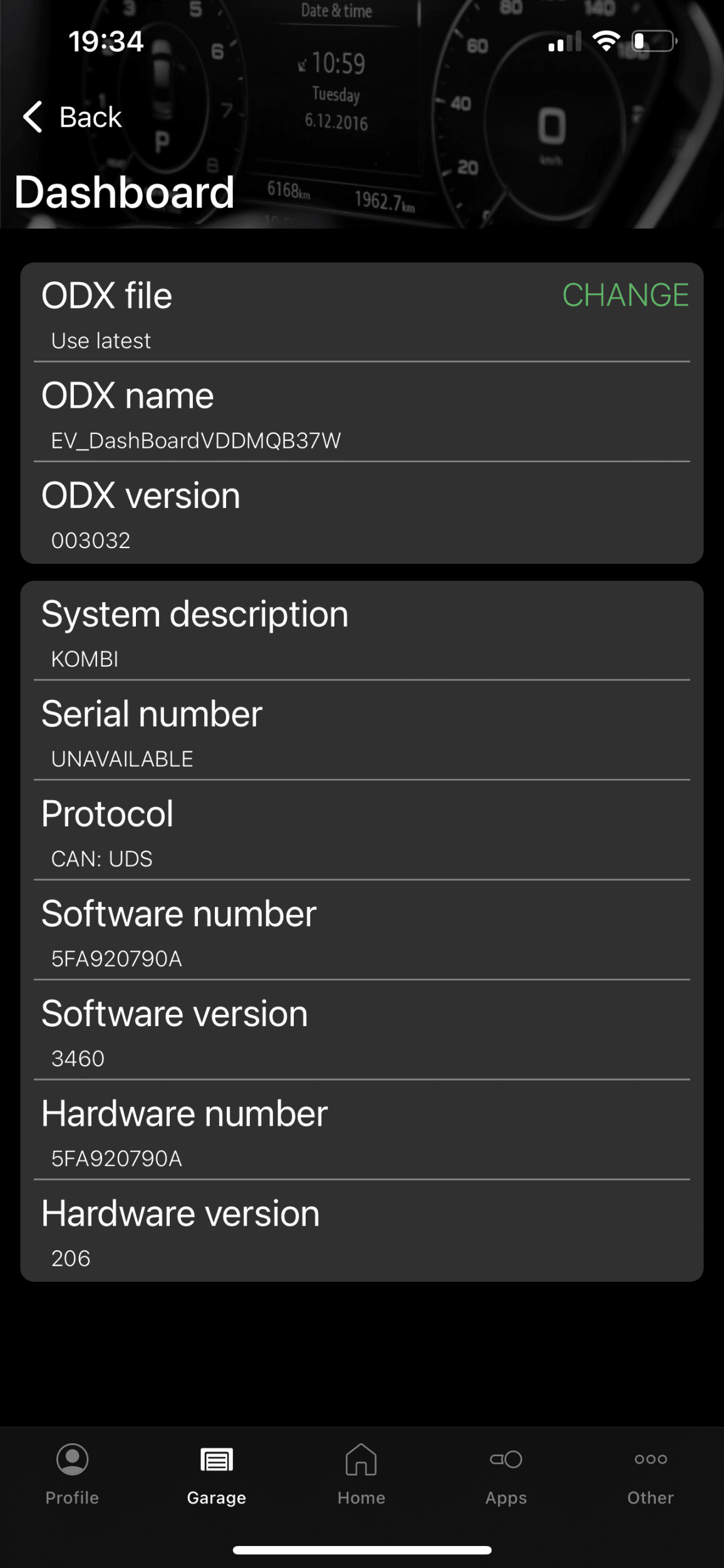

Assuming you got the right security code sharing the info screen shot of Obdeleven dashboard with someone who has it working may throw some light on any differences. Shows version etc.

& you did it with the engine running hood up ?... asked you about the hood up but not engine running.
It's also suppose to have an automated feature of finding these codes. Never tried it thou. Always login in with the published code, then mod, them save, it never asks for it again.

all other coding I make in other units works and the code was there automatic . At 17 not. I try again tomorrow and with engine !

I see this was posted up on the Obdeleven Proboard
tip: in case you get the error when saving -> (31) function not available, change the mode to vw - diagnostic mode, and try again (even if you are already using this mode, just reselect it again)
Are you seeing 31 shown.... if so you could try above.... If after re testing it with the engine running, bonnet up. Think I have seen 31 in the past. But as said I login first in the control unit before making changes then that login gets saved.
The 31 fix might be a red herring thou.
The fault code is 11.
& doing a scan before you mod is useful. Found I normally did that but when I forgot, I couldn't then change things.
See whether other people get this issue on control unit 17 now we know the firmware / hardware that it's on if no other solution is found. Could be that Obdeleven people have to take that one on board, may be rather than its definitely SFD in your latest control unit.

Possible. Still we know that control unit works for others with the Formentor so may be specific to the firmware in the unit you have shown by the screen above (post 25). Needs people to check who have the car.

I assume, print screen above is from Apple app, because it looks different than my Android app and I'm not eve sure how to get similar info from the app/car.
I have the old white with android . The screenshot was from my iPhone . Always work with android because i have years the OBDeleven. First time find this problem .
