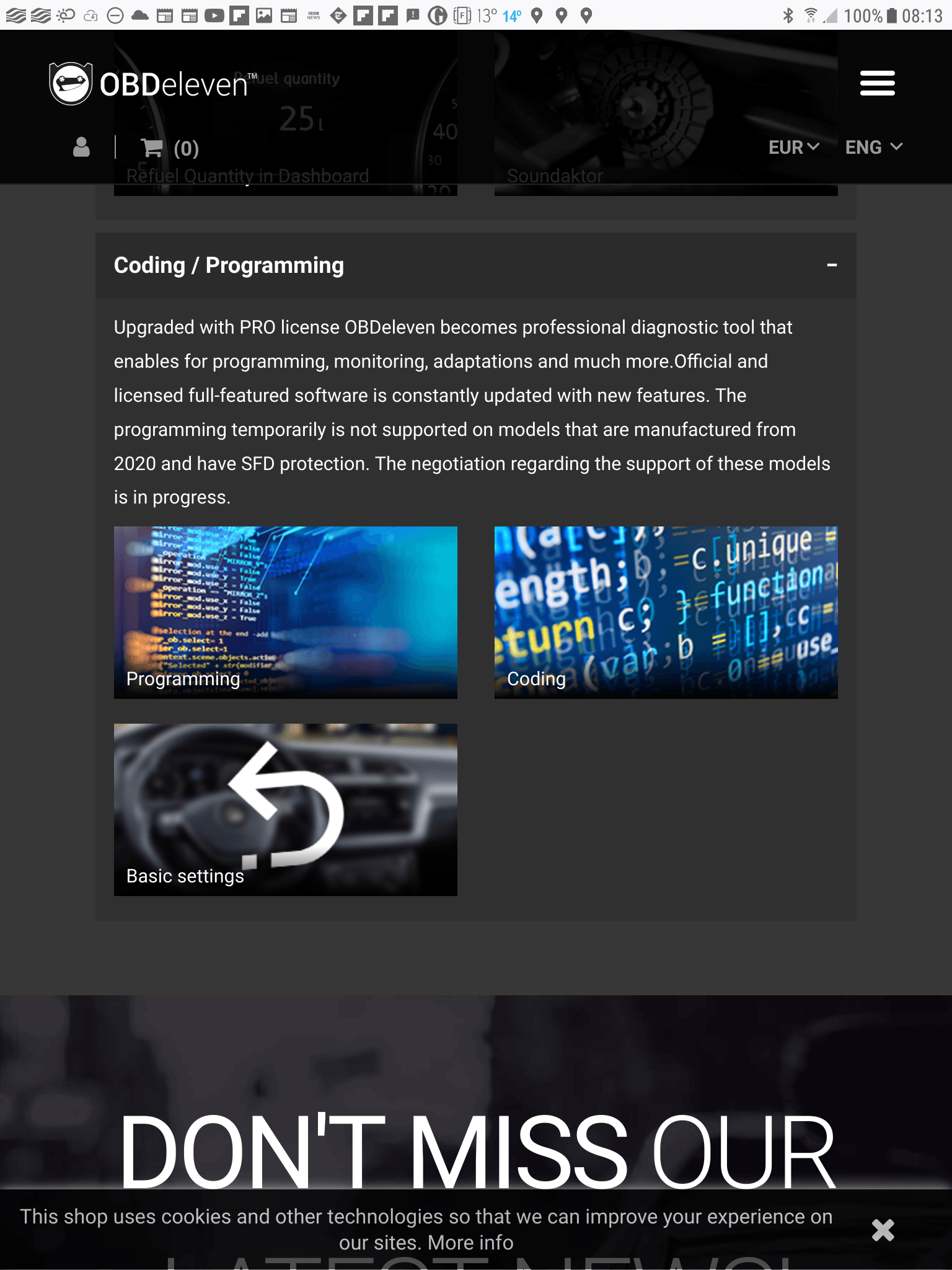

With 2020- VAG models all mods must be done with the bonnet up unlike before and they can currently only be done on non locked down control units (not protected by SFD). The mods were discovered by the VAG community.

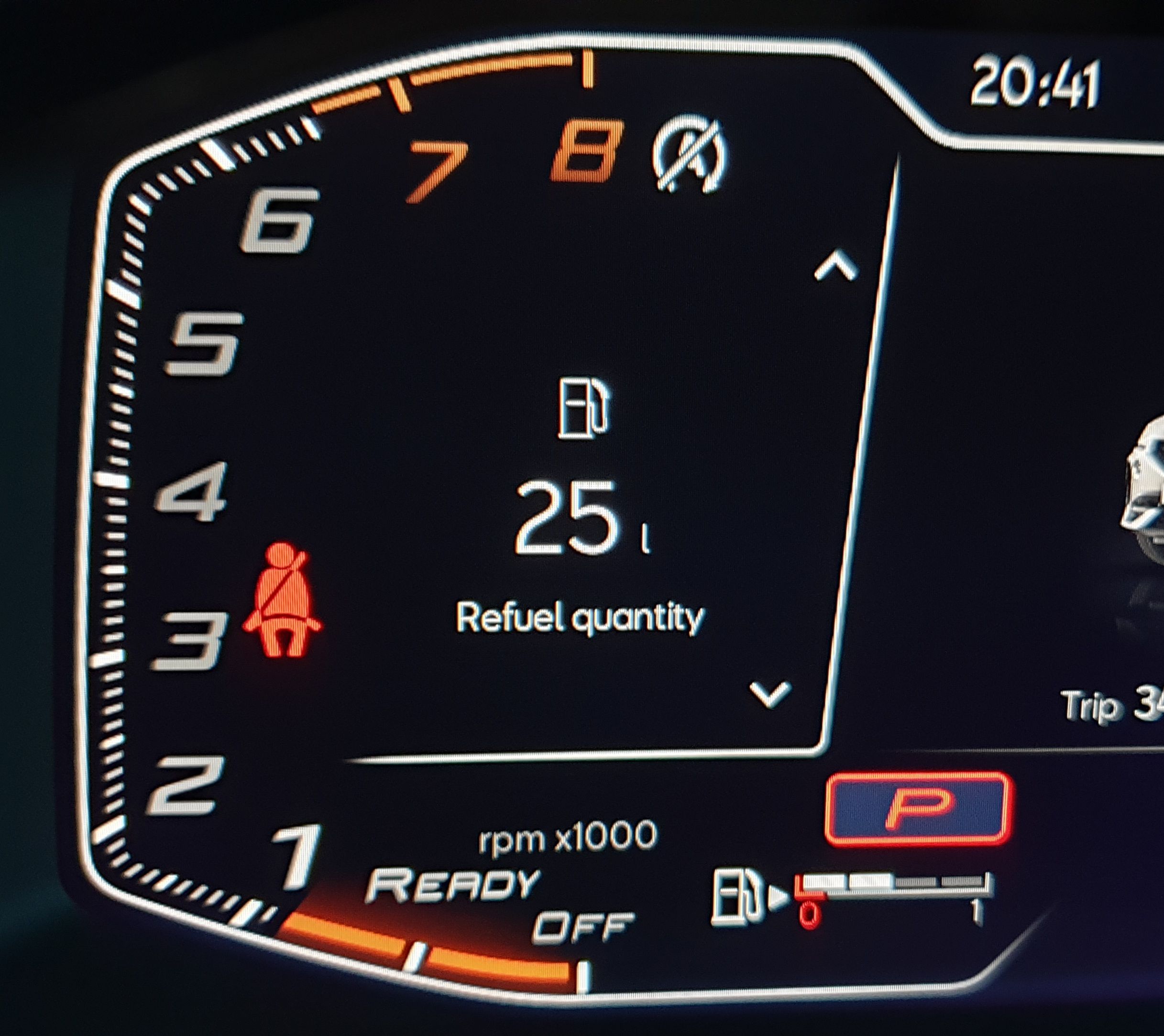

I tested refuel quantity and it's not really useful. It's tied to fuel indicator and changes only by 5l incrementals, when fuel indicator is changing. It's not reading accurate fuel amount from the tank. Car was showing 40 miles range left, refuel quantity was showing 45l, but I was able to top up with 51l of petrol. When I was driving home, refuel quantity didn't change and was showing "--", because fuel indicator was showing full tank. A bit disappointing. I was hoping it's reading data from sensor like Mercedes and will show actual data, not estimated.
4/ Remaining Fuel Quantity thanks to massimo23
1 - Select Control Unit 17 - Instrument panel (Dashboard)
2 - Select Long Coding
3 - Adjust Volume to be replenished: Set to Yes if you want to see it. If you have it and don't want it then change to No
That worked and now I can see in left scrolling panel how many l to refuel, quite like it.

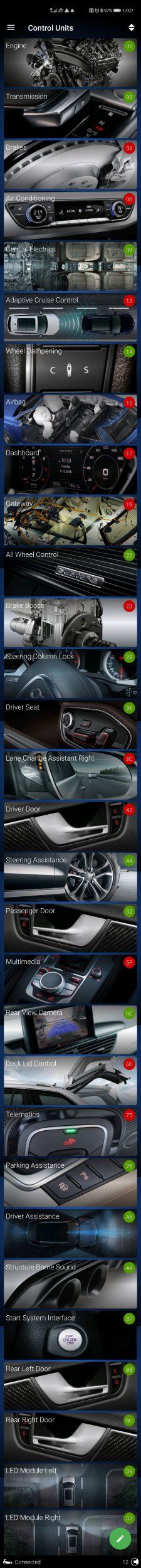

Well, purchased ODB11 dongle yesterday. Delivered today and I've made changes: ACC RH overtaking detection deactivated; Soundaktor reduced from 100% to 50% (seems acceptable); Lane Assist warning and changes per Agnes, so I can turn it off without warning lights on the dash plus it won't come on again when restarting.
Absolute piece of p*ss to do, highly recommended 😉.
PS: I did a scan of the car when it connected and was surprised to find 13 faults, quite a spread. Nothing I've noticed really, but maybe stuff like occasional keyless entry issues etc? Screenshot of the summary below, (quite long!), errors in red. You can open each up to dig into the detail, some are minor, most I don't understand tbh. You can clear them but I'm going to leave them and see what the dealership say when I take it in for a software update or service.

That is where the German forum was grousing where I took that post from. It thought one account with VAG for tokens then they dish them out. Obdeleven implementation will be above board. Their implementation is done without "negotiations" is the gist of how it is done whilst Obdeleven's is with. I see from the Obdeleven web page they have added a couple of their micro payment apps now although you can do all of this currently with the pro license with those posted above plus many more in the non locked down control units.
