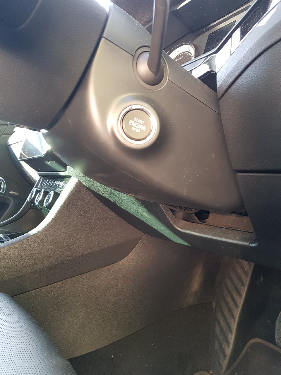

I have a Leon FR ST on '18 plate with KESSY (keyless entry + start)
Well the previous owner (ex-demo car) was a tool! The car doesn't have an ignition barrel, so he obviously got in & tried to find it every time!
Hence:-
Any ideas how to rectify? Looks such a mess when getting in to the car...

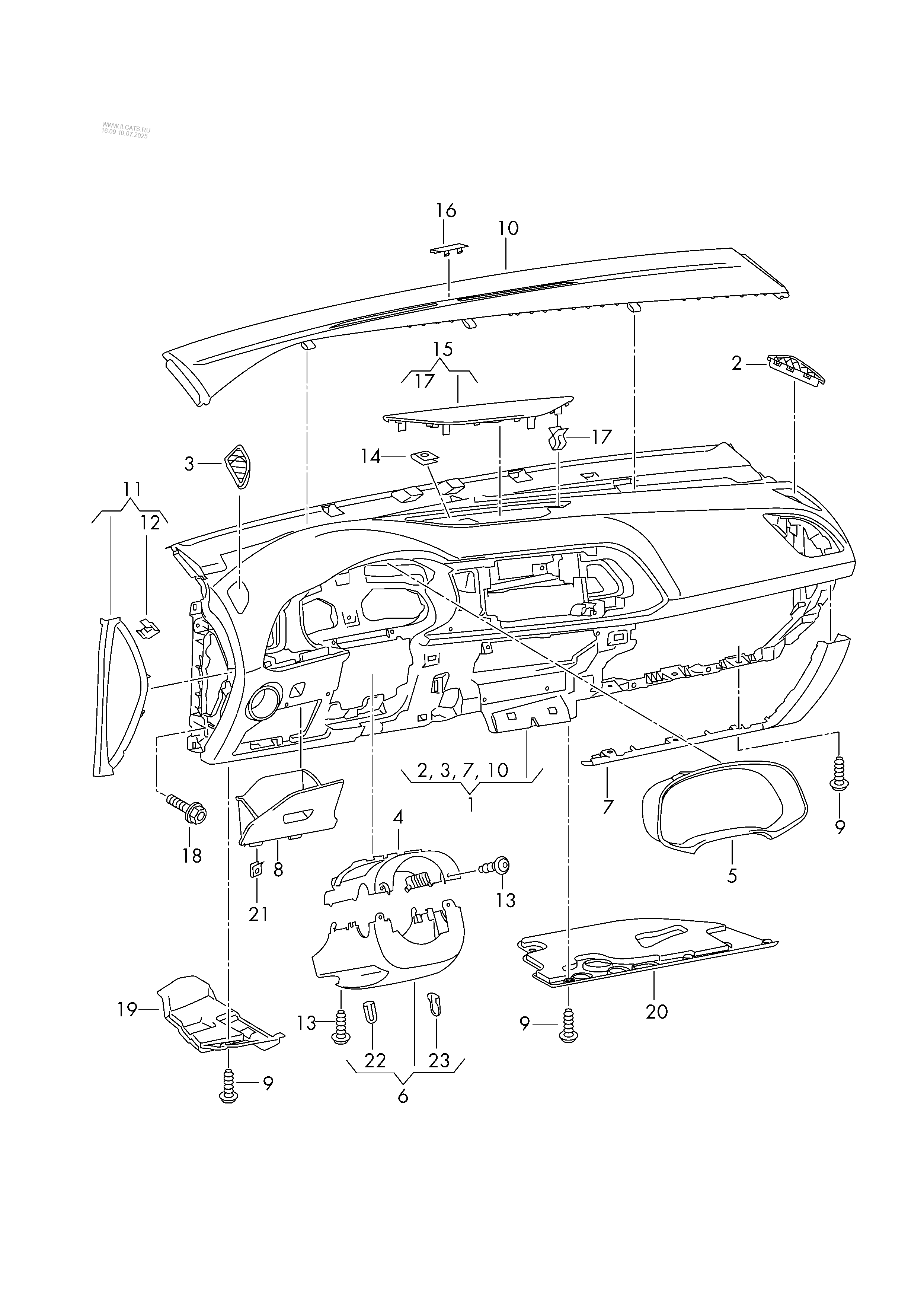

Anyone got the faintest idea where I can find a part number for that? Is there an exploded diagram of the steering column with part numbers floating around?
Wow that's a minefield!
I 'think' I need a 575858559G
If anyone can confirm or otherwise I'd be glad!
I have seen some people get good results with the gentle application of a heat gun.Plenty of Youtube vids on this.
Thanks @Dizz I'll take a look
