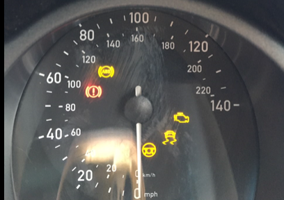

Folks I need help on this... The image below was take a 30 mph as you can see the Speedo is at zero and all these warning lights are on....the Interior light is also flickering and there seems to be an issue with the boot not unlocking via the internal switch..phew
Up until yesterday It was only the ESP light and ABS light that had been on intermittently for about a week
Now all below are on All of the time (and the internal light flickers). they wont go out at all

If the lights are flickering, sounds like an electrical fault. Battery / alternator on it's way out? Or something cause a short in the wiring. I'd have a check round for any burnt or stray wiring. Test the battery / alternator and failing that get it scanned for codes.

I took the car to an auto electrician, he is telling me that after his investigation its 100% the ABS Pump /ECU ...so looks like a hefty repair bill unless I can find the correct one at a good price
