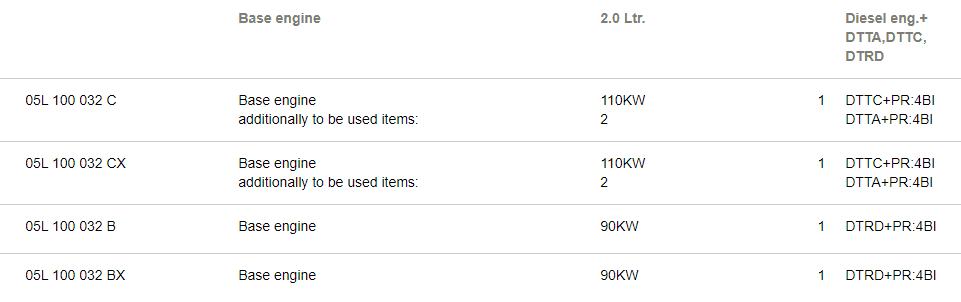

Well there are different base engine part numbers between both power outputs! with over £700 increase in price for the higher power base engine.
Though crank, pistons and cams are the same - probably the block has different/additional features?
Different flywheel and clutch, different turbo.
Having said that - I can see chip tuning company listing the same power/torque increase for both 115 & 150 versions! upto 195 and 430Nm!
