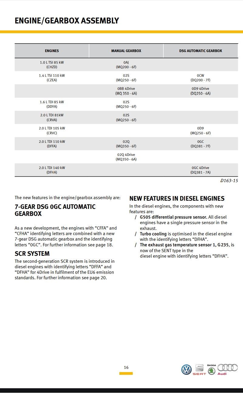

Yes the launch 1.6 tdi back in 2016 didn't have SCR so somewhere along the line they fitted it. That was the selling point then for people frightened with SCR take the 1.6 over the 2.0. It was cheaper. No adblue was required but they didn't advertise that with the 2.0. There was campaign against SCR, Honest John and all that.
Tell
Full Member
The launch engines in 2016 on the Atecas since I left it a bit hanging plus the gear box fitted.
