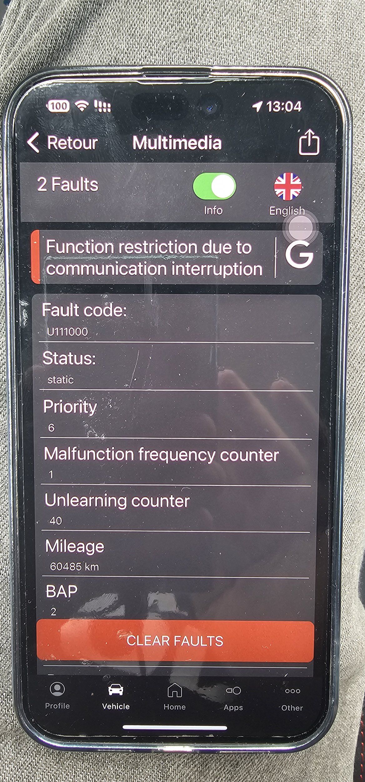

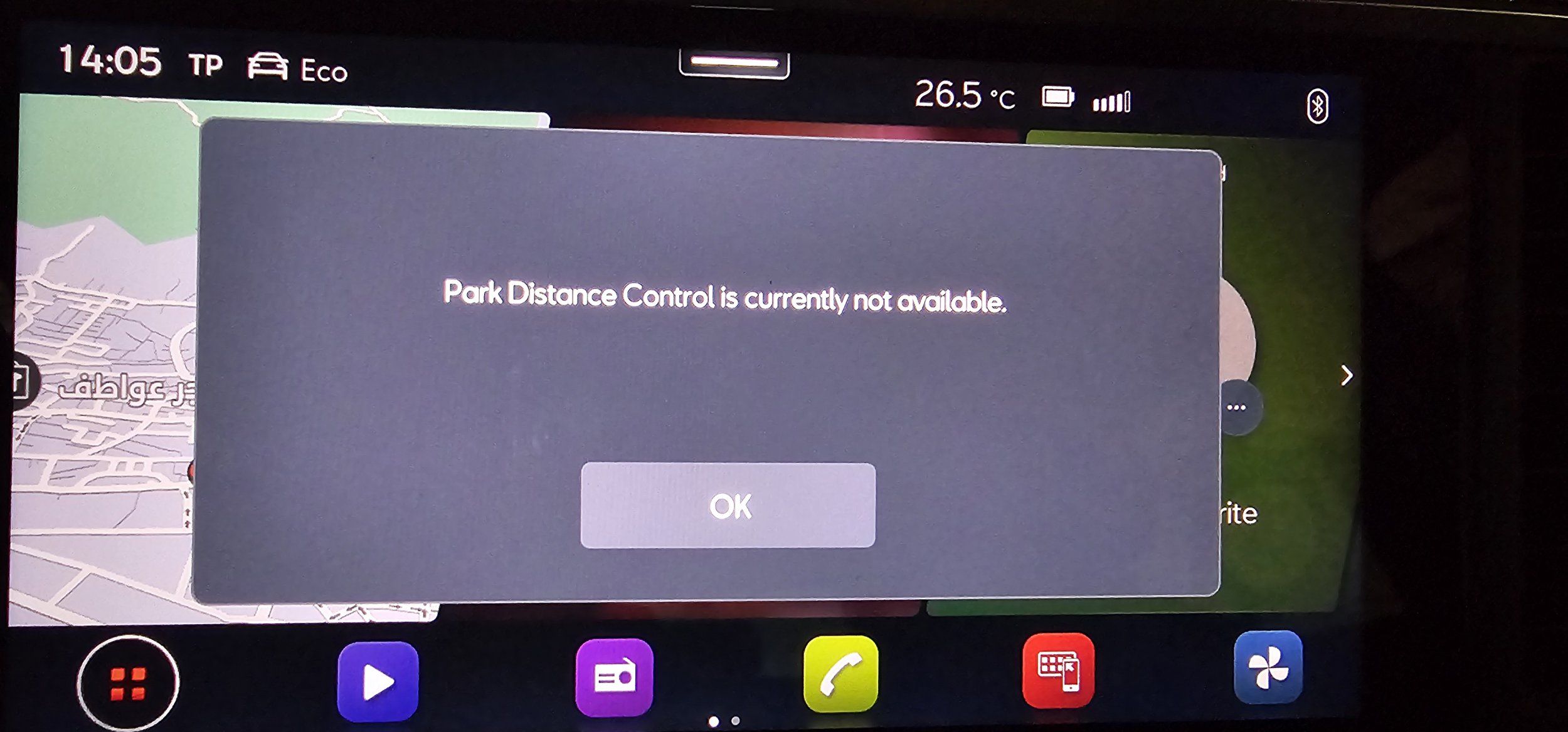

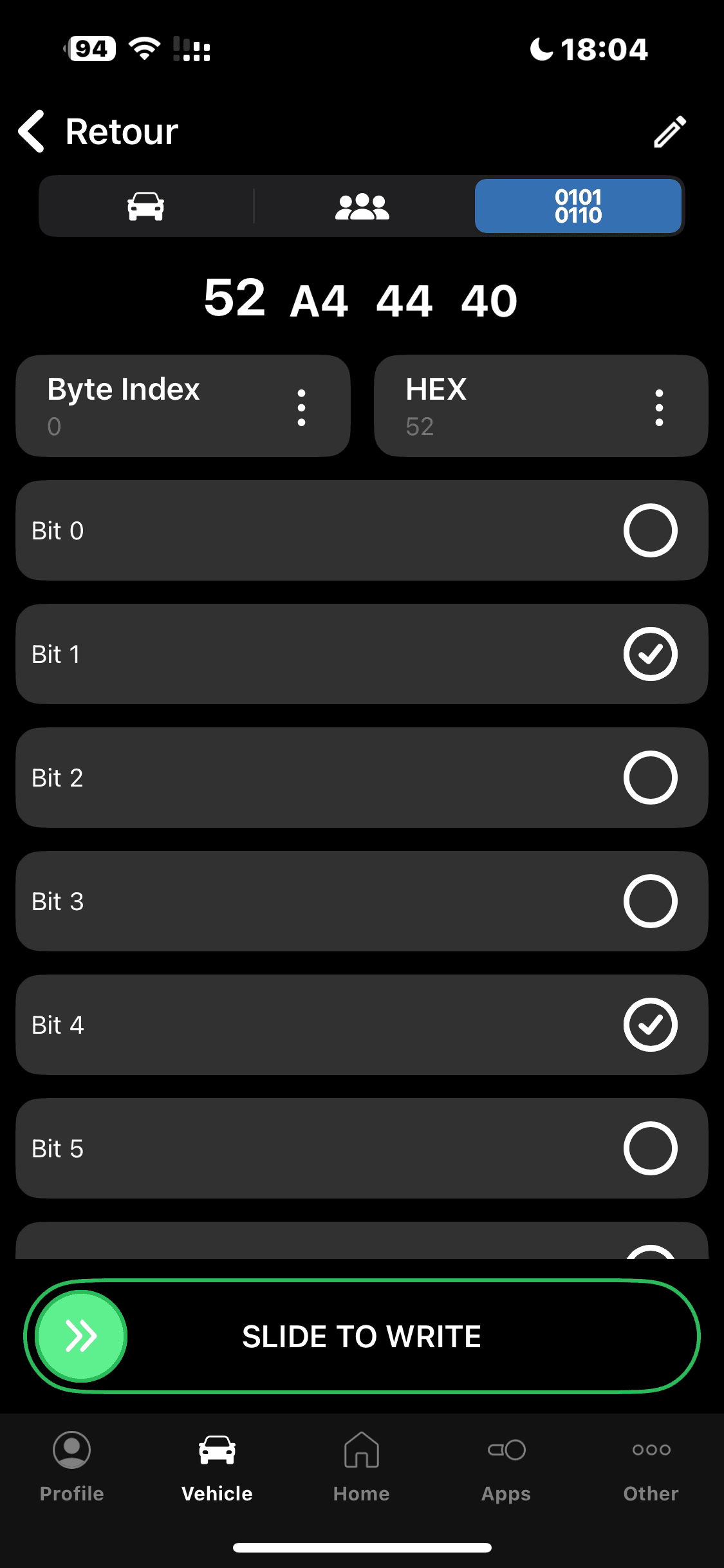

Hello, I have a Seat Ateca Fr 2021 for those who have a backup copy obdeleven - long coding - Adaptation,
Noting that the car has Pack Assist - view 360-lane Assist-Lane Change Assist-Boite automatic.
Thank you.

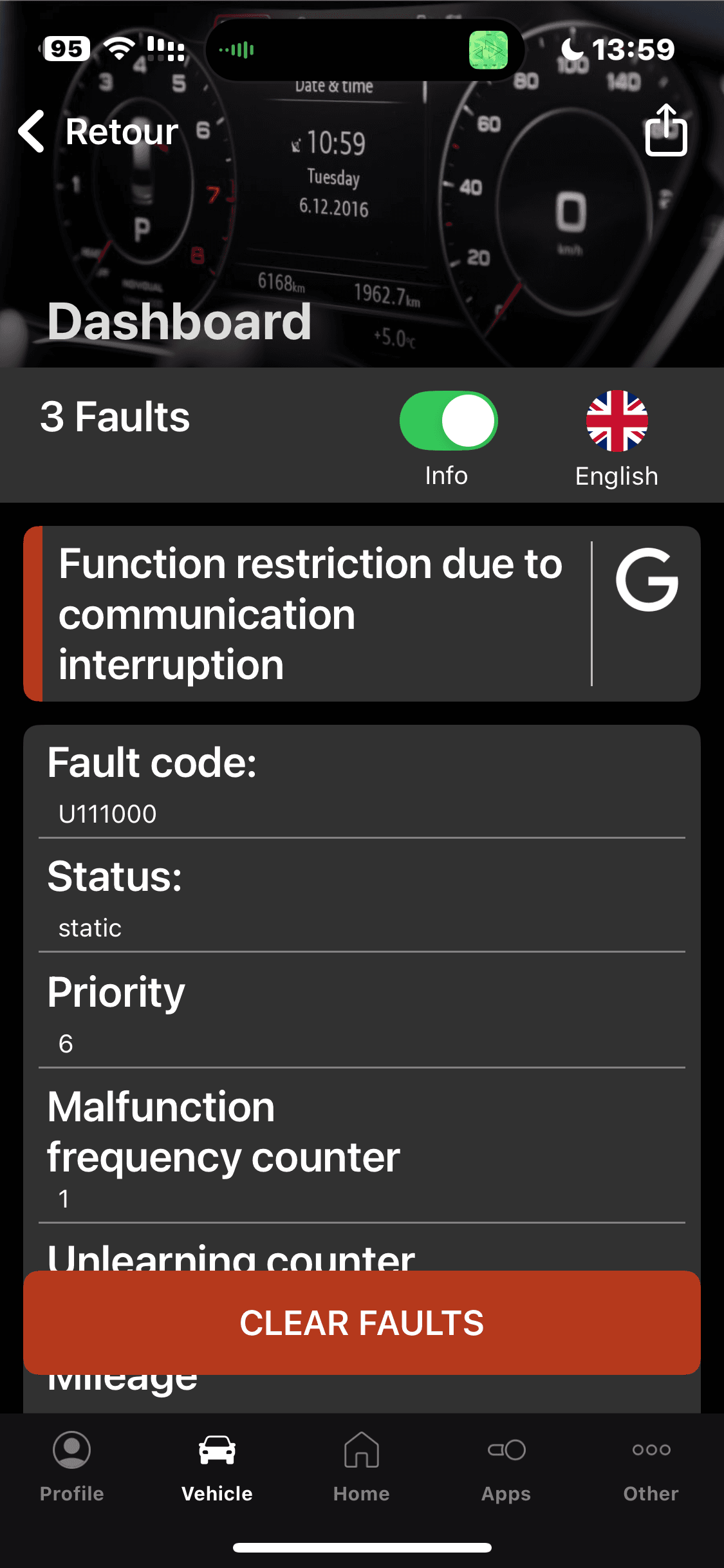

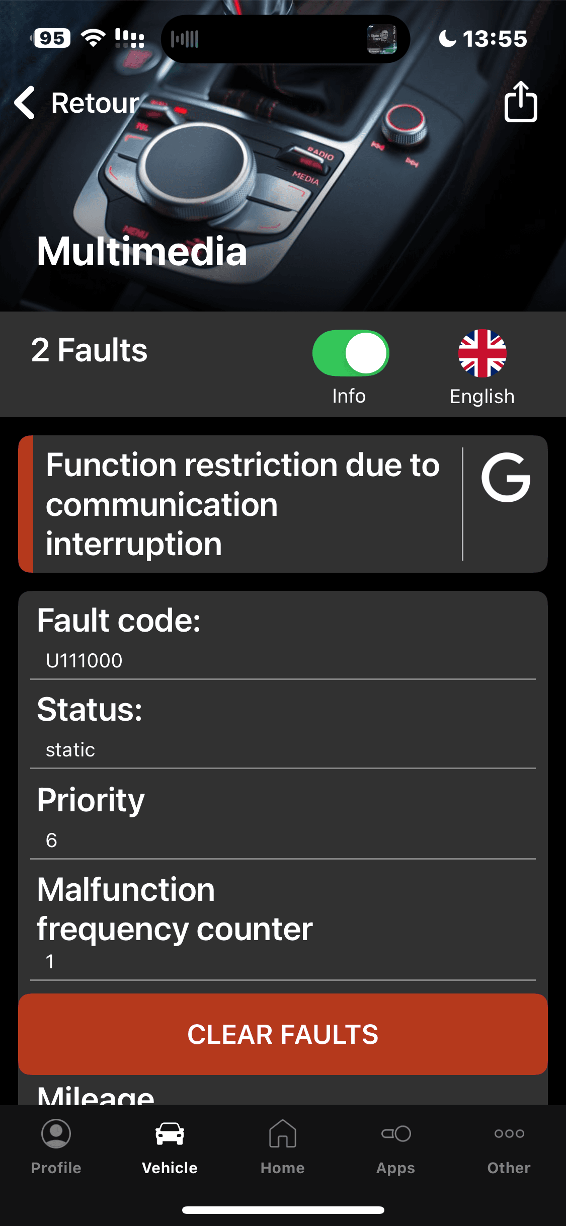

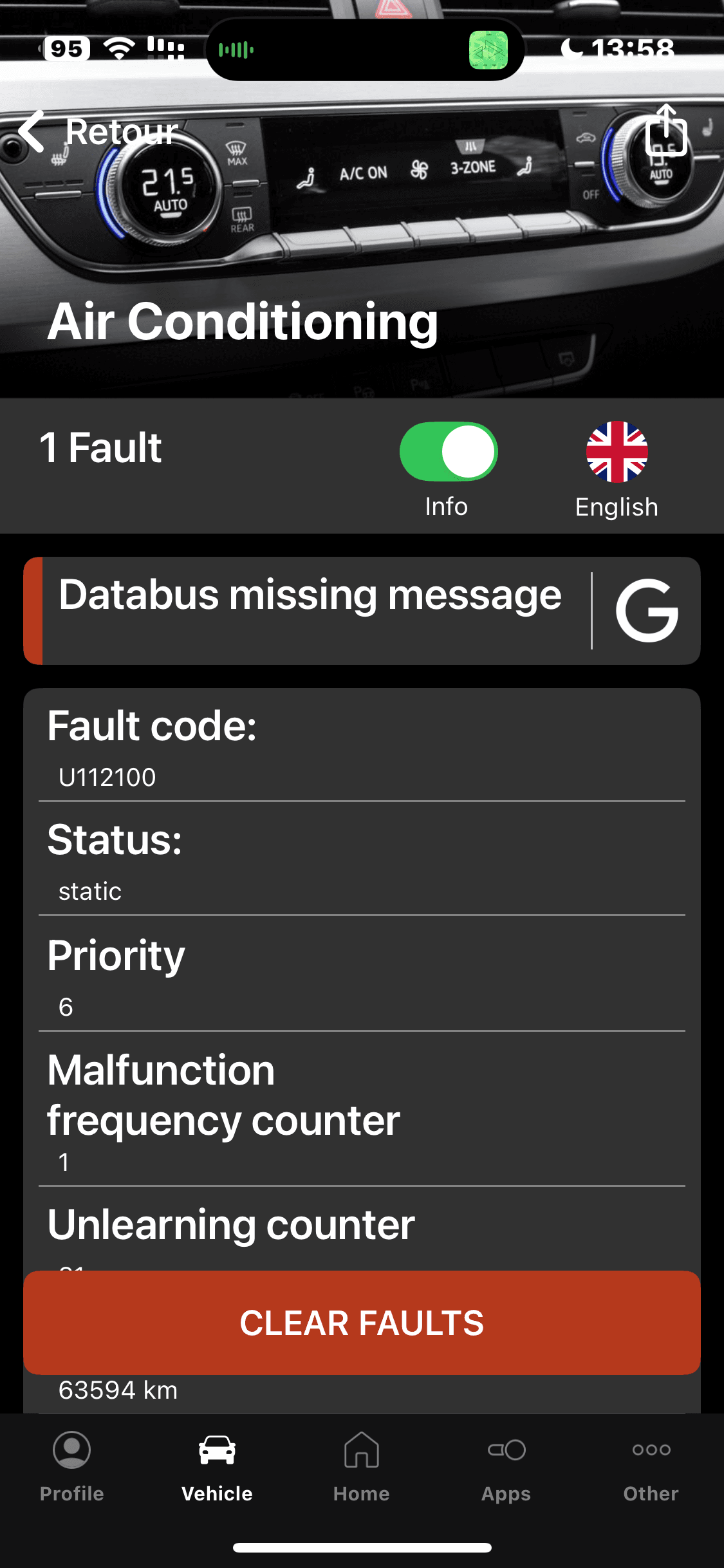

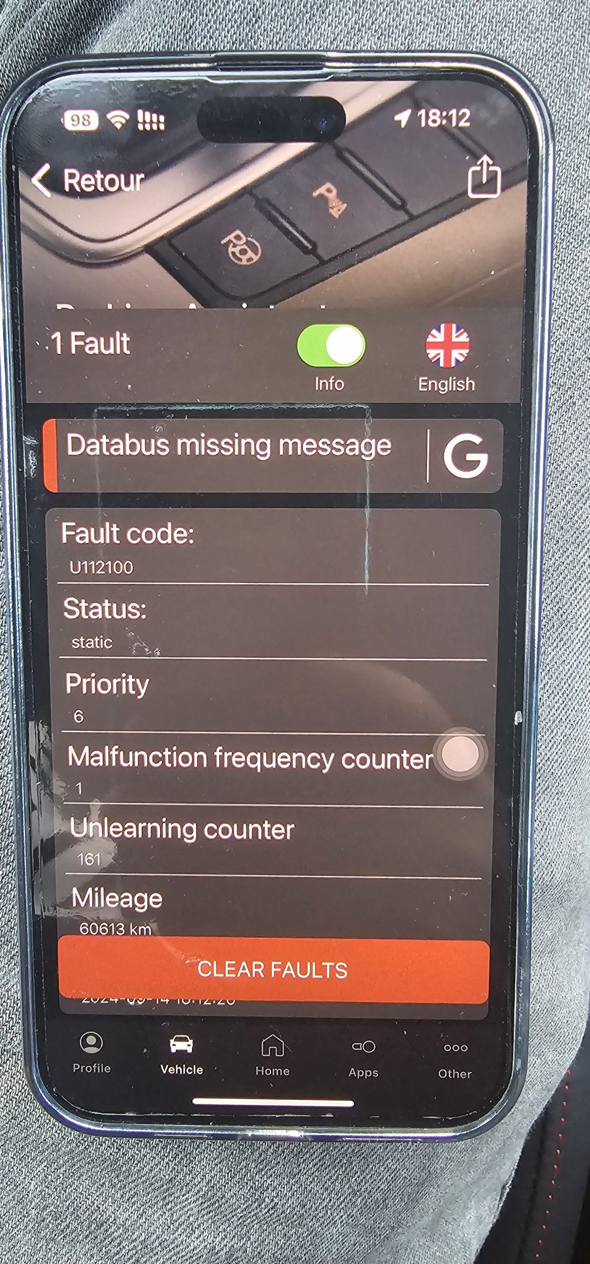

A set of errors

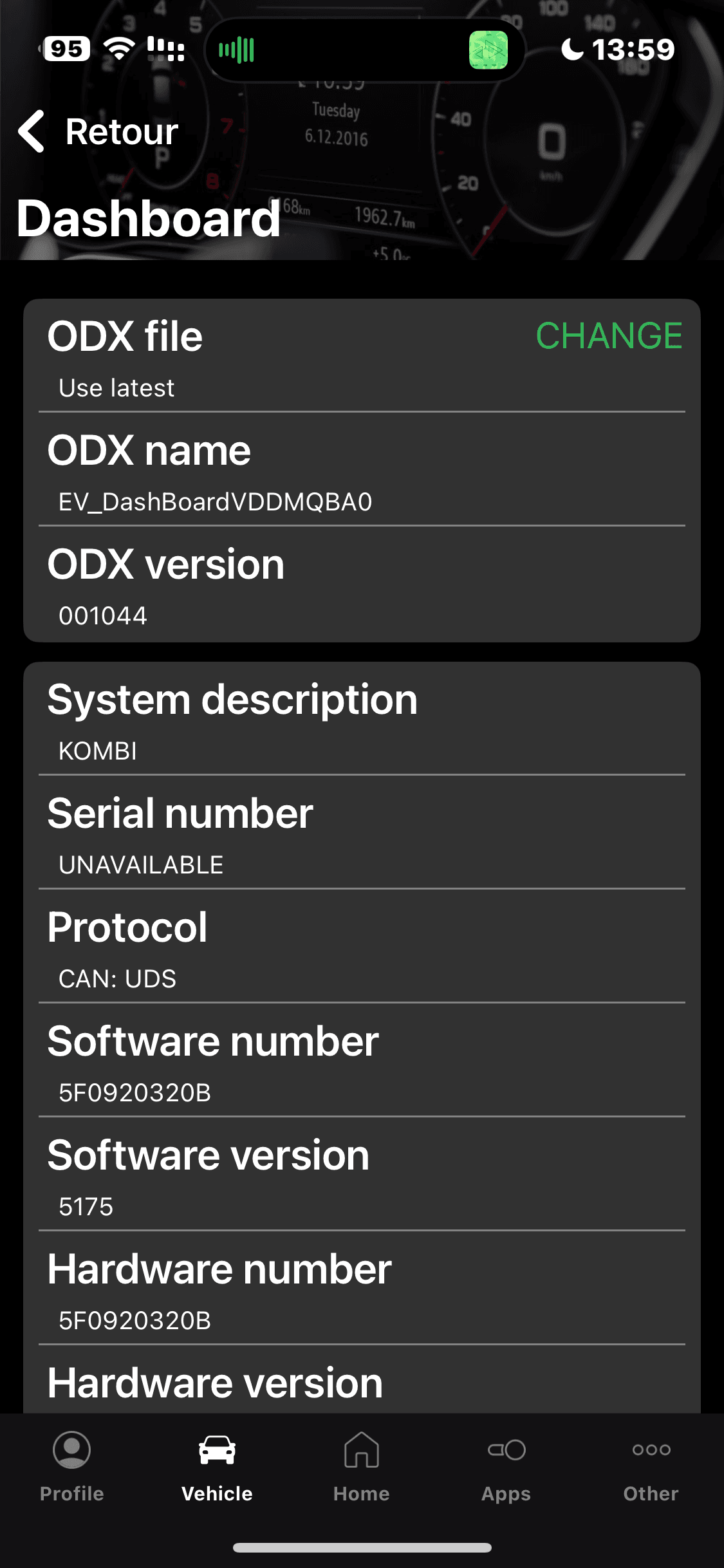

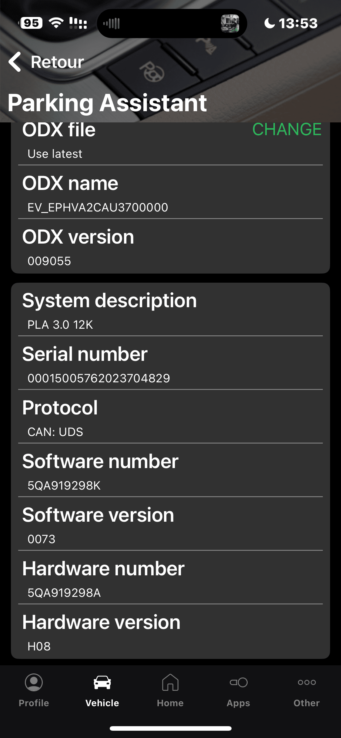

My vehicle is Ateca 2021 FR. If you want, I can add a copy of the Long coding and Adaptation channels of the 76 module Park Assist 12k PDC 5QA919298K and 5F0 907 044 AS for Air and here so you can compare them accordingly. Thank you
you only have errors in the PDC control unit and 5F? yes please share your coding and hardware number software number and versions of both

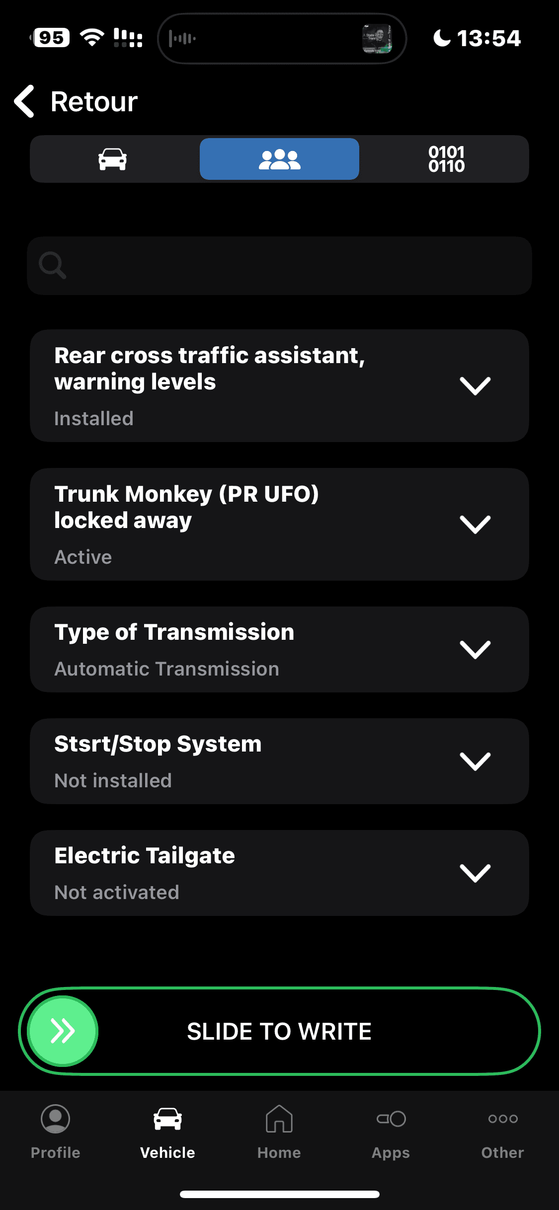

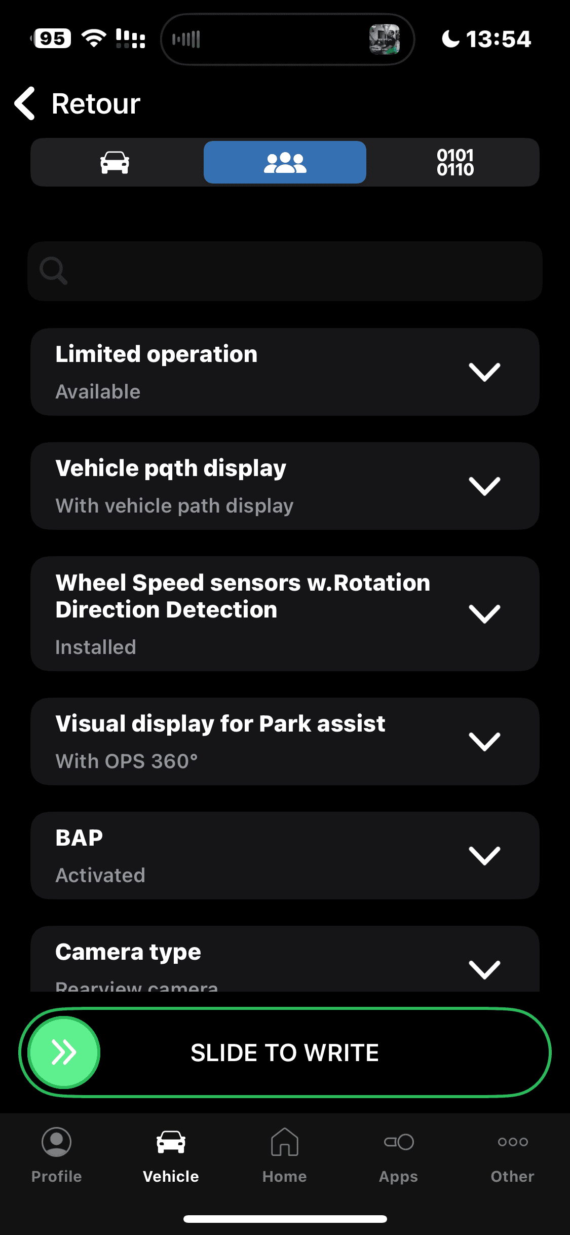

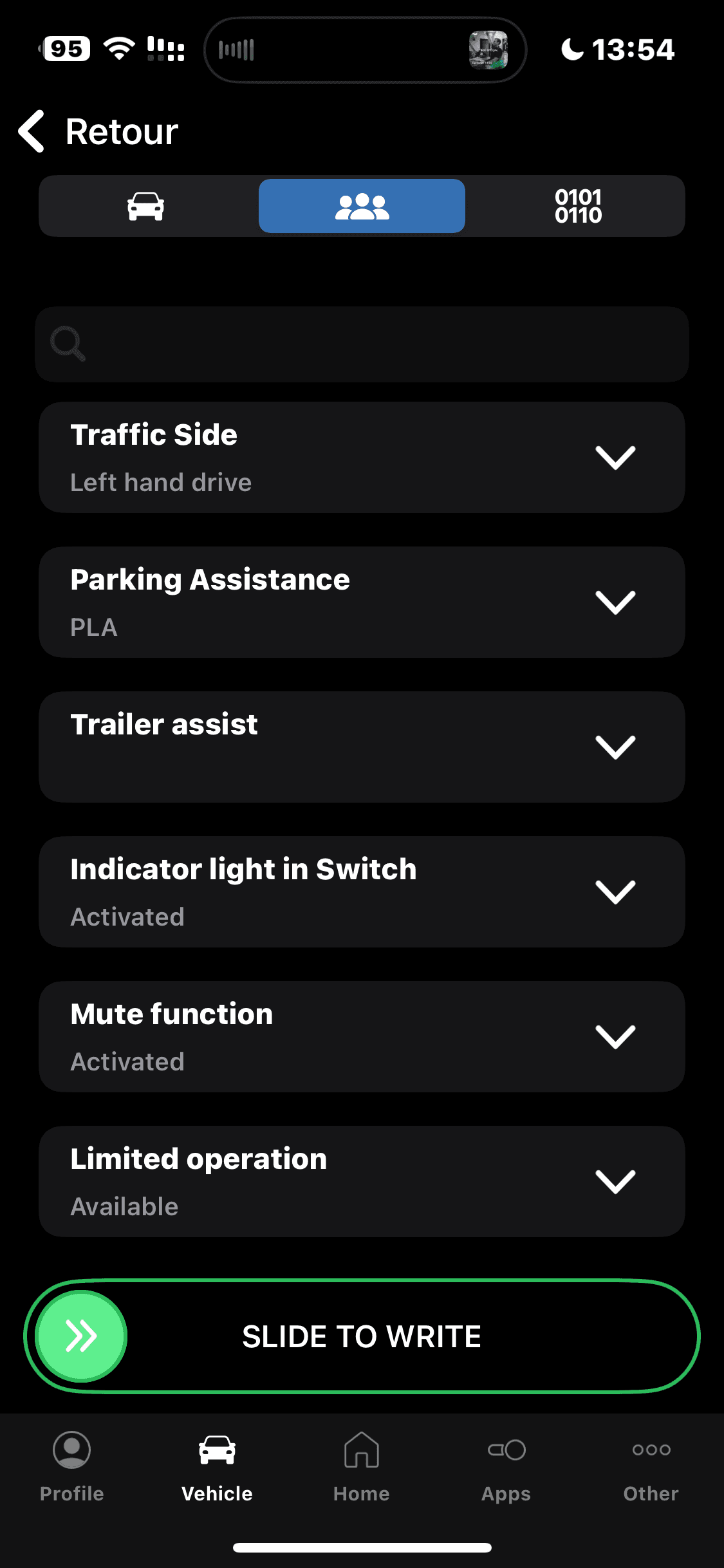

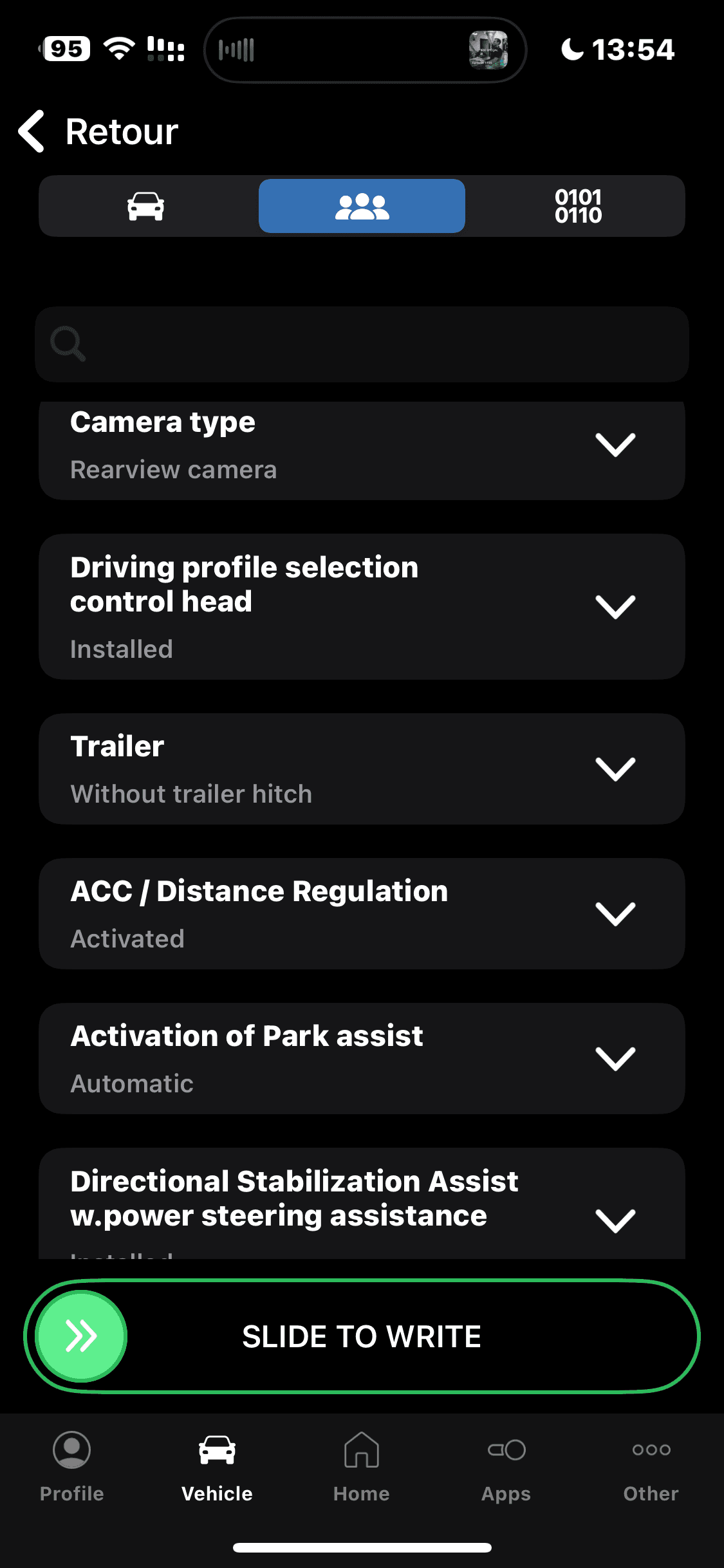

Please label the pictures or write plain text in the post HW SW CODING etc. Now it's confusing... what I noticed is why does it say reversing camera in the PDC and not surrounding reversing camera? Your calibration will probably be gone too.
Reactions: sasa24

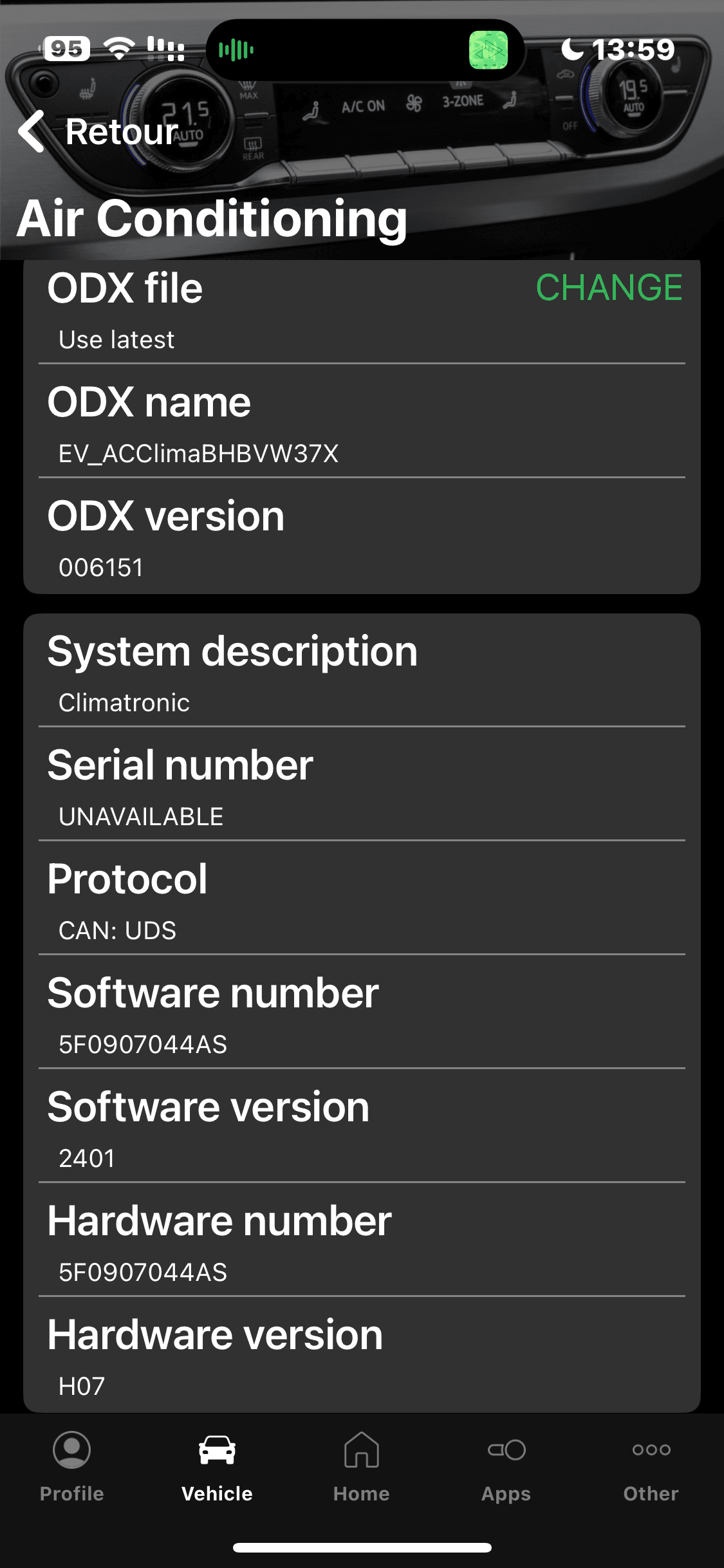

Please write the data manually in the post, for example:
STG 76
HW Number:
HW Version:
SW Number:
SW Version:
Codierung:
Reactions: sasa24

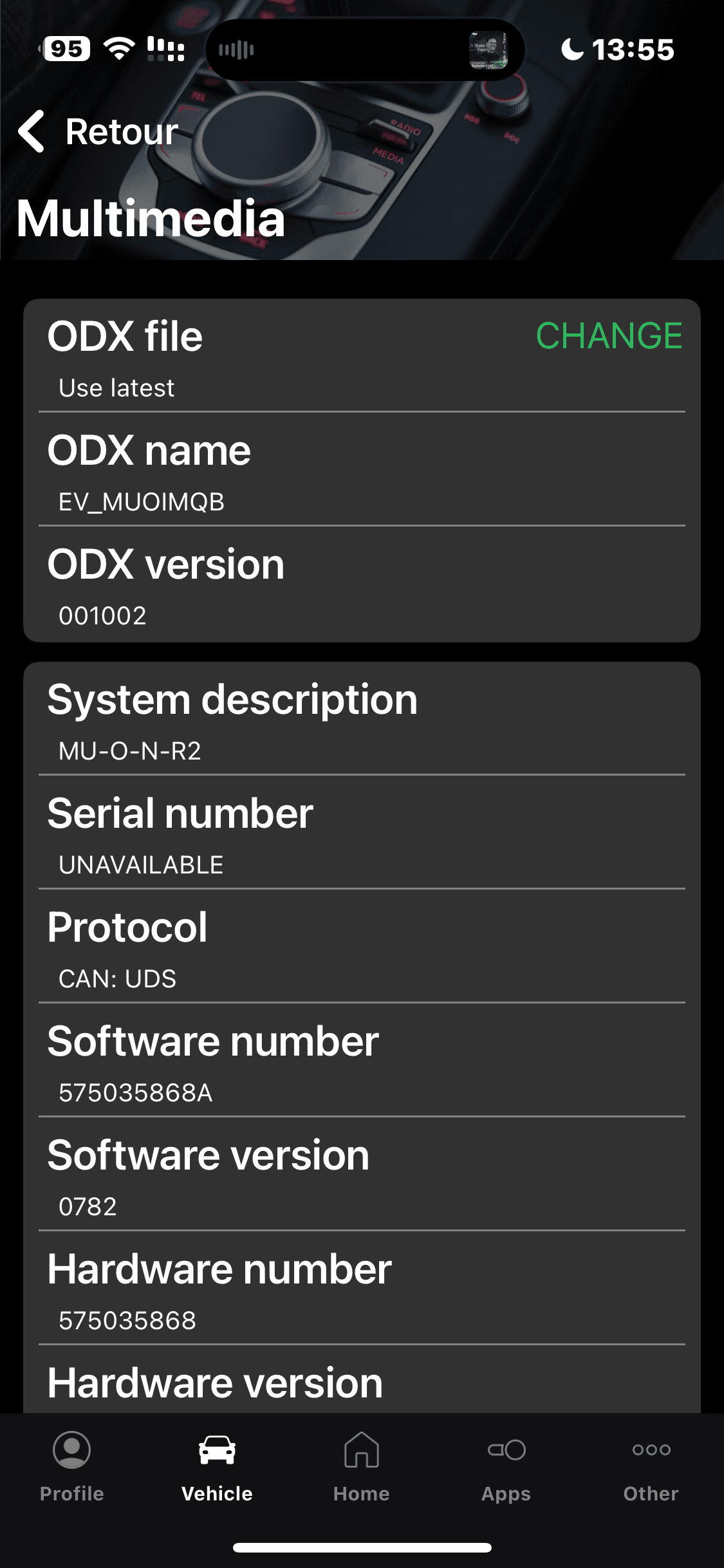

Is the vehicle reputable? Because the serial number is missing on the STG 08 and 5F. That is unusual. Try setting the rear view camera to the surroundings in the STG 76
Reactions: sasa24

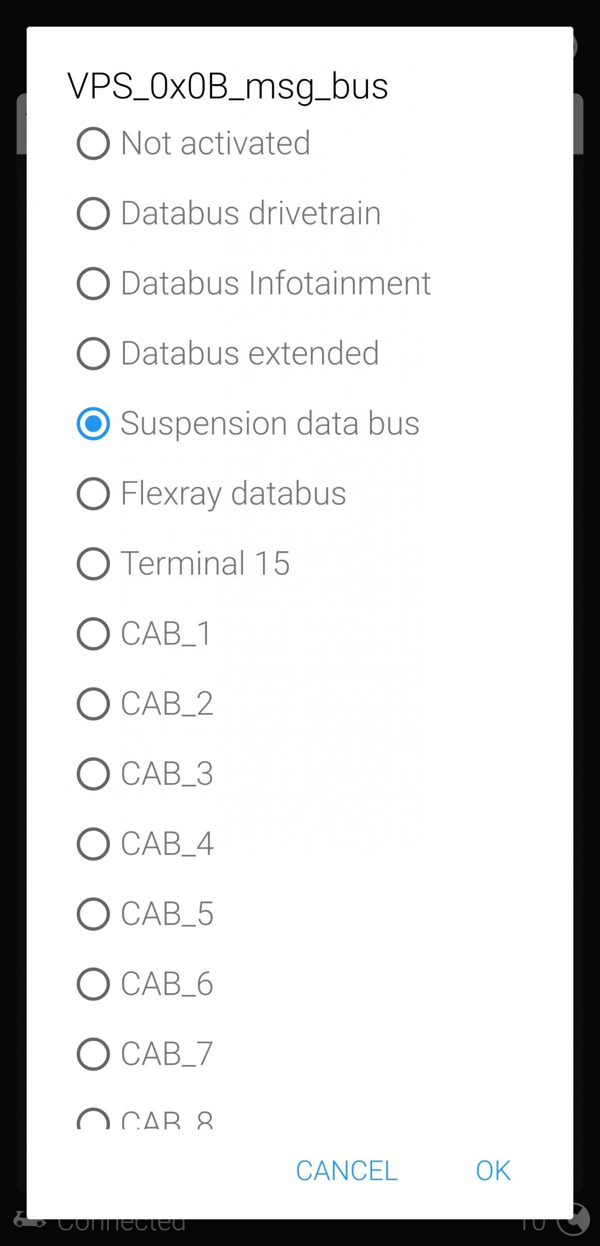

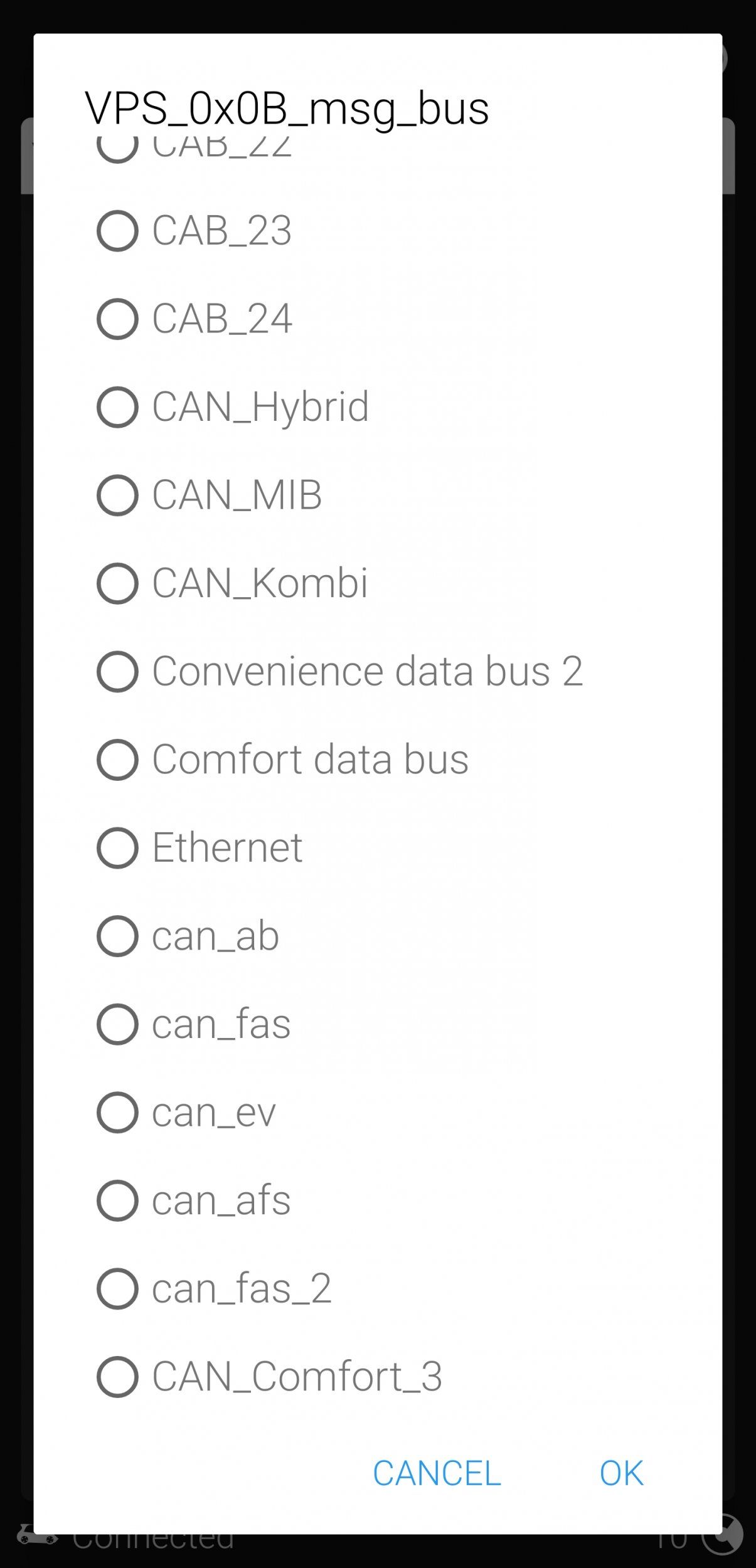

ENG122229-ENG117712-Car_Function_List_BAP_Gen2-VPS_0x0B,aktiviert
ENG122229-ENG117713-Car_Function_List_BAP_Gen2-VPS_0x0B_msg_bus, Fahrwerk
Reactions: sasa24
Fahnwerk ???
