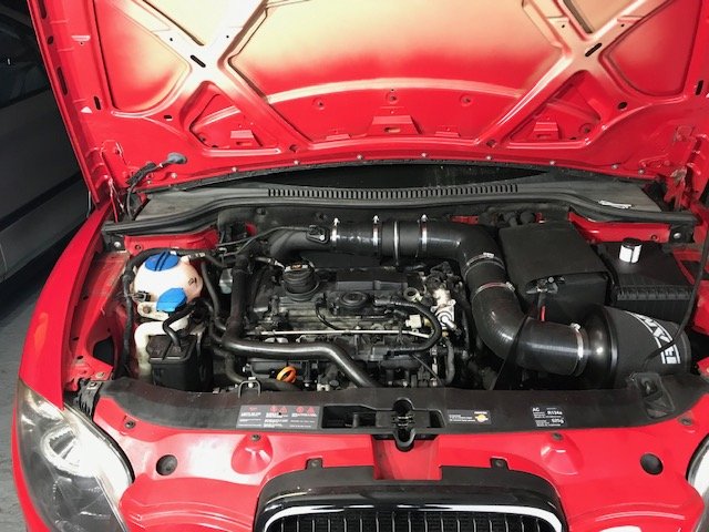

I was looking at different induction kits, was going to go for the Revo one but ended up purchasing the Ramair instead. After fitting the induction kit I had a drive to one of the families house and had a good run around his land, didn't realize how quick the Cupra was and how much it pulled, after 4-5K rpm it seemed to start pulling away from the 350Z.. but the SEAT couldn't beat the sound coming from the Nissan. Below are some photos from the day out..
index.php
index.php
Recently purchased a down pipe and de-cat, just waiting for the better weather to fit it, I'm also wanting to go stage 2. How much does this transform the car?

How did you find the Ramair kit with regards to noise inside the car as i've heard it's slightly noisier than the revo etc...

The Ramair is quite noisy but it gives you a smile when the turbo starts spooling and the car sounds like it's from the Fast and the Furious, but I have taken the sound proofing out of the bonnet that I will be putting back now.. :)
