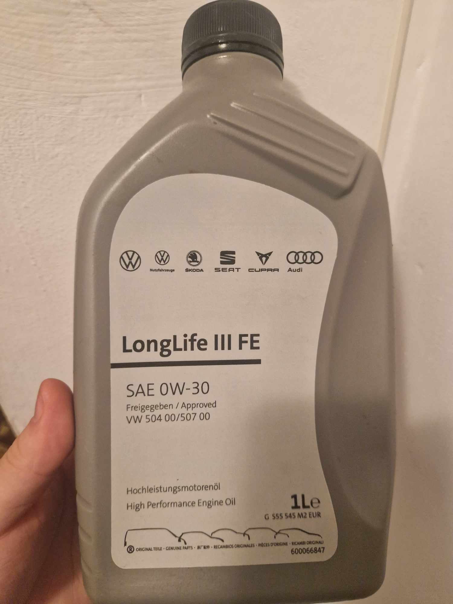

I use LongLife III FE.
Sae 0W-30 VW 504 00 /507 00
I found the info on the manual of the car and also confirmed with the mecanic.
Changed oil 2 times with this, had no problems with it, the engine runs well.
