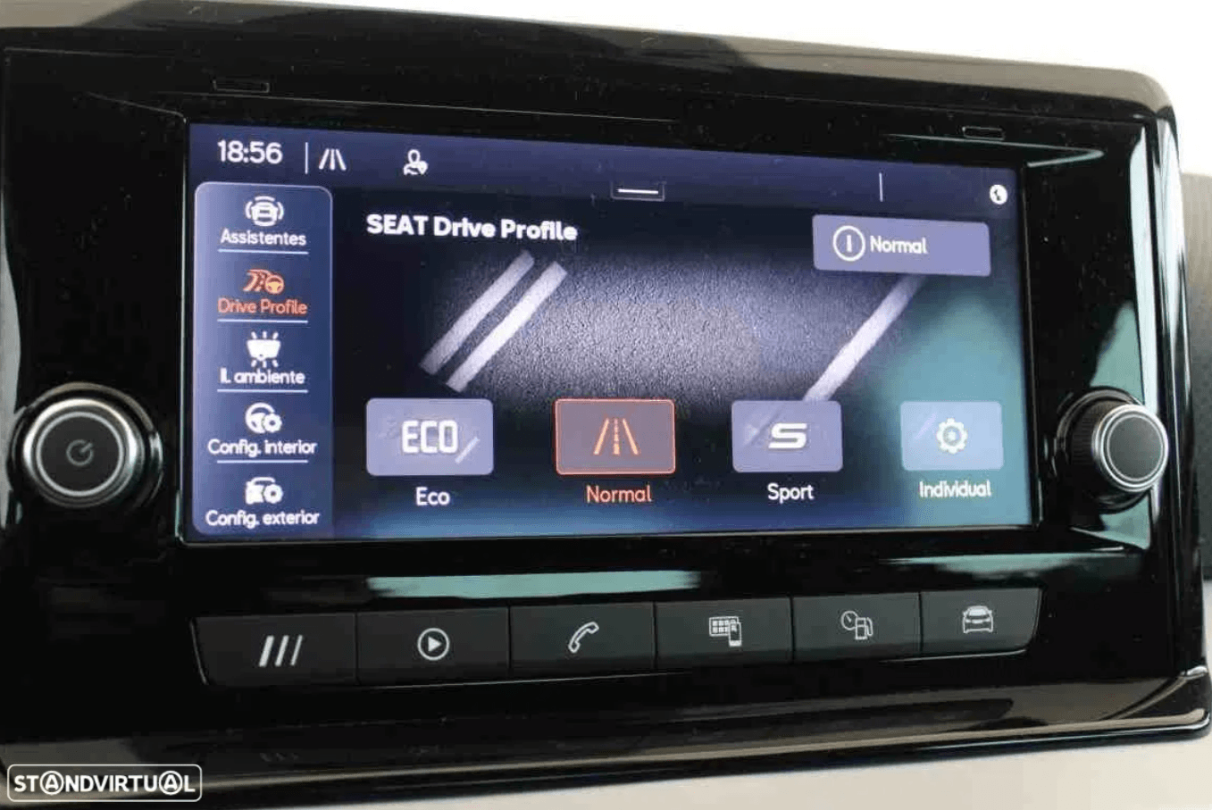

Unfortunately the service menu won't open. I hold the button with the 3 slashes and nothing shows up. Button works fine. Is there maybe a different way in my model?
Post a pic of your whole system, showing all the buttons

Can you try and press and hold the most right button (Car).
Useally it is the menu button. But that doesnt seems to work
Verstuurd vanaf mijn 2112123AG met Tapatalk
I've tried holding every single button for 10-15 seconds and none of them brought up the service menu, I'm afraid. I also cannot find a single YouTube video of this specific radio opening up the service menu, it's always the one without physical buttons. I'm at a loss here. I really wanted to get this sorted.
Just want to give a brief update.
I managed to access the service menu by holding the car button as suggested by RCupra. I swear I held every button last time I was in the car to try and figure out which one brought the service menu and none of them worked, but I must have missed this one somehow.
Anyway, service menu opened, I updated the firmware with 1800 and everything is working smoothly as of now. I will test for the following weeks to see if the issues I was having before with Wi-Fi are gone.
Thanks a lot to RCupra for his guidance and I hope this helps people with the same model that are trying to update their car and weren't able to find how since information for these models are pretty scarce online at the moment.
