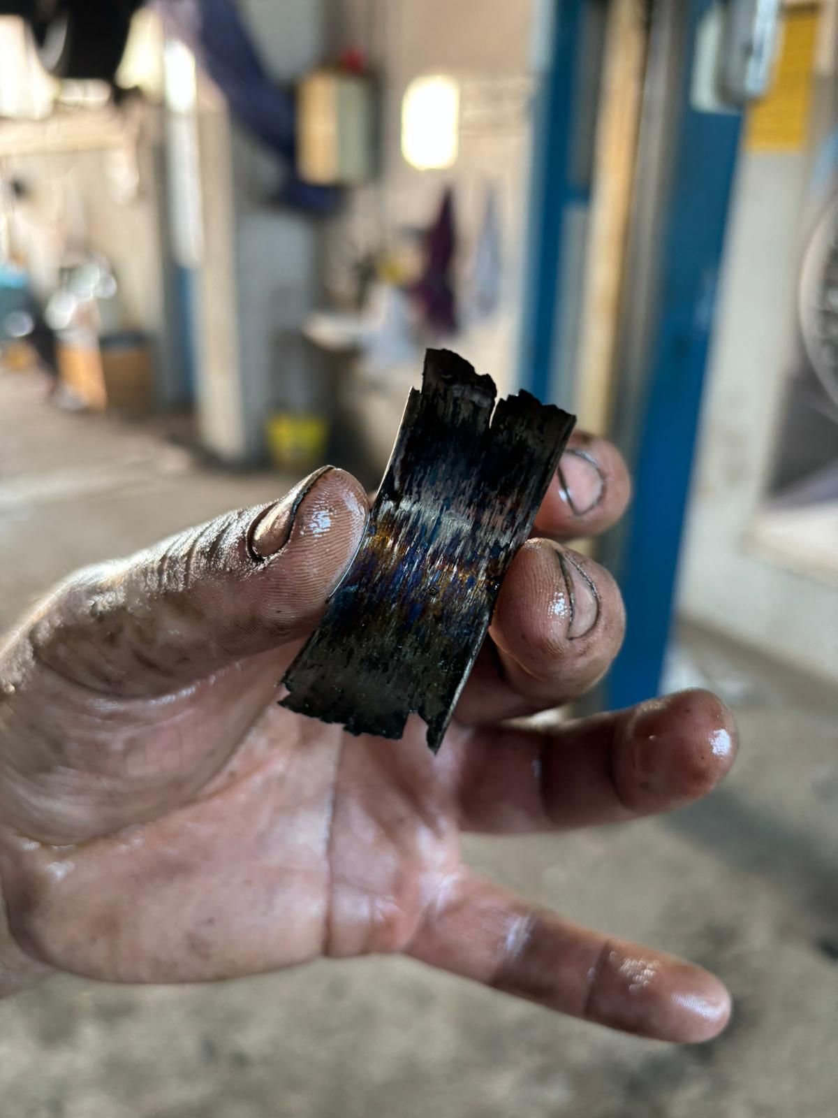

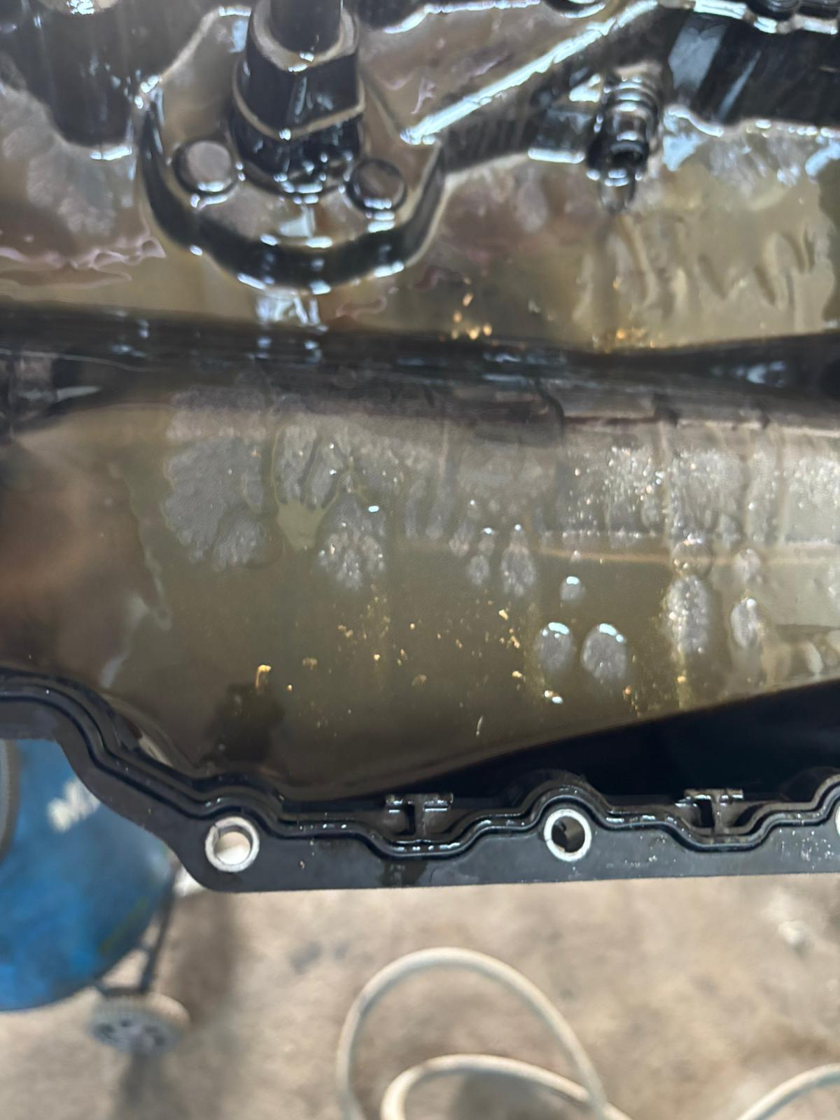

Hello, i dont know if that topic was already here, but i have the problem with rattle sound, i think its from the top of the engine. Car is quiet at idle, but as soon as u press accelerator it rattle at the top of the engine.
I am afraid that this is bad/broken piston, but want to hear did someone had same issue?
I am going to rebuild whole engine, would get forged crankshaft probably , bcz i have bigger turbo, injen intake, scorpion exhaust and downpipe...
Yeah, there is a lot of metal in there.

I have seen this a few times, have you run the car on minimum oil level for awhile without noticing? I know some engines can burn oil so i can see how it could be easily done. Especially when mapped.
I dont know very much actually, I bought it like this. But oil might be the problem.
