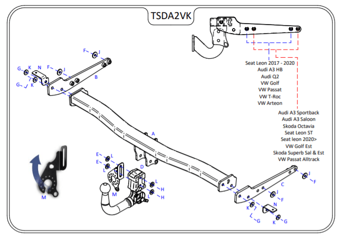

- TowTrust removable tow hitch Tow bar TSDA2VK-6207 (From Batch No. 42980), has been fitted to Petrol/diesel estates successfully, and Towtrust believe should fit Estate Hybrid.

Bobsy, I ended up getting dealer-fit TowTrust removeable towbar (think a TSDA2VK-6207) https://www.tow-trust.co.uk/towbars/seat/leon/TSDA2VK_6207-leon-st-est-inc-fr-not-cupra/2020>.
If you need a flange I believe you can get TSDA2, but it is fixed. https://www.tow-trust.co.uk/towbars/seat/leon/TSDA2-leon-st-est-inc-fr-not-cupra/2020>.
(If anyone has the TowTrust TSDA2VK-6207 removeable and wants to convert to a fixed flange I believe you can using part TSDA2-EXT which replaces the removeable socket and swanneck). (This was on a 21 'reg eHybrid estate.)
Fitting instructions for each.
chrome-extension://efaidnbmnnnibpcajpcglclefindmkaj/https://tow-trust.s3.amazonaws.com/instructions/TSDA2VK-6207.pdf
chrome-extension://efaidnbmnnnibpcajpcglclefindmkaj/https://tow-trust.s3.amazonaws.com/instructions/TSDA2.pdf
(*make sure the version you order fits your car, i.e. don't trust these links, they are for info only, go through TT car Towbar selector list (as things can change over time))
