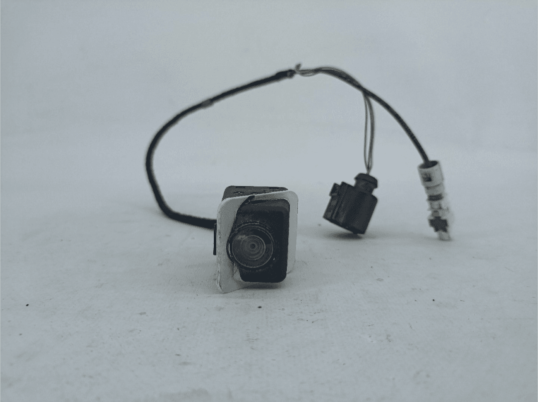

this is a genuine camera but i have no ideia how to wire it i doubt that the car already has cables coming from the radio to the rear bumper
Oh thanks i found the wire by it self for about 50 euros, a pre owned camera for 75! Way cheaper than the (oem plug and play) kit they claimed, is that it? then i just need to activate it with obd11 ?
Correct, easy as that

No, the wiring isn't present. It's a connection to the fusebox, ground and a reverse feed. Then just the video to the infotainment system
It's easy to make yourself, or you could use something like this https://www.carsystems.eu/new-seat-...-kit-with-guidance-lines-retrofit,id2133.html
I've bought and fitted this camera a few weeks back. I can confirm it's good value for the money, easy installation - just connect to ground, reverse light, +12V and 2x video wires. (+12V and video connect to quad lock (radio) connector. Wiring harness has waterproof connector, everything is well made. I didn't choose AliExpress one because connectors were not waterproof, so I didn't want to risk it that camera will stop working after a while. So the link is a reliable source with excellent support if needed ?
