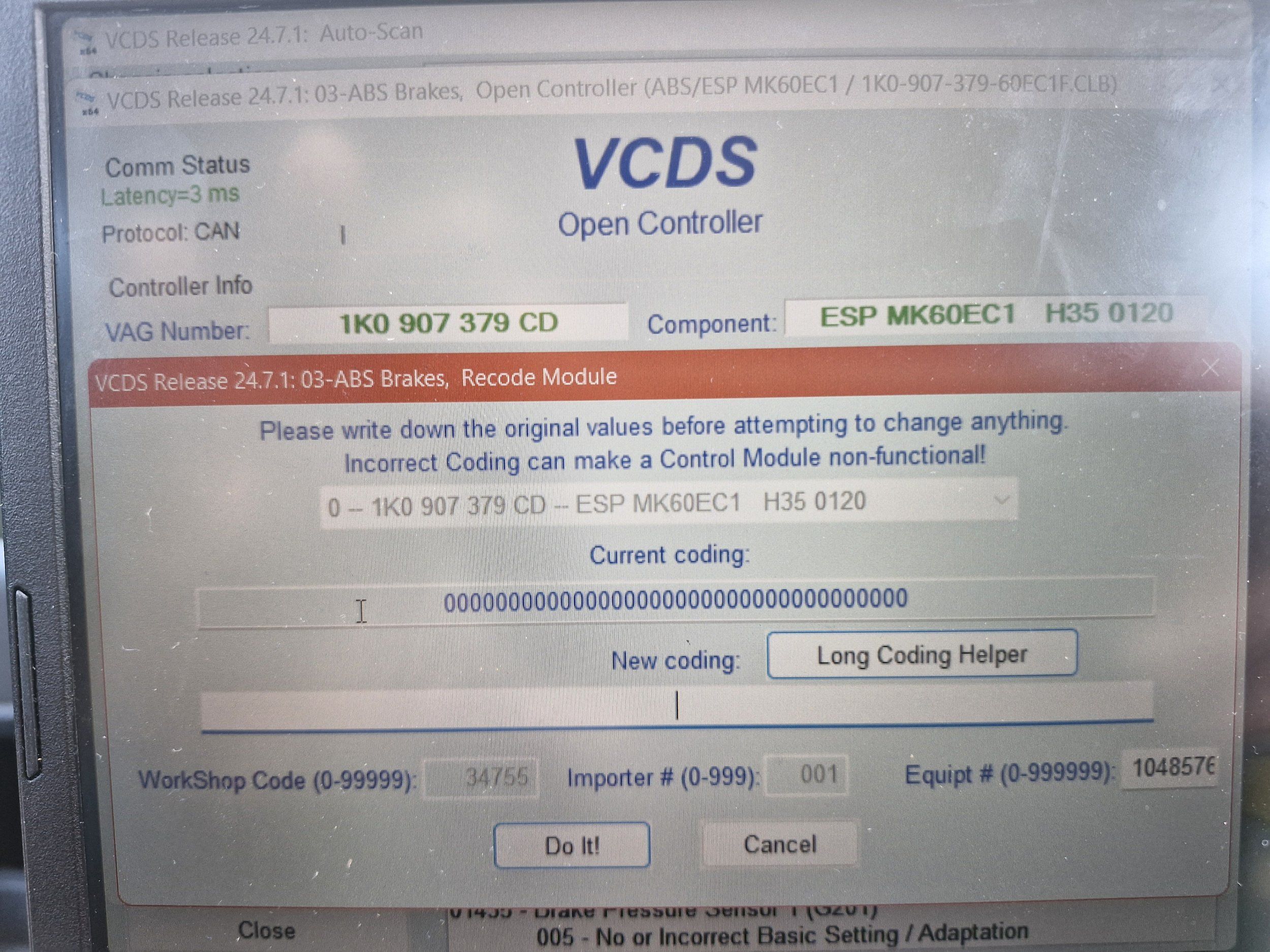

Caution; I have converted several PQ speedometers. As soon as the ignition is activated, you're in trouble with the new, foreign speedometer. The chassis number in the ABS and speedometer no longer match and the ABS throws away all its data. In extreme situations, the ABS coding is set to 0. Of course, you can reinstall the original one, then the immobilizer will be activated, but the ABS will still have no basic settings, etc. If you want to use the new speedometer, you must convert it directly in the workshop; the immobilizer can only be programmed online using VW's servers. It can of course be done without it, but only with EEPROM tools, etc. You must have all the keys with you.

jnow you don't have it easy. don't you have a backup of the past? an auto scan? because the ABS coding partly contains the equipment as well as the chassis number etc. otherwise please tell me your chassis number

1K0 907 379 CD is my VAG number.
