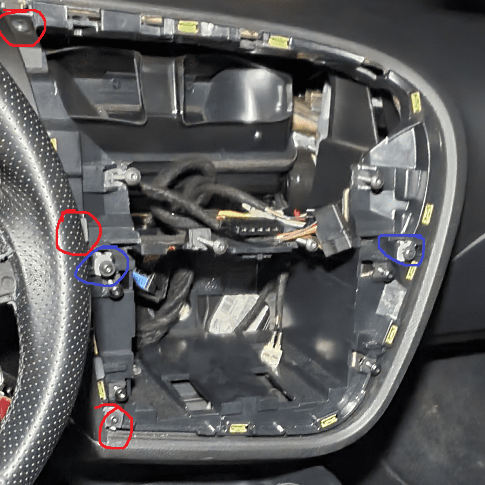

Maybe I am a bit late to the party, but I can sort of help on how to remove the entire thing, did the same thing on my FL from 2010
For me, I removed the plastic trim around the radio, which covered 2 screws for the AC trim. Then removed the AC cover which covered screws for the speedometer trim.
Unscrew the 3-ish screws which hold down the speedo trim, then unclip that trim and remove the 4 screws which hold down the speedometer.
Pull the speedo out unplug it and you are done.
Most things are only clipped, except the fews screws I mentioned
Should look something like this:
