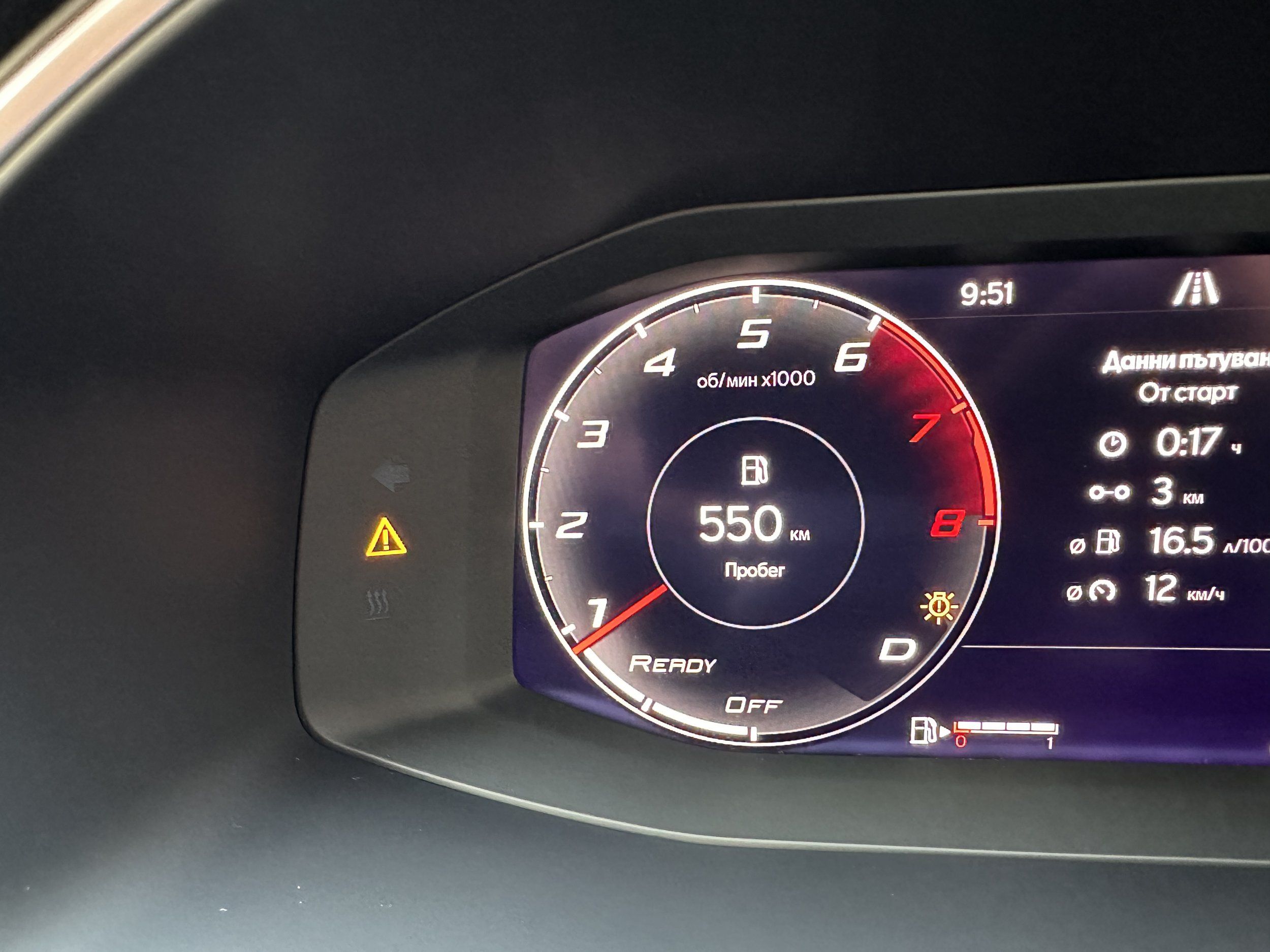

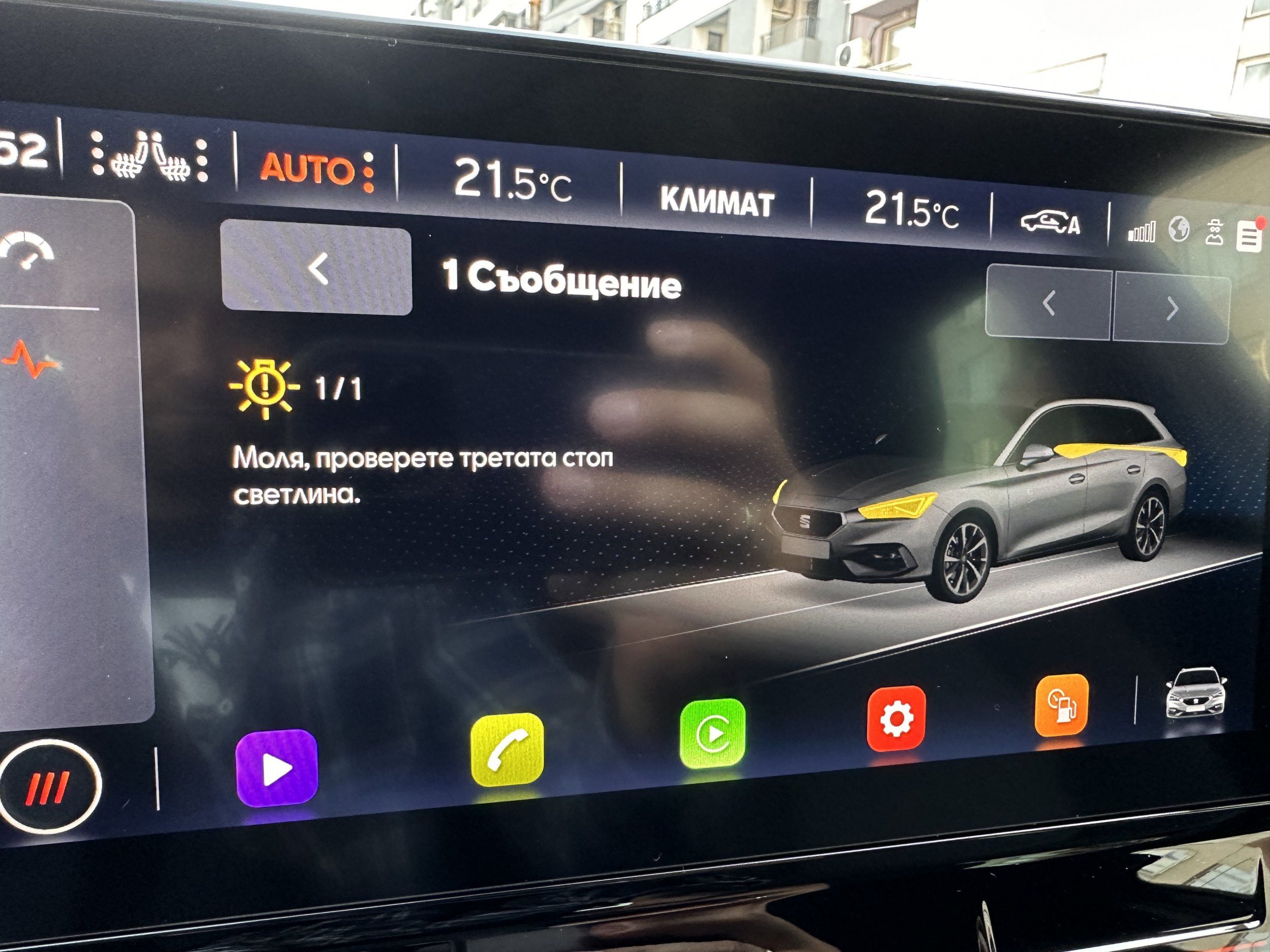

Error message says 3rd stop light error. Start stop solved.
Previous time was rear turn lights.
Randomly have not working toof panel. :)
Car - 23MY and driving from July...

Sorry, I wrote in Turkish above. the left rear signal lamp in my vehicle malfunctioned. The signal sound started to beat faster and when I looked at the rear lights, I saw that there was a problem with the signal synchronization on the trunk lid. I checked the sockets but the error was not resolved. Do you have any information about the problem?
