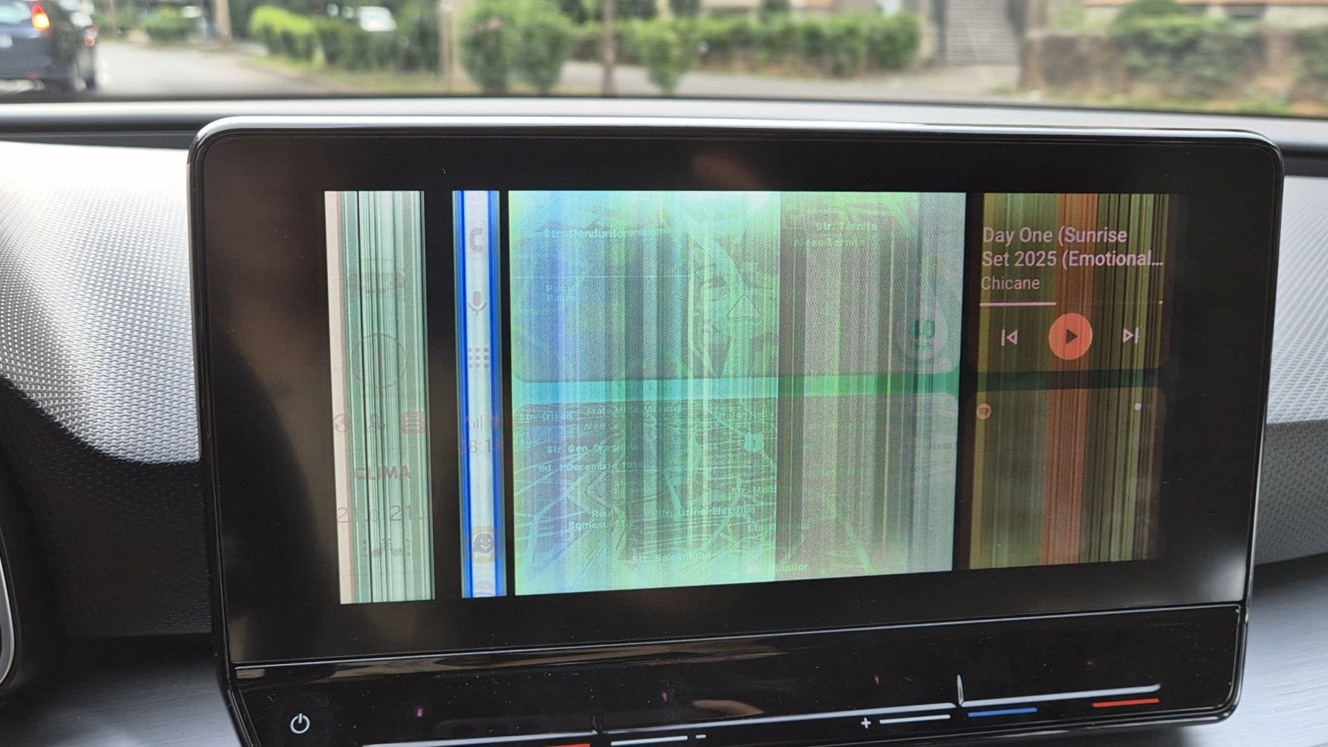

Hi everyone,
I have a Seat Leon MK4 from 2020 and I'm experiencing an issue with the infotainment system.
The screen shows flickering lines and is split into two, although the touchscreen functionality still works.
I went to the Seat dealership, but since the car is no longer under warranty, they only speculated it's a hardware issue and suggested replacing the entire unit, which would cost around €1000. Their assumption didn’t seem very reliable, so I’m wondering:
- Has anyone else encountered this issue?
- Did you find any alternative solution other than replacing the whole module?
Thanks in advance!

I initially presumed that I could only change a part of the hardware (like a fault sensor or something), but now the infotainment only shows the vertical lines, no more split screen, so it's getting worse day by day.

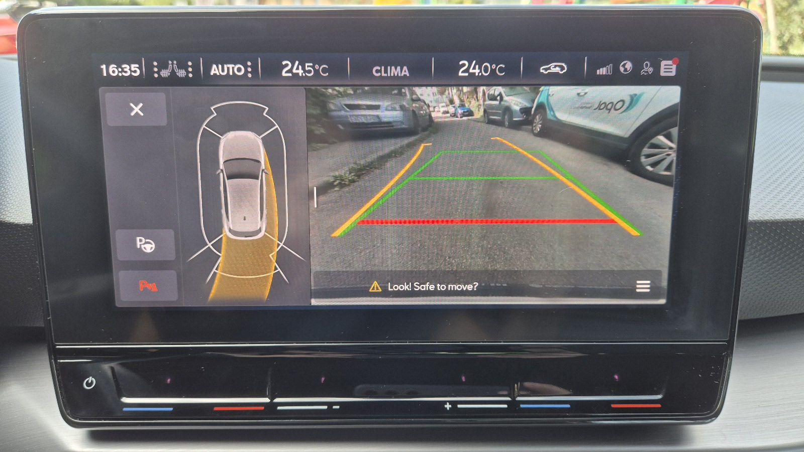

It works slightly better when I shift on reverse (it does show a shaking view of the camera), so you can imagine my confusion with regard to what the issue might be ?

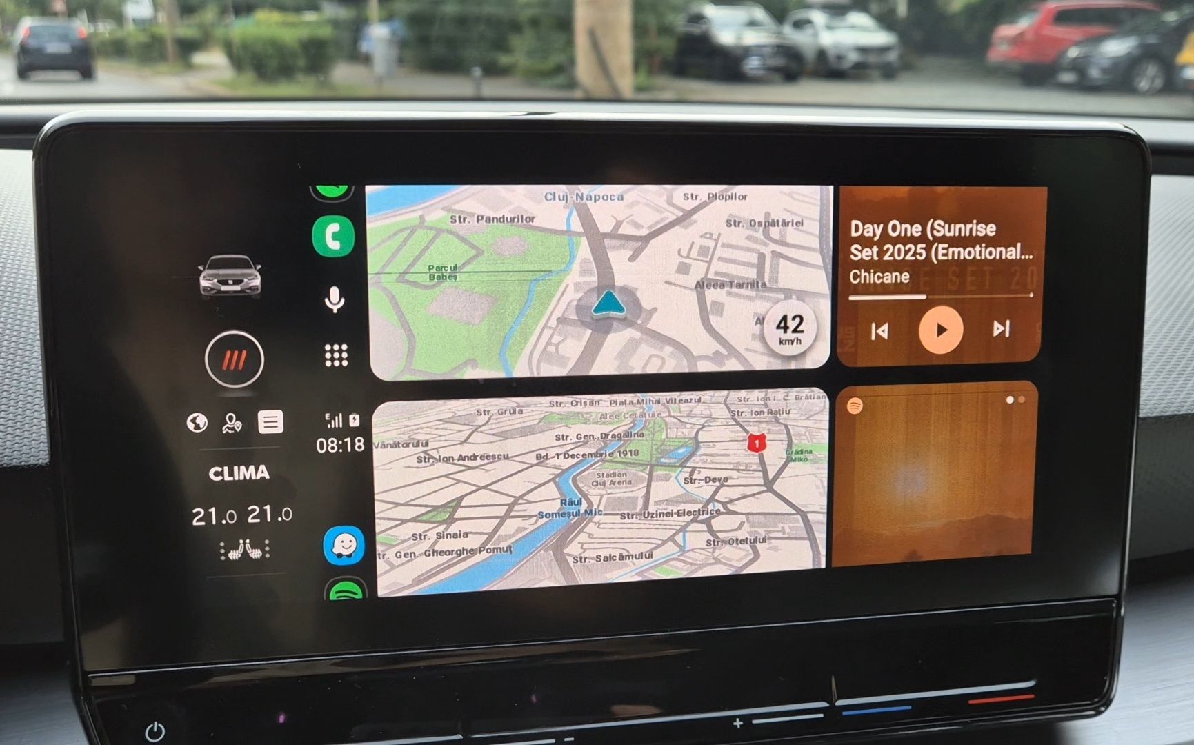

Meanwhile, guess what happened: I was notified that there is a new software release - version 1988, I downloaded it (a big file around 1,9 GB), installed it and, amazingly, now the infotainment works! ? I am astonished.
It seems that only 2 things remained "unsolved":
1. It does show some very very fine vertical red and green lines (see picture attached) but it doesn't "tremble" anymore, so I can totally live with that.
2. I still get the error of not "reading" road signs and it localises the car at around 15 km from where I am at.
So, for anyone facing a similar issue - there is hope in a software update ?
