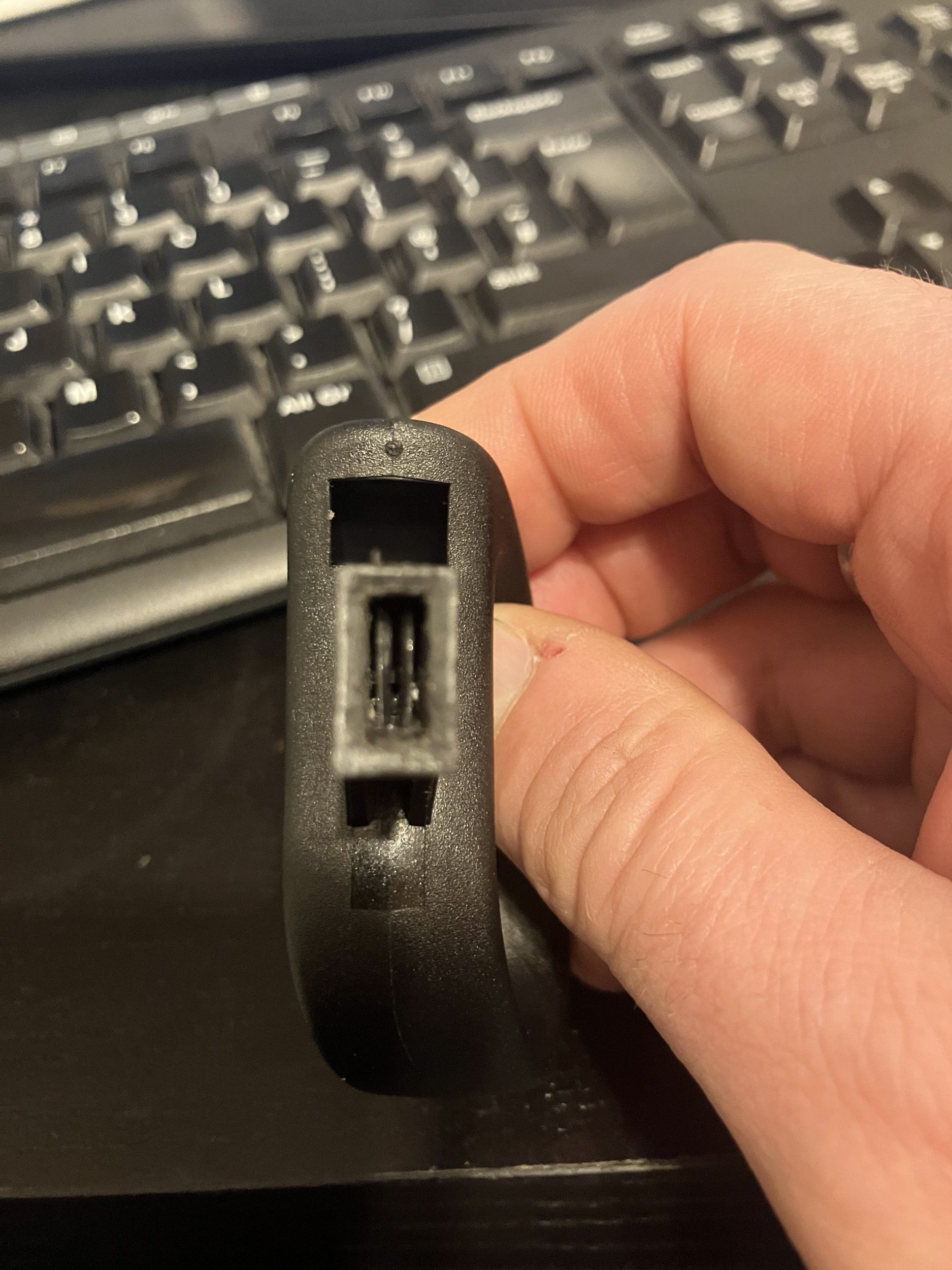

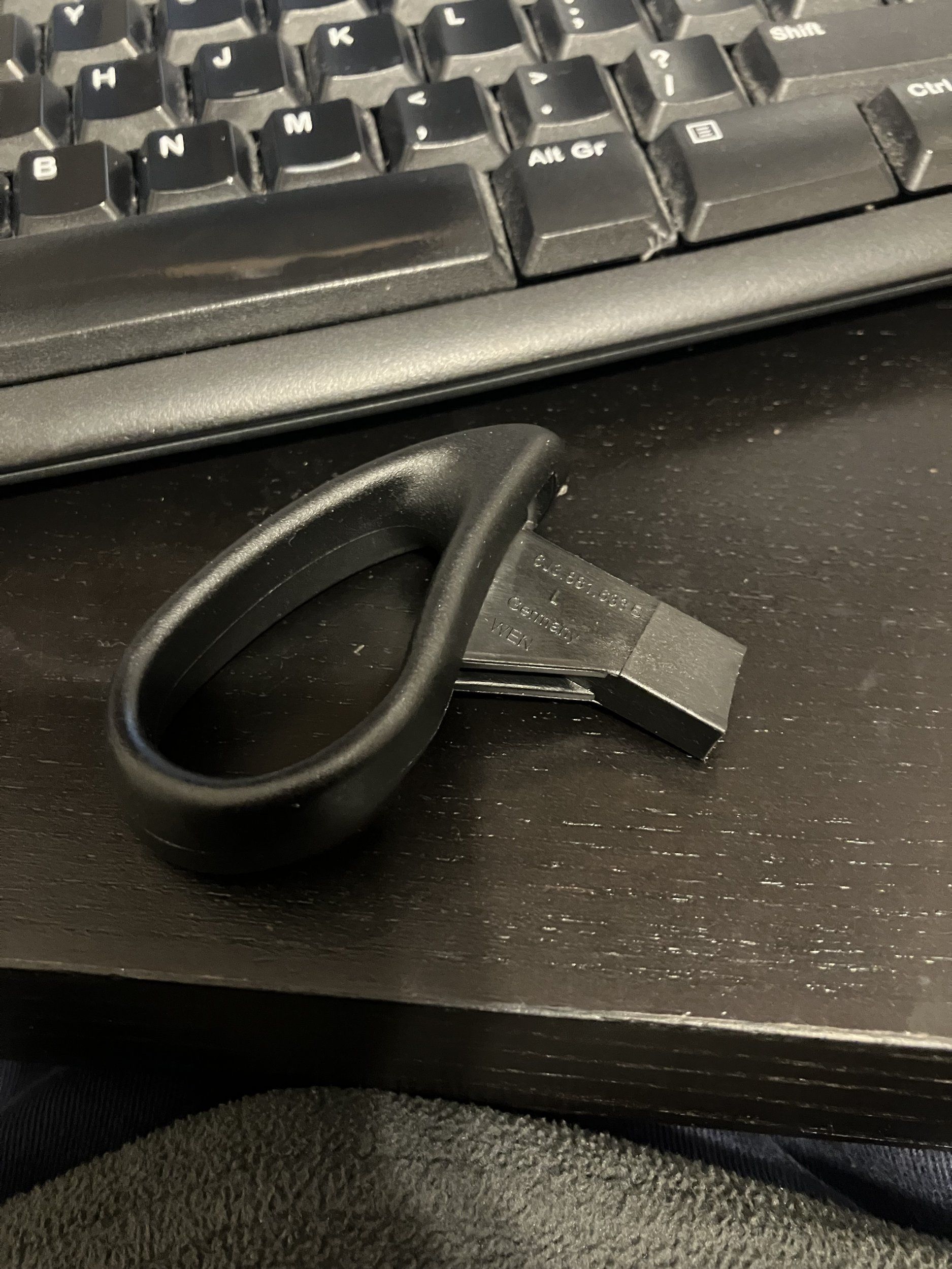

My son's 2012 Ibiza passenger side tilt handle came off, I have bought a replacement but can't seem to fit it! It looks like it should be easy which is making it more frustrating!
I put the clip in the hanle and pushed but it hasn't "locked" and the clip is now buried inside the handle (see picture)
I think the previous owner may have glued handle so potentially there's remnants of that which is stopping the new one fitting and caused the clip to "lock"? Or am I being really stupid??
Pictures attached of handle including looking down it to the clip.
Thanks
Paul.

Yeah don’t do it the way I did it!! You need to buy a clip from a Seat dealer (should be £1 ish ) then push it onto the metal bit in the seat, and push the handle into that. Don’t put the clip in the handle first.
ours didn’t work well until I realised the previous owner had tried to glue it and I scraped all the glue out! Don’t glue it - it’s meant to come off to repair seats etc
