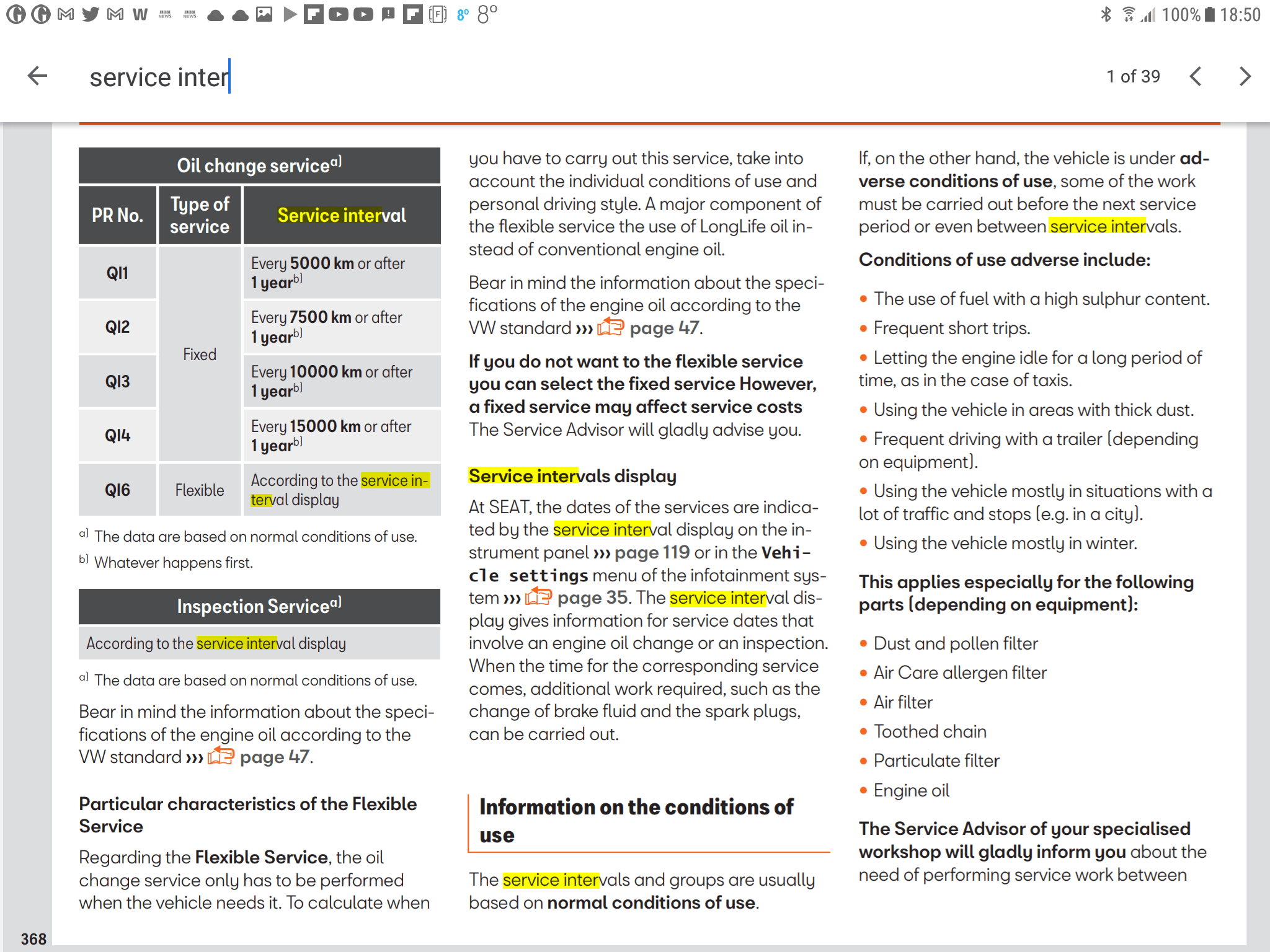

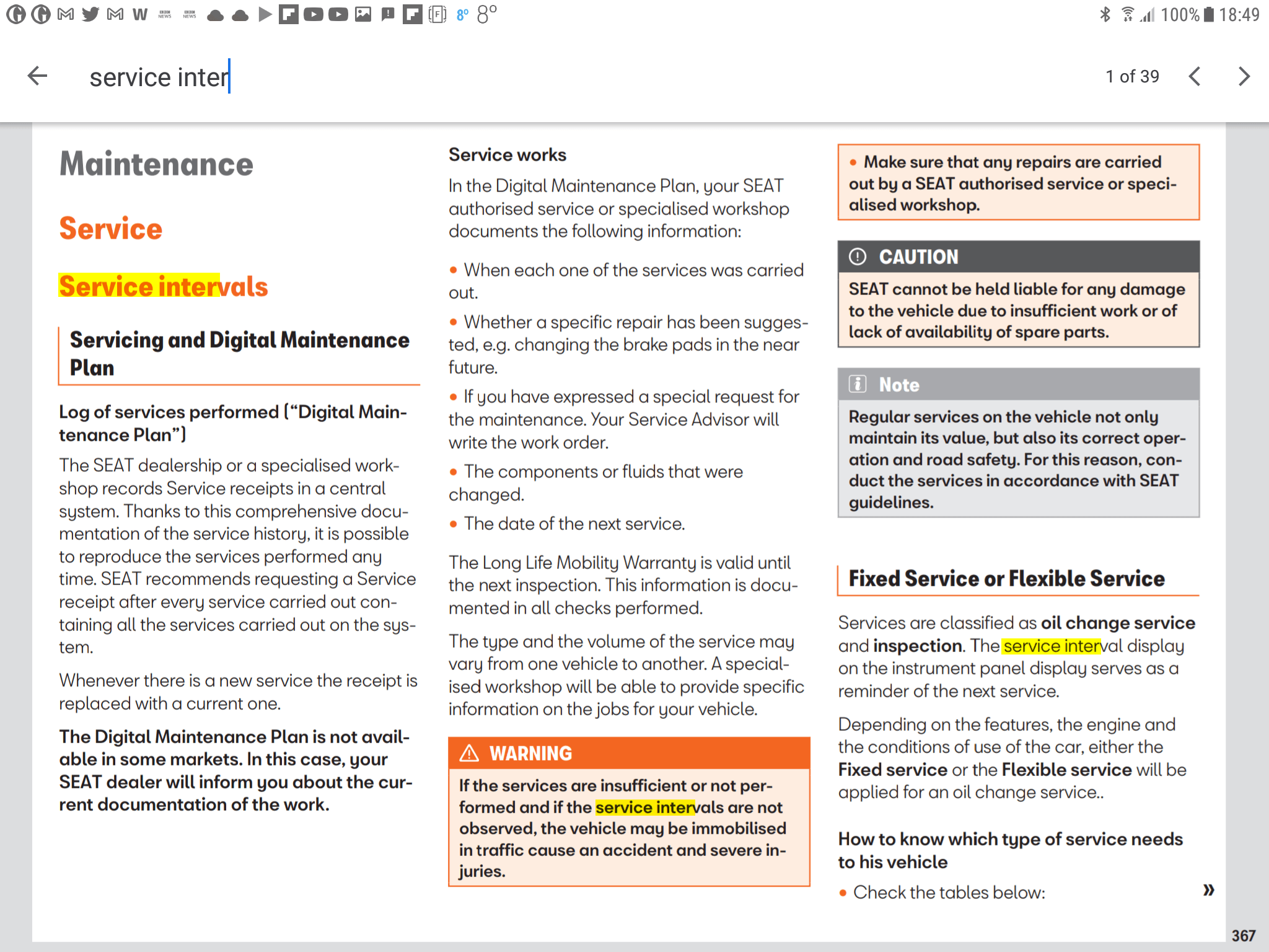

Pages from the pre 2020 Ateca manual on the subject.
