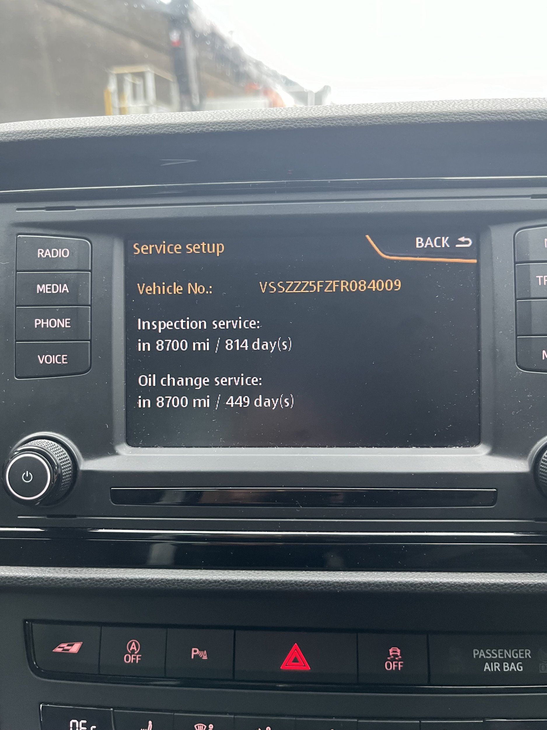

Hi all. Anyone know how to set this up so it actually works? I’ll be doing my own oil changes, filters, sparks, DSG etc. So would like to set my own intervals. Anyone know how to do this? I have OBD11 but not able to code, only use apps. Thanks.
I was able to change mine from the long life 20k to 10k using Carista. You can also reset the service alerts when you do your DIY service. I'm not sure about changing the intervals to anything other than the stock 10/20k.
