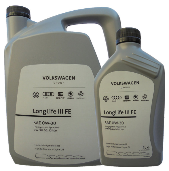

[QUOTE="Invertigo, post: 4924720, member: 122987"however there is no 'Longlife 3 0w30'. LL3 is 5w30 and LL2 is 0w30.[/QUOTE]
That is what was shown on the invoice. Did find this pic, so maybe they used this oil, or it was a typo on the invoice.
