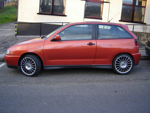

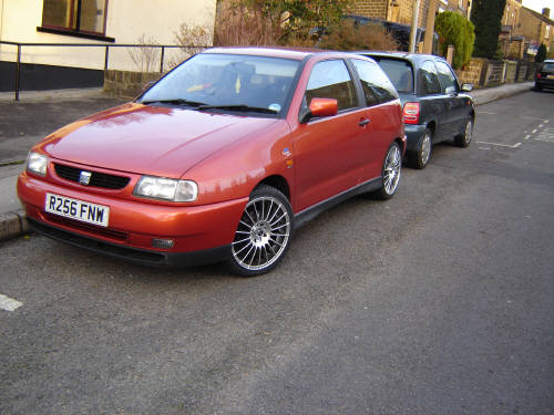

dropped 40 front and back on eibach springs, lowered perfectly but was a little crashy over bumpy surfaces. the first pic was shortly after having them fitted, the second was a month or so later after they had been run in.

unless you get rear adjustables the rears when on an equal front/rear drop will look higher due to less weight on the rear, once you are in the car it should look fine.
