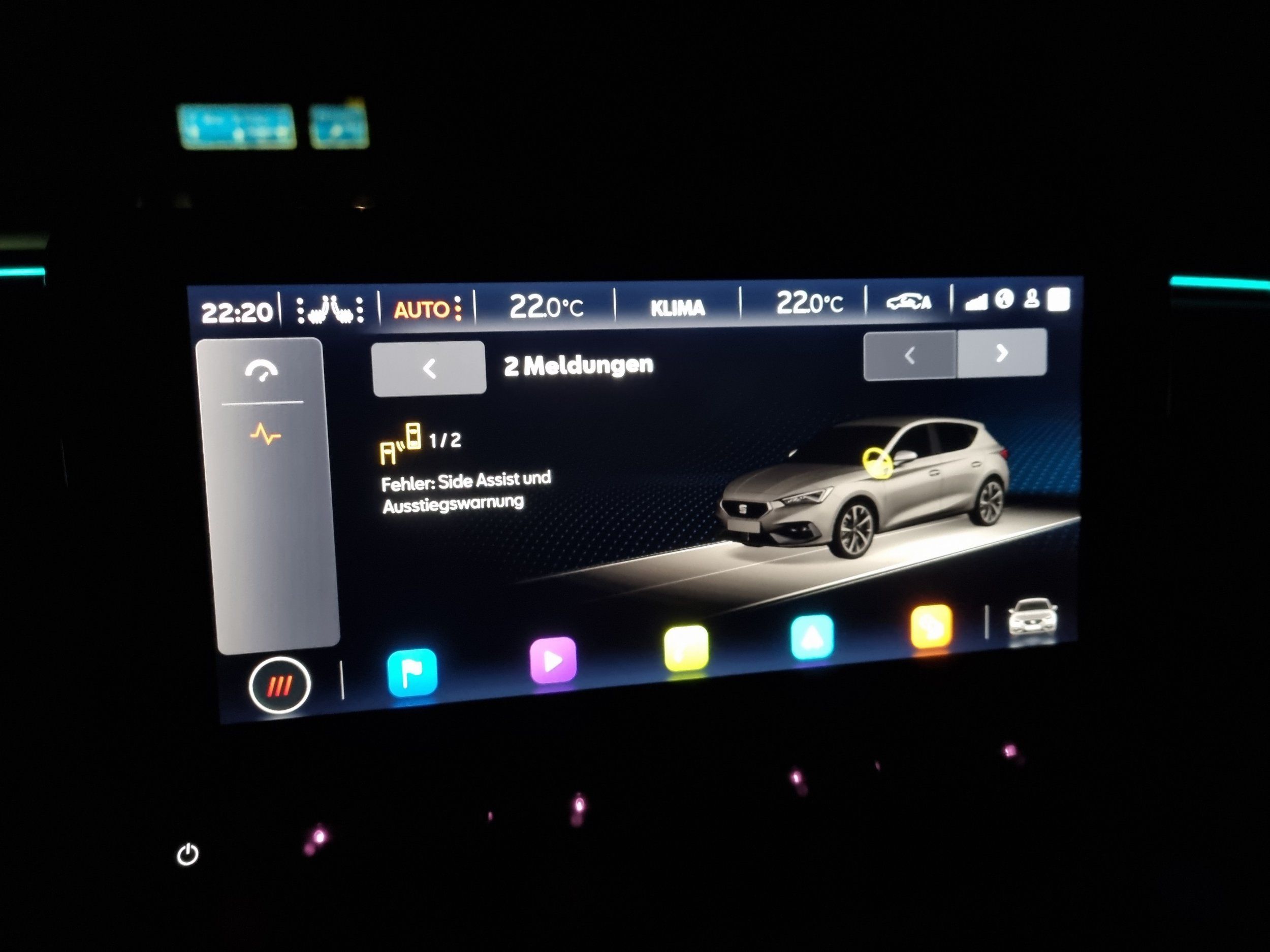

Since I got the MK4 in 2021 I get Side assist error (in colder seasons) on first engine start.
I don't have error code right now but it reads like "Short circuit to + in mirror LED".
When I stop/start engine it immediately works without any issues.

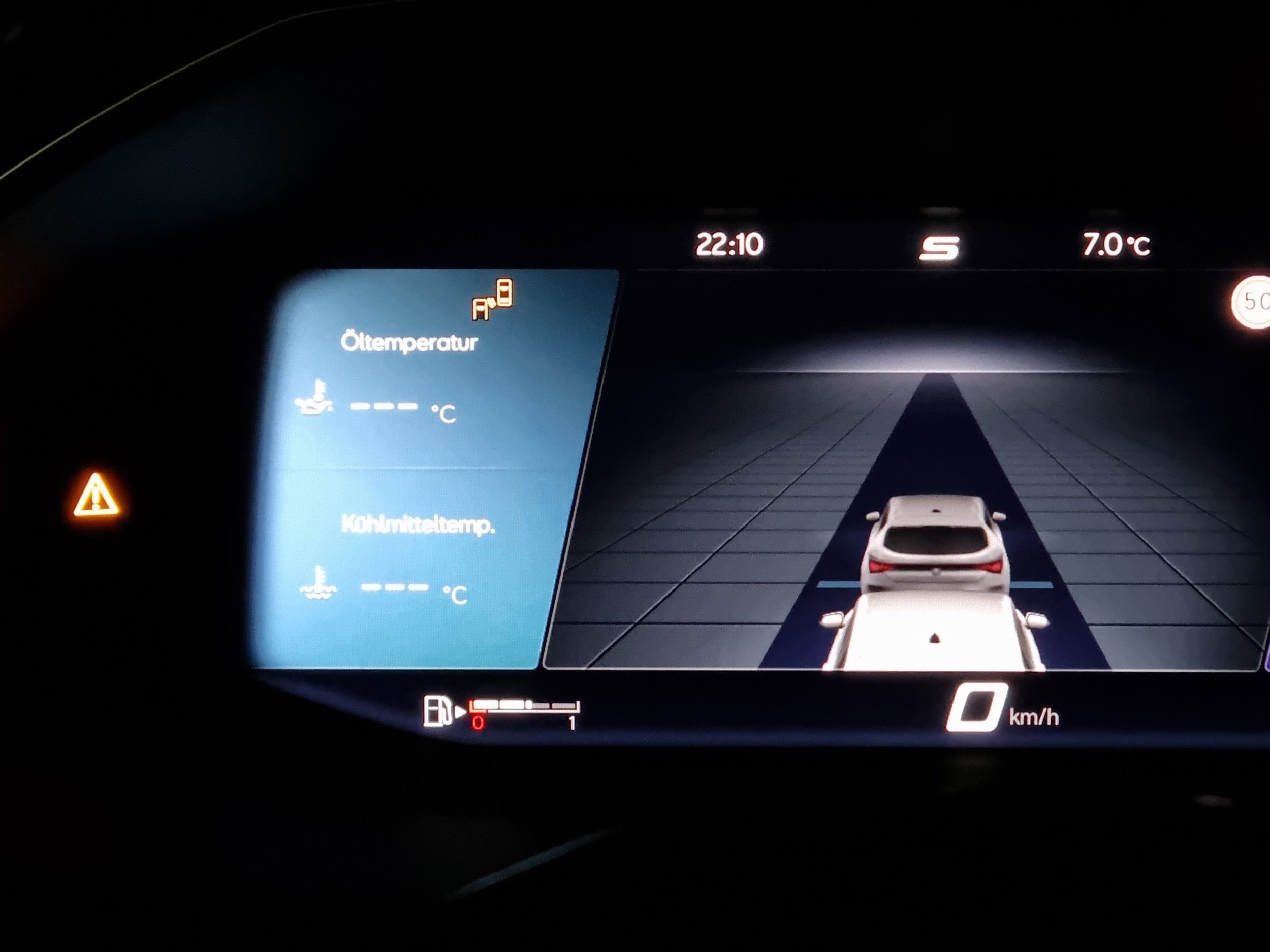

Do you also get the error message in the cockpit when starting?
Yes, cockpit message, yellow light, infotainment (car status)
Cannot be activated manually again in the problematic startup cycle
