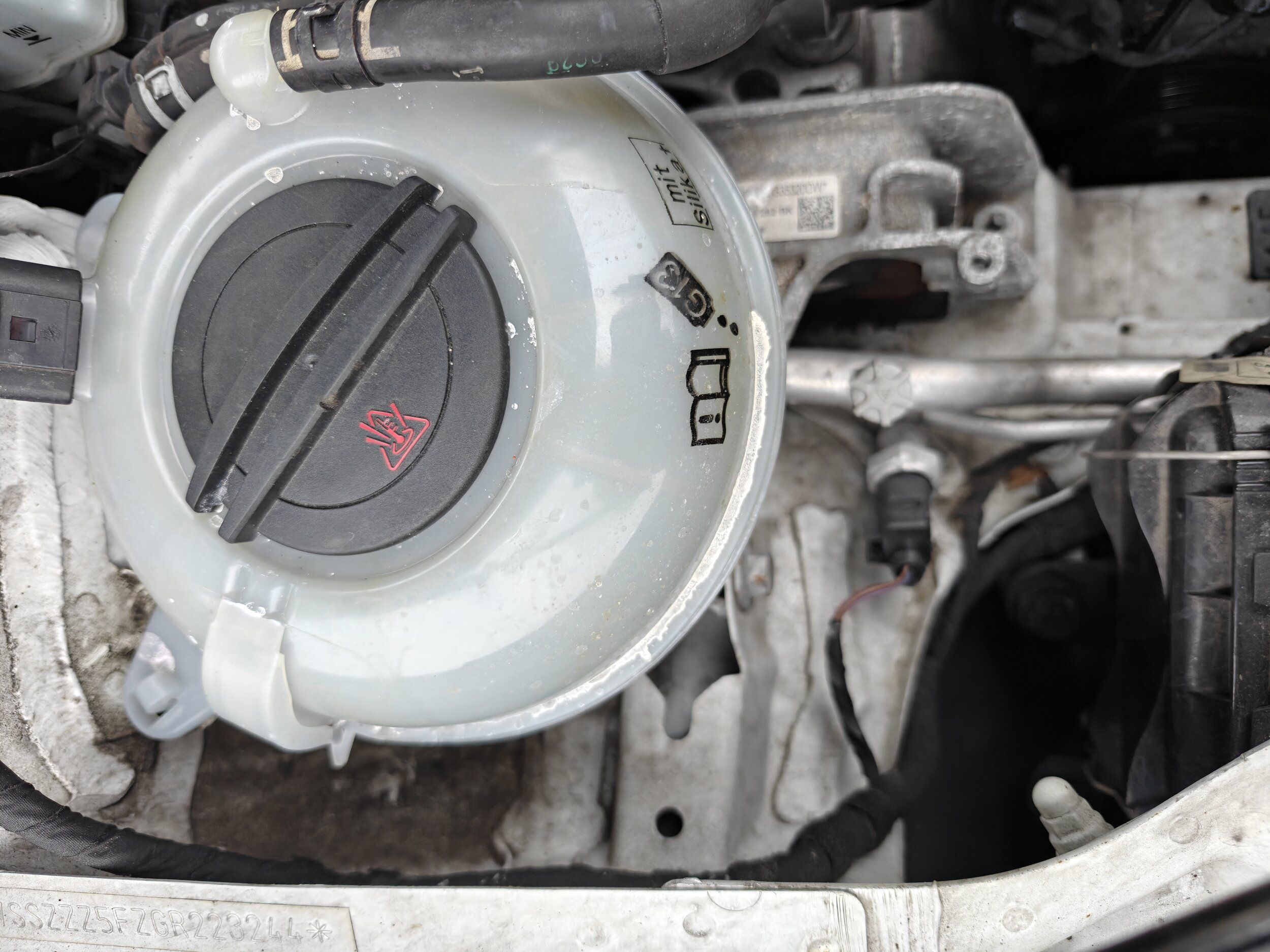

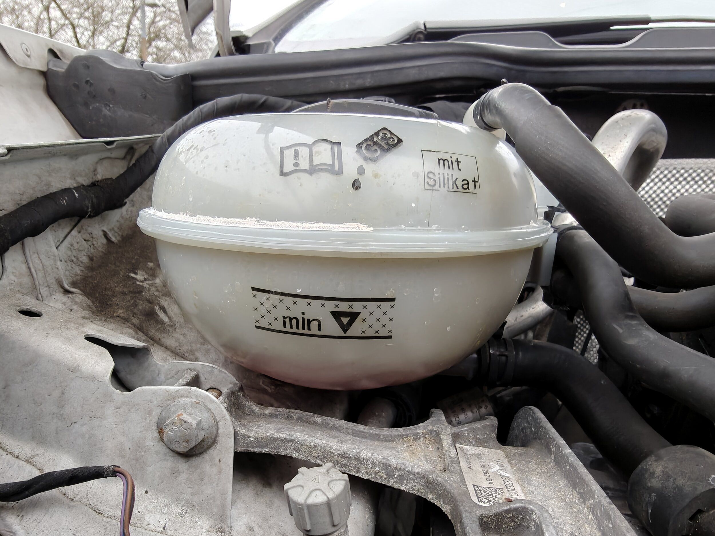

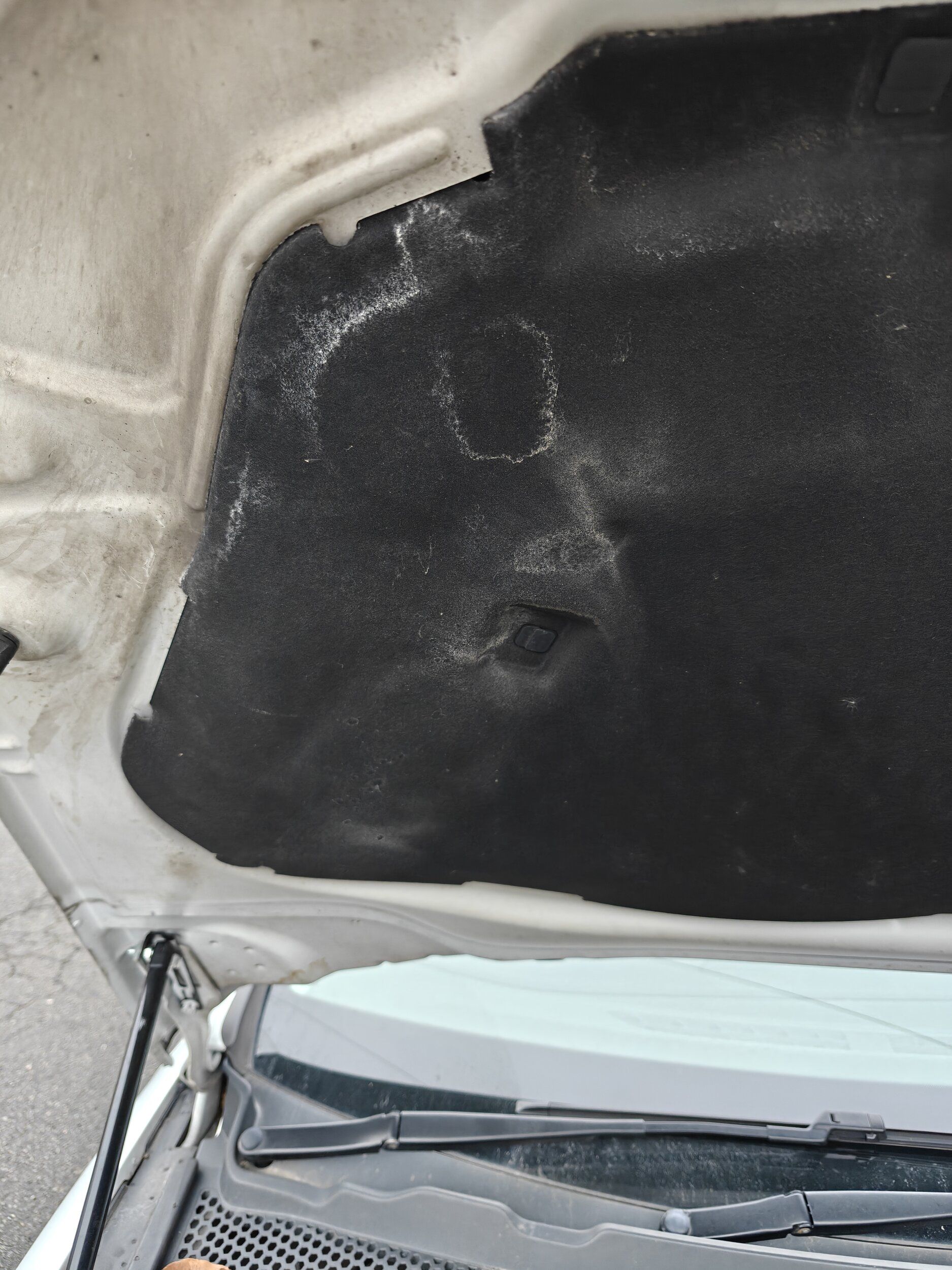

I've got the same car but DSG. I've been having the same issue on and off untill today when driving home the dash though a warning for loss of coolant, Temps where fine in the 90/95c range so no over heating. I've pulled over and checked coolant and it's gone below the minimum but still has some in. But there is coolant stains on around the tank and on the bonnet sound deadening.
I've scanned for codes with ODB11 and it's thrown up B109515, for the right AC blower Flaps, and some Googling has brought up its link to loosing coolant into the harness causing a fault.
I've previously replaced the expansion tank, for one with a solid silica block not a bag, and the cap thinking it's the issue. I've also had the cabin fan blower motor replaced in December. I thought it was unrelated but it might be.
I've also replaced the coolant nipple for the billet 034Motor sports under the turbo at the back of the block. As that had failed.
Sinse I've had this issue over the last 18 months, I've used about 5L of coolant.
I also get that same beeping noise once the engine is off but assumed it's normal.
I'm going to ring around to some VWAG Specialist near me and see what they think.

Could be a clogged heatermatrix?
Else: Is the waterpump and/or thermostat working correctly?
I'm assuming the water pump and thermostat are working fine. It's getting up to 90°c and doesn't go much higher than 95°c.
I Do get that electric beeping noise once the car is off after it's up at temp, but have never been able to fine out if that's a good thing or bad.
I'm heading in the idea of heater matrix being blocked, but I'm not sure how the heater matrix could have been blocked as I removed the Silica bag last summer and it looked intact. I eventually replaced the header tank with a different one with a solid silica block about 3/4 months back along with new cap as they looked to going.

I've got an update on my coolant loss issue, while looking at the engine the other day at start up I noticed steam coming from the back of the engine/turbo but only for a few mins at start up, it would go away after everything got hot.
So I've had it at a garage to see if they can fight it out. Turns out that it was the water pump/cover. Was visible slow leak on could be seen when the under tray was taken off. So those have been replaced. Hopefully that's issue sorted. Not had any chance to take it for a long drive yet, but fingers crossed I don't loose anymore coolant.
