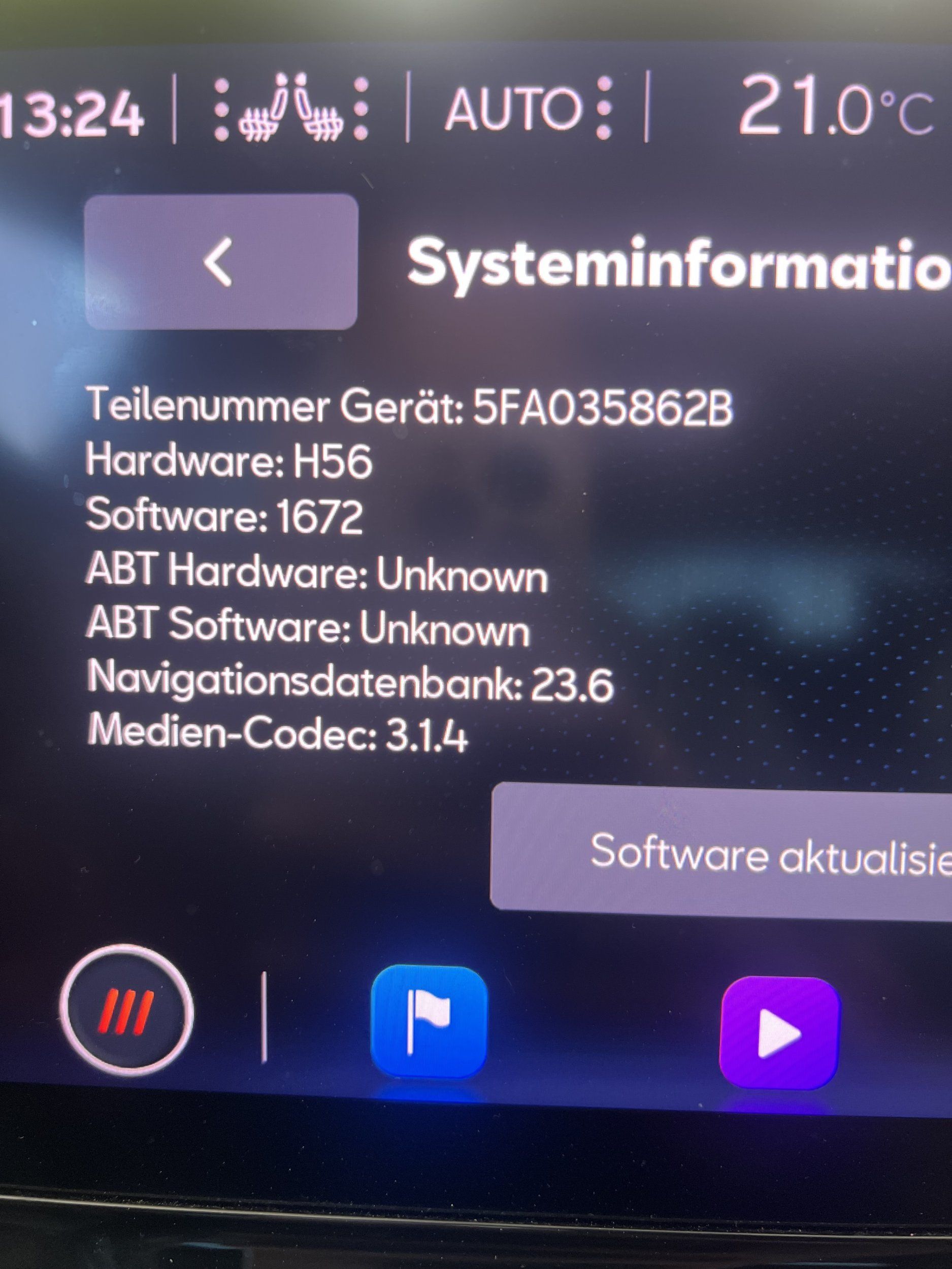

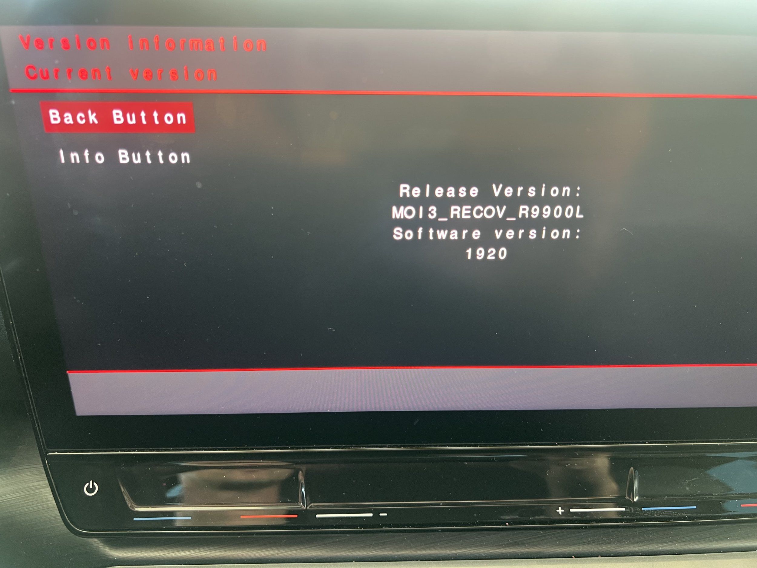

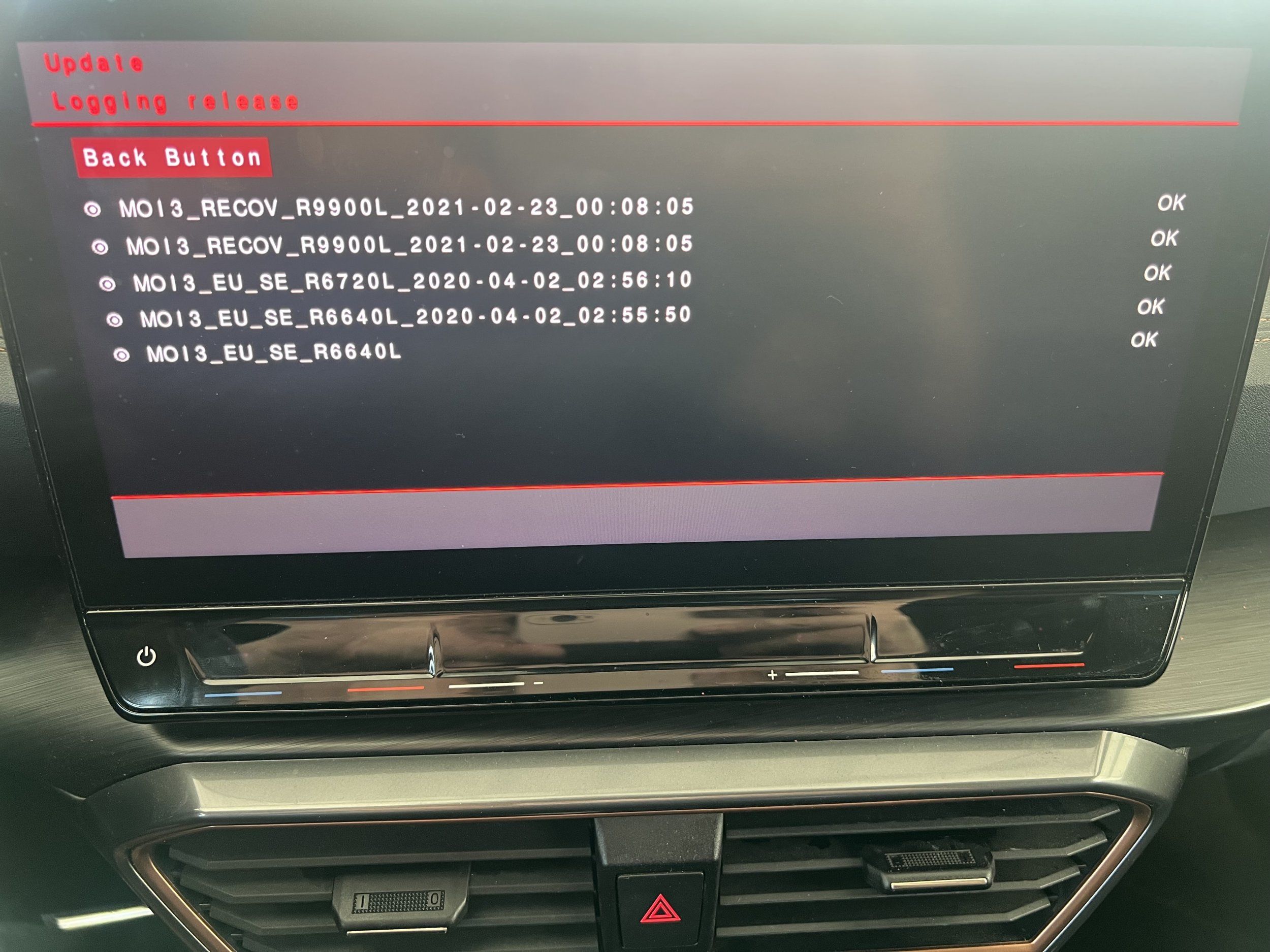

It feels like the entertainment display restarts every few minutes and occasionally doesn't switch on at all. In rare cases, it doesn't actually switch off at all and runs as normal. I just opened the service menu and there was no restart at first. I am attaching a few pictures of the software status. I could imagine that a newer software could solve the problems without buying a new expensive part. The question now is, how can I solve the problem myself with suitable software and, if possible, instructions. Many thanks in advance.

If the dealer are saying they can't reload the software due to a corrupt module theres no real way you can reload the software yourself either. That is an out of date version, but the issue is likely if the module wont stay running long enough it wont be possible to update it.
Beginner's mistake... you have to go from firmware 16XX to firmware 17XX then to firmware 18XX and then firmware 19XX... you're lucky the module isn't junk.
Yes, I can understand your approach, but if the controller seems to be defective, I can try my luck on my own. Do you have any idea what software I can use?
Do you mean that the dealership screwed up and these errors may have been caused by incorrect updating? How can I solve the problem, do you have any ideas? Which software would be right at this moment?
The problem is that I am not in Germany at the moment and the VAG workshops here in Turkey leave a lot to be desired in terms of quality.
