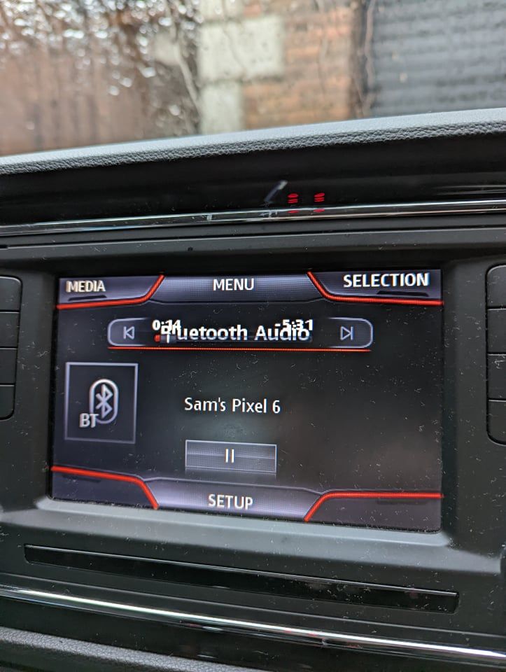

Hi Mate,
Have you had any luck fixing this? I've got a 14 plate Leon and been running into the same issue the last few weeks. Streaming songs from Spotify on Google Pixel 6 usually, but just tested it with YouTube and same thing happening. Music will play ok but cannot use any of the controls on touch screen and the next/back buttons on steering wheel not working either, however they both work fine when listening to radio.
