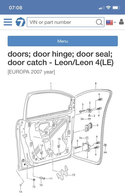

Back to the differences between the mk5 Golf and mk2 Leon doors; screenshots of the parts diagrams of the front doors of both a 2007 Golf and Leon show the differences and you can see the mk5 Golf’s separate door skin - item no1 on the diagram. From the diagrams, it looks as if the Golf also had an additional door seal (item no27) attached to the actual door that isn’t shown on Leon diagram - the Leon looks to just have a seal around the door opening on the car bodyshell. The additional seal would certainly have an impact of the door sound when closing it.
I’ve also provided links to the diagrams below.
2007 Mk2 Leon front door parts diagram; https://seat.7zap.com/en/e/leon+leon+4/le/2007-456/8/831-831000/
2007 Mk5 Golf front door parts diagram; https://volkswagen.7zap.com/en/rdw/golf+variant+4motion/golf/2007-474/8/831-831010/
